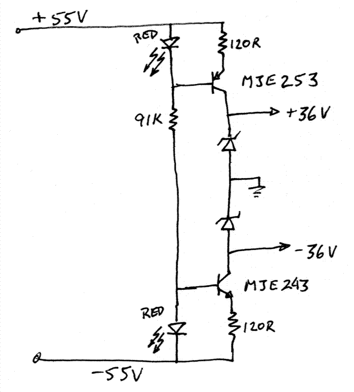

Hi pothound,
You will be replacing the 470 R resistor with a current source. This all goes on an outboard assy.
Look up LED biased current sources. That is basically the plan here. Use an MJE243 / MJE253 or anything else with a gain over 100 (at least). Select for the highest gain within reason. A red LED drops about 1.8 ~ 1.85 VDC, the junction probably around 0.65 VDC and the rest ends up across the emitter resistor. Something around 120 R 1/2W would be fine. The LED requires a couple mA to provide the reference and base current.
So, the positive rail will use a PNP transistor, the negative rail gets the NPN. The emitters point towards the rails. I used an angle bracket to mount and provide a heatsink. Insulators are used, aluminum angle brackets work well. Make them flat first. I tapped the mounting holes to the chassis, you don't have to do that.
-Chris

hi chris hi ilimzn
i'm glad your concerned about the filament supply, my board is burnt around the bridge rectifier. the voltage is lower than normal, maybe the new caps will fix this.
after reading your posts, i'll try a .47 at the first cap and a .33? at the second cap.
chris i hope i'm on the same channel with you. i will open the the supply voltages by removing the 470 ohm resistors. i have 46v+&46v-.
using the mje253 on the + side connect the 120 ohm resistor at the supply to the emitter.
connect the LED from supply to base, arrow on LED pointing to the base.
connect collector to rail to complete the circuit.
using mje243 on the - side will be the same, except LED arrow pointing to supply.
should i put small cap across LED?
i hope i'm with you.
in digikey on page 2082 i found a red LED #160-1652-nd. it is 2.0 volts. others on that page you might like better. i could not find 1.8v.
let me know what you think.

Hi pothound,
I wish I had something to show you right about now. Test it with a power supply or you can just stick it too the supply caps before you do anything (10 R resistors in series). Measure the voltages before you go any further. That way your amp will not get damaged if there was a mistake made.
-Chris
The collector goes to your zener (now moved to new circuit board). and from there returns to the main PCB where the old zener went (cathode hole for +). The negative side has all the polarities reversed. Use a resistor between the two LEDs, cathode to anode (around 68 K 1/2 W).connect collector to rail to complete the circuit.
No. Not needed.should i put small cap across LED?
Any cheap normal sized red led will work well here.in digikey on page 2082 i found a red LED #160-1652-nd. it is 2.0 volts. others on that page you might like better.

hi chris
I took the board out. it got extremely burnt on the bottom around the filament power supply bridge rectifier, also the 1 ohm resistor measures 1.4 ohms. i'm undecided about ordering a heavier duty bridge rectifier and a better heat sink.
what are your thoughts?
regarding the zener diode circuit changes, i drew it out and added it in the rail line, and it is a thru circuit without a direct ground.
i hope i'm thinking strait.
if i'm on track, i'll connect the + and - circuit of 1 channel on a circuit board with a 68k resistor between the cathode and anode of the LED's [base to base].
for test purposes only, i'll disconnect the 68k. hook the + side to my power supply. in order for the circuit to work something has to go to ground. is this where the 10 ohm resistor comes in to play? can i take the resistor across collector to ground? if this works, i'll take the voltage up to 46v and read the collector to ground.
i hope i'm doing this correctly. i feel like i'm missing something.
thanks for all your time and effort.
pothound

Hi pothound,
Would you please draw out what you are doing? I'll see if I can do teh same and post it.
-Chris
That's quite normal. That bridge is fine for specs, you can replace it as they are not expensive. A larger heatsink + the series resistor will reduce the temperature.I took the board out. it got extremely burnt on the bottom around the filament power supply bridge rectifier,
-Chris

i erased the 470 ohm resistor and put in your circuit and ran a 68k between the base of the+ and base of the -.
my concern is testing it.

Hi pothound,
Okay, see the browse button at the bottom just above where the blue ends? Click on the "browse" button. Navigate your computer hard drive and find the file you want to post. Read the valid file extensions below for allowed file names.
This is a rough guide for you .........
The component values are rough guides. I used 1 W zeners and 1/2 W resistors.
-Chris
