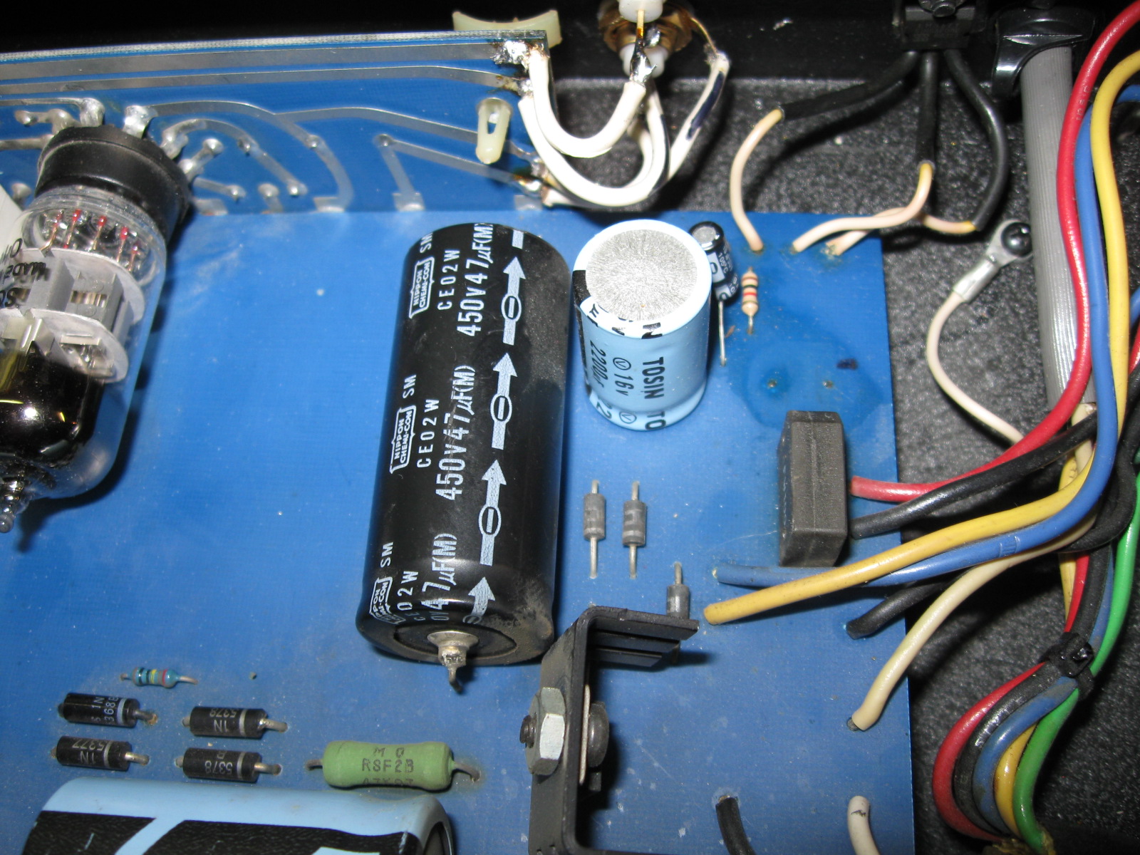

Specifically the upper right segment of the board. Guy brought in one to have a cap replaced because he didn't want to do it but the cap had already been pulled and I don't know which way the replacement needs to back in. It's the 25V-1000uF.
Can't seem to find a pic on-line anywhere!
Any help is greatly appreciated.

there are some pics in this thread (2 min in google). I would think neg goes to ground, but I know some of CP stuff is floating, so figuring that out might not be obvious 🙂

Pars - thanks! That is exactly what I needed. (I saw that thread but didn't follow it far enough along to get to the pics.

Well - that, to me, sounds like a good idea. I'm going to get this one up and running first and if the owner wants to start some tweaking (and he's already talking that way) then I'll revisit this idea with him.

here's a pic - the one I forgot to add last night
