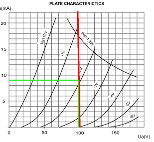

I did get confused with the RED line that is drawn in plate curves graph???? The lower cascode "idealy" sees no load on top and should be "locked in" at a set plate voltage ..so there should be no signal movement at the plate of the lower valve...therefore the movement should be strictly VERTICAL on the graph, behaving in accordance to gm....you can see the spacing is horrible when moving VERTICALLY with this triode, worse than a pentode...this radical delta in gm will fuel harmonics ...which is great for guitar.... As we all know , in real life there is a finite impedence looking into the top triode from the bottom triode's perspective... thats why I use an active negative feedback from that node to the upper triode grid.... This effectively lowers the looking in impedance of the upper triode..and now you approach ideal Gain.... A lot of trouble for little more improvement....

Yeah, I did ask elsewhere on this forum about plotting a line for the bottom tube when I realized that it should start around 300mA for the circuit I used... almost a ******** straight line. CRAP!!! You are right...I forgot to change that paragraph, good call.

Tell me, is this chart a better representation of the operating point:

As long as the cathode resistor is bypassed..then the RED line is the slope representing 1/gm of the top valve.....

cerrem said:As long as the cathode resistor is bypassed..then the RED line is the slope representing 1/gm of the top valve.....

1/gm for the slope eh? I guess for a rule of thumb, I could use a straight line since 1/12,500 is off the chart anyway.
