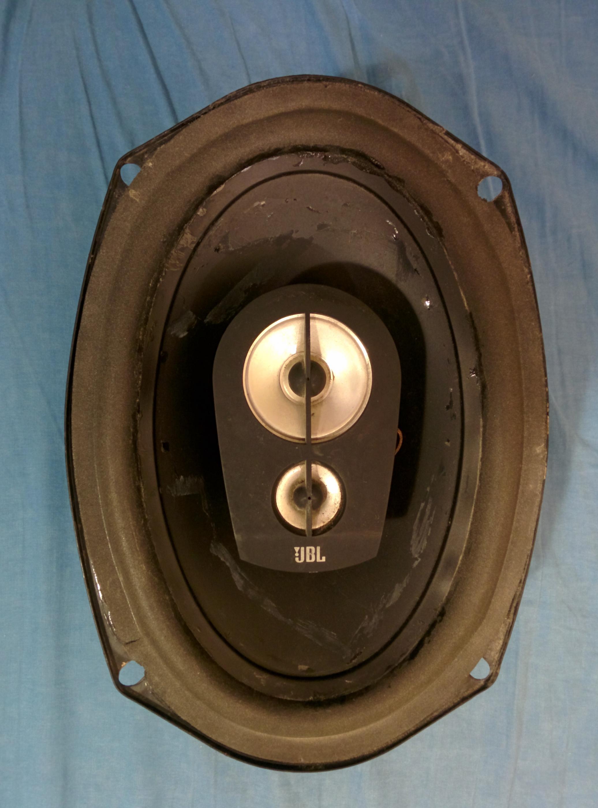

I had this JBL speaker laying around for a long time. Recently I decided to give it a new use. I do not have much 'know how' with speakers and electronics but, here's my project:
I want to create a mono, amplified speaker that I would be able to use by plugging in a normal 3.5 aux stereo cable, from a smartphone or a laptop for example.

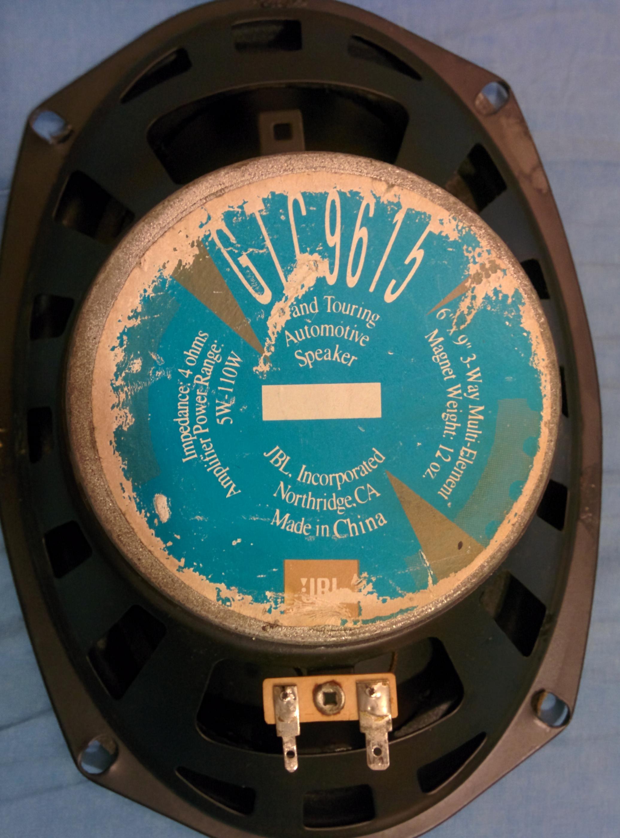

The speaker (pictures attached) is a pretty old 3 way JBL, 4 Ohm, 5-110 Watt, model GTC 9615. (Do you think it's still usable given the poor manteinance condition?)

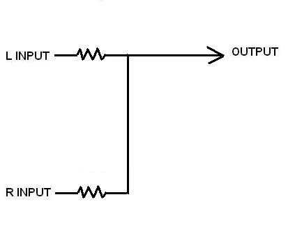

1) How can I connect a 3.5 stereo AUX to a mono RCA (merging the 2 channels)?

You will need a couple of resistors to sum the two music channels...100-500 ohms will work.

Its a bad idea. The speaker is in a very poor state
and in real life will need nothing like 60W rms.
As a 3 way with a very crude x/o it will sound grim.

The two resistors should be high enough in value that the device driving them can "ignore" the signal from the other channel.
If you just hook them together then the amplifier outputs will be fighting each other...not good.
Since typical headphones are 30-50 ohms then 100 to 200 ohm resistors in the passive combiner will work.
