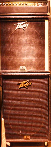

check dc volts in all outputs of ur gt6 and in all different modes of output(u should lower volumes on amps when switching devices on off even inserting jacks or changing modes on pres)but the amp dont seem to have the best behavior about protection)....is it going thru a mixer??hmmmmmmm,are u telling all the details?
Marco
guitar drums bass synths programming sequencing capturing looping blah blah blah
i use a crown power base two on a peavey 1810 black widow and a peavey tnt 130 as pre amp and mid/high amp for bi-amping the peavey 1810,,,,but all the cares with ground loops have to be checked or else even if the amp dont fail i'll have to get new speakers........
peace

Apart from the Boss pedal - what else is common to the set up when 3 different amps have been used - and shut down?
Check the speaker and the wiring to it - make sure that it is OK. If you have a meter - switch it to a low ohms range and measure across the jack plug that would be plugged into the amp(s) - with the speaker connected to the other end.
How many ohms do you read?
