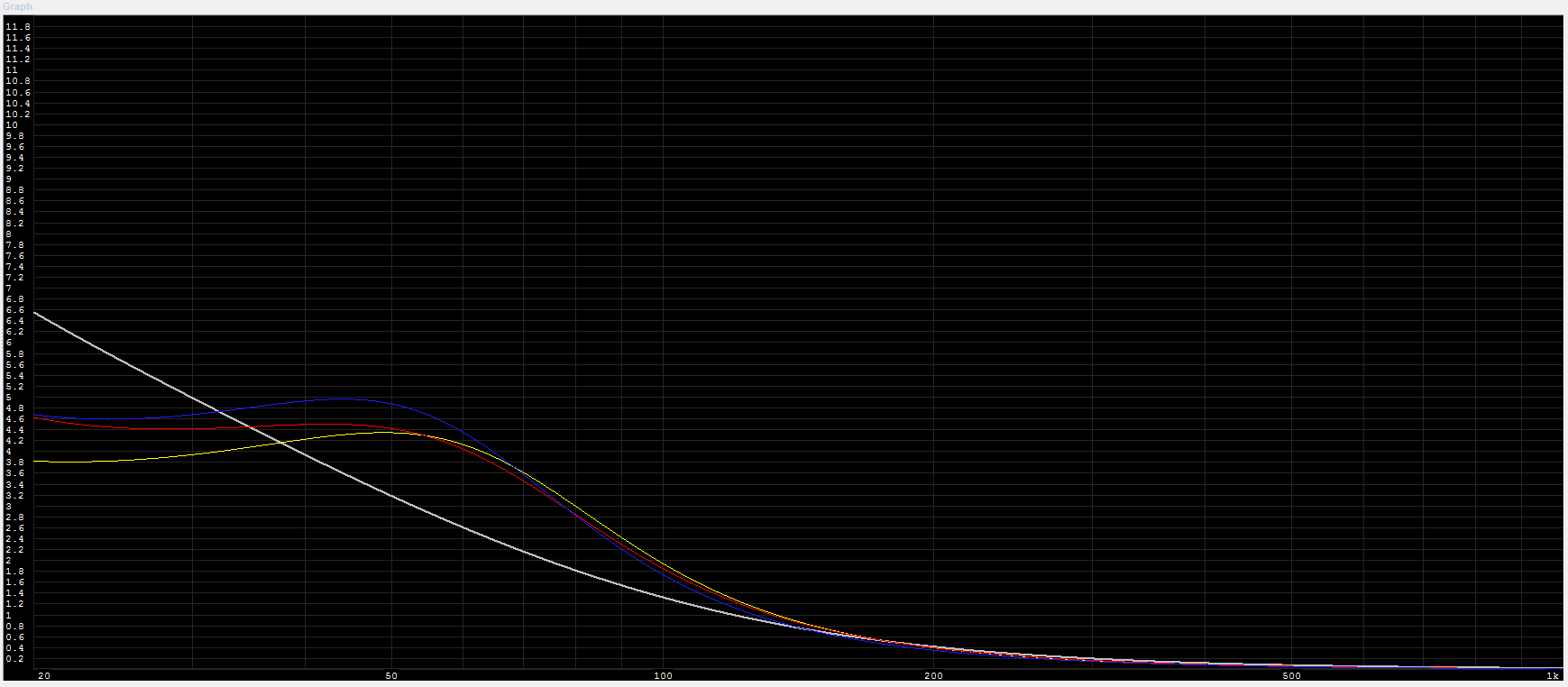

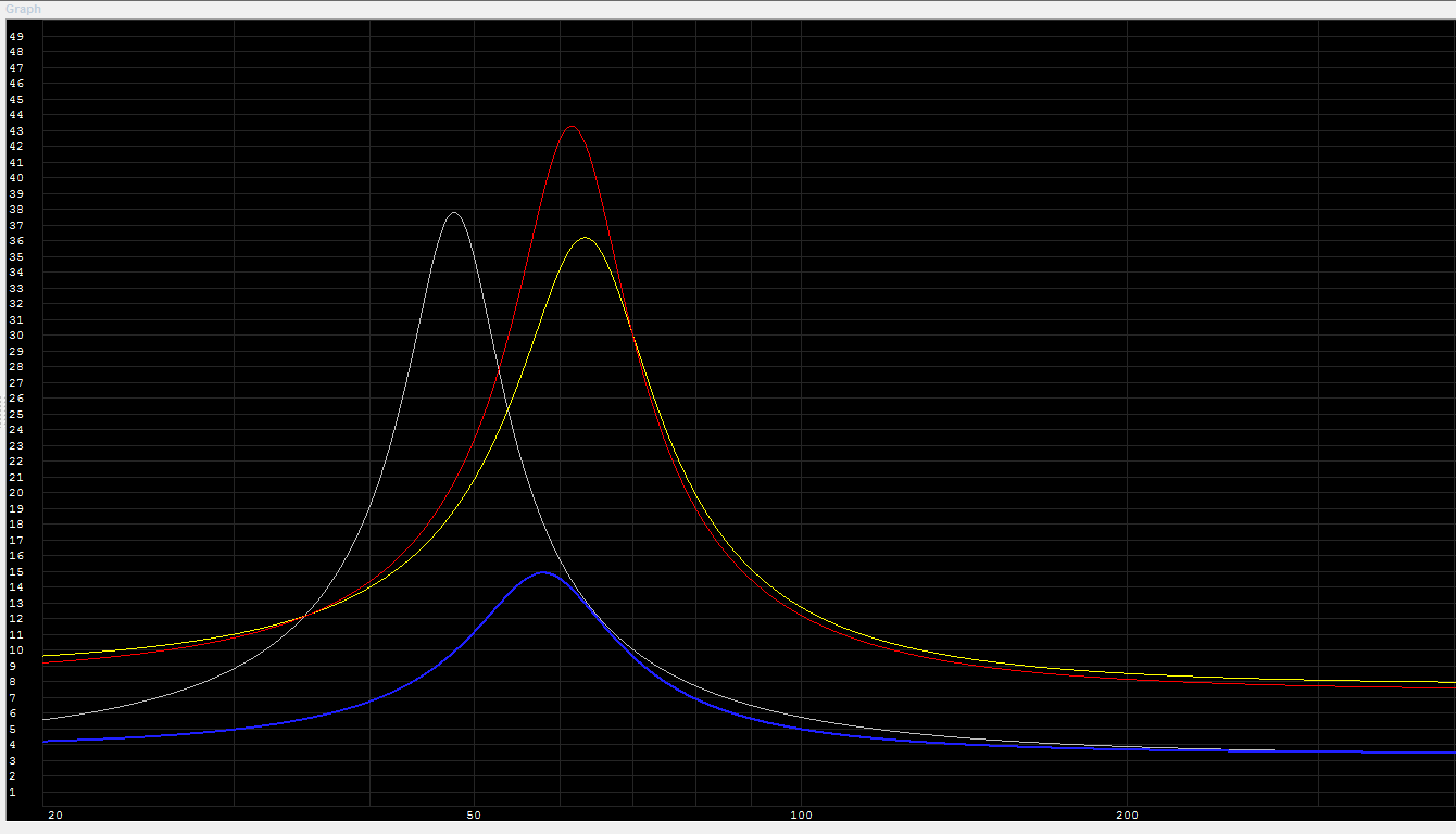

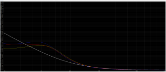

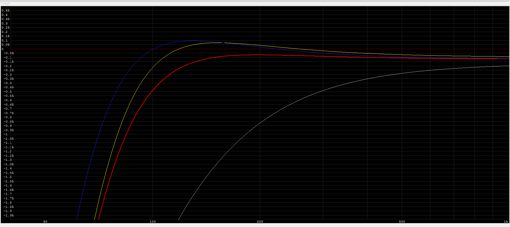

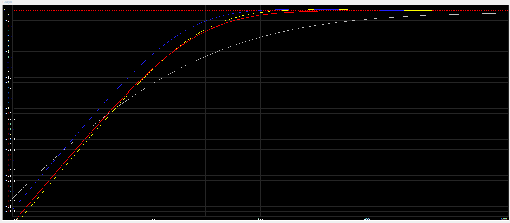

I wanted to ask the experienced users here what they think about the WinISD graphs and how they correlate to SQ. I am trying to buy a good sub to put in my car and now that I've learned how to use WinISD and Unibox, I just want to understand how the graphs correlate with SQ. I tried to have a technical discussion in a few other forums, but so far it has been impossible. After reading a lot of helpful threads through google search, I realized that this forum is one of the more advanced ones.
I already have a sealed box at 7.86L (0.278 cf) inner volume and my goal is to use it for a new 8" sub/
Here are the four subs (all 8") along with their specs that I am trying to decide on:
I have also attached the WinISD results and the projects (.wpr crated in WinISD Pro 0.7), if you wanted to verify anything. Quick note: I have normal amount of polyfill in my box, so I set Qa=15 and also set the Ql=7 since I read that most systems have that much leakage. They are the same for all subs.
Here is the legend for the graph colors:
White - SA
Yellow - ID
Red - JL
Blue - Dayton
Here are the image titles:
1. Transfer Function Magnitude
2. Same as above, but zoomed in
3. Group Delay
4. Max SPL
5. Impedance
I am trying to figure out which one would be best for my car. It seems that the sub with the best Qtc is the JL Audio at 0.749, but I am not sure if that alone is a good predictor of SQ. I am mostly trying to understand how does the transfer function magnitude translate into SQ and whether such small differences between subwoofers even matter given the non-ideal situation of a speaker being placed in a trunk.

The graph titles don't show, but I can see what's what.
The Sundown is out because it's got poor response in a sealed box. The others are pretty close really and it will come down your budget and goals. If you want max SPL then the Image Dynamics offers a bit more, but it's not really noticeable to the ear. It also offers a bit lower group delay, but again it's not a huge difference, and the slight bump in frequency response may have a negative effect (depends on your taste - most people will think this sounds punchy).

Sound quality comes from a lack of distortion - reproducing the original signal accurately. Not surprising. Music is made up of sine waves at different frequencies adding on top of each other, if some frequencies are not reproduced accurately, SQ goes down. Problem is, there many, many causes of distortion in audio reproduction, some more noticeable and more easily controlled than others. Let's break it down into two groups:
Response distortion. This could be considered frequency response, phase response, group delay, and time alignment. Any large peaks/dips or too soon of a rolloff in FR (before cabin gain comes into effect) is bad for obvious reasons. None of your sub models shows excessive peaking, especially compared to some car designs. The sundown sub rolls off way too soon to be useful.
Phase/time/delay are tougher....say you want to reproduce a kick drum sound. There is spiking content at 80hz, 160hz, 320hz and higher. Now, if your sub is 10ft away from your ears producing 80hz, while your mids are 2 feet away producing 160hz, 320 hz and above, what will it sound like? The kick will come through as slow, smeared, muffled, etc, which will lead most most people to simply turn up the sub for more bass........crappy bass. Using time correction to delay your mids/highs to match up with the sub is extremely important in car audio SQ. Or you can put a sub in your center console.

Of the models you posted, the response of the Dayton HO is the best. The better sensitivity of the ID unit above 80hz isn't going to help much, while the dayton will give you a bit more low end with its lower rolloff. Also, the dayton is a MUCH, MUCH better driver than the others listed and will have much lower distortion - aluminum basket, very stiff and beefy aluminum cone, tinsel leads in the spider, shorting ring motor design. It's in an entirely different class of subwoofer. I have a pair of 15" HO's that I've written about here and am very happy with, in fact my subs would make an amazing car sub

No, good SQ is smooth and even response.

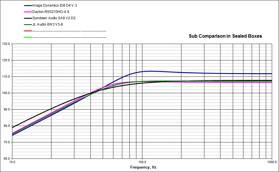

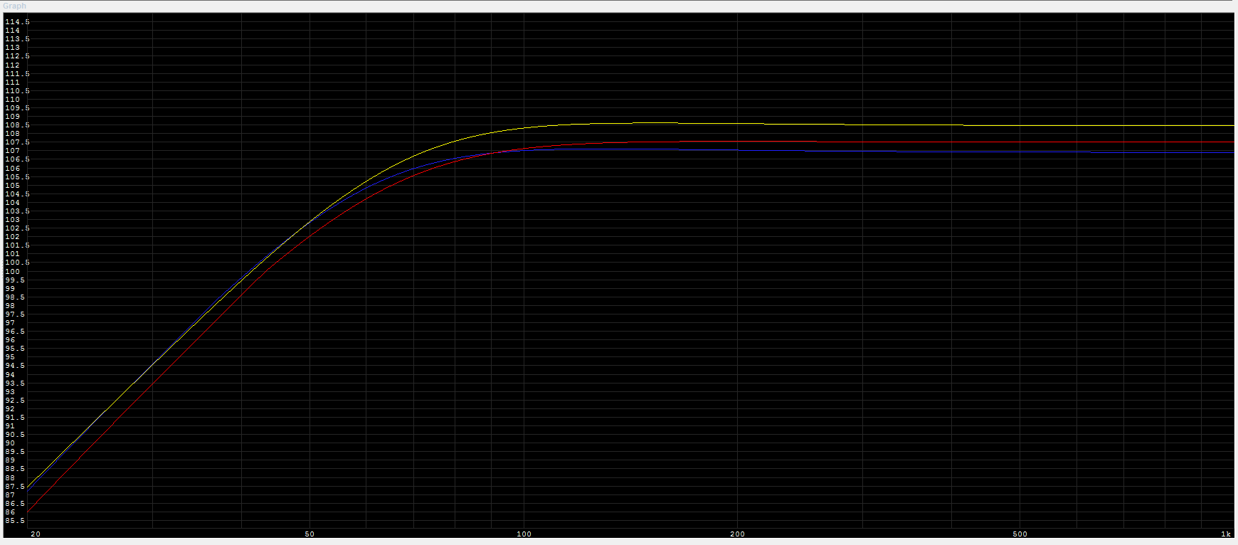

I have attached the Unibox comparison, same Qa and Ql.
Wanted to mention something: In Unibox, if I use the "Heavy Fill" and "Minimal leakage" parameters (Ql=20, Qa=5) and then "Optimize Vb for Qtc=0.707," here are the Vbs I get for a sealed box:
Dayton - 13.1L
ID - 18.4L
JL - 7.9L
SA - 1.7L
So judging at least by Qtc, which I hope is just a conglomeration of the entire ballpark quality, SA is out since the required box is smaller than the speaker and ID is out, since the required box is way too large. This leaves Dayton, which is close enough, and JL, which seems to match my box perfectly. At least for the purpose of this discussion, given that I am trying to fit a sub to my box and not the other way around, is my assessment correct and does it make sense that the JL would produce the best SQ? Ideally, I would like to get the Dayton, but all these parameters are hard to make sense of. I thought that SA would produce the highest max SPL, yet it seem that ID beats it. Several people have also mentioned to me that the Dayton has a higher quality motor compared to the ID and JL, but I don't understand how that is quantified and based on what.

You need to to be looking at the actual db vs. freq graph, for starters, the 4th graph in your original post. And yes, it still rolls off too early to be useful without a larger box, but seems like a nice quality mid-end woofer comparable to the dayton. The ID and JL are overpriced low end subs.
