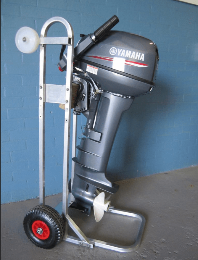

What do you do when the drive is a small 17kg lump? Trying to figure out how to mount this thing for testing in free air. A safe way to work with outboard motors is to mount them to a goods trolley. Would bolting an MDF ring to the trolley uprights so that the weight is taken up by the trolley blade on the ground be sufficient? Done in this manner, the cone would have some steel pipes in its path and the total weight holding steady to the ground and some give in the wheels
