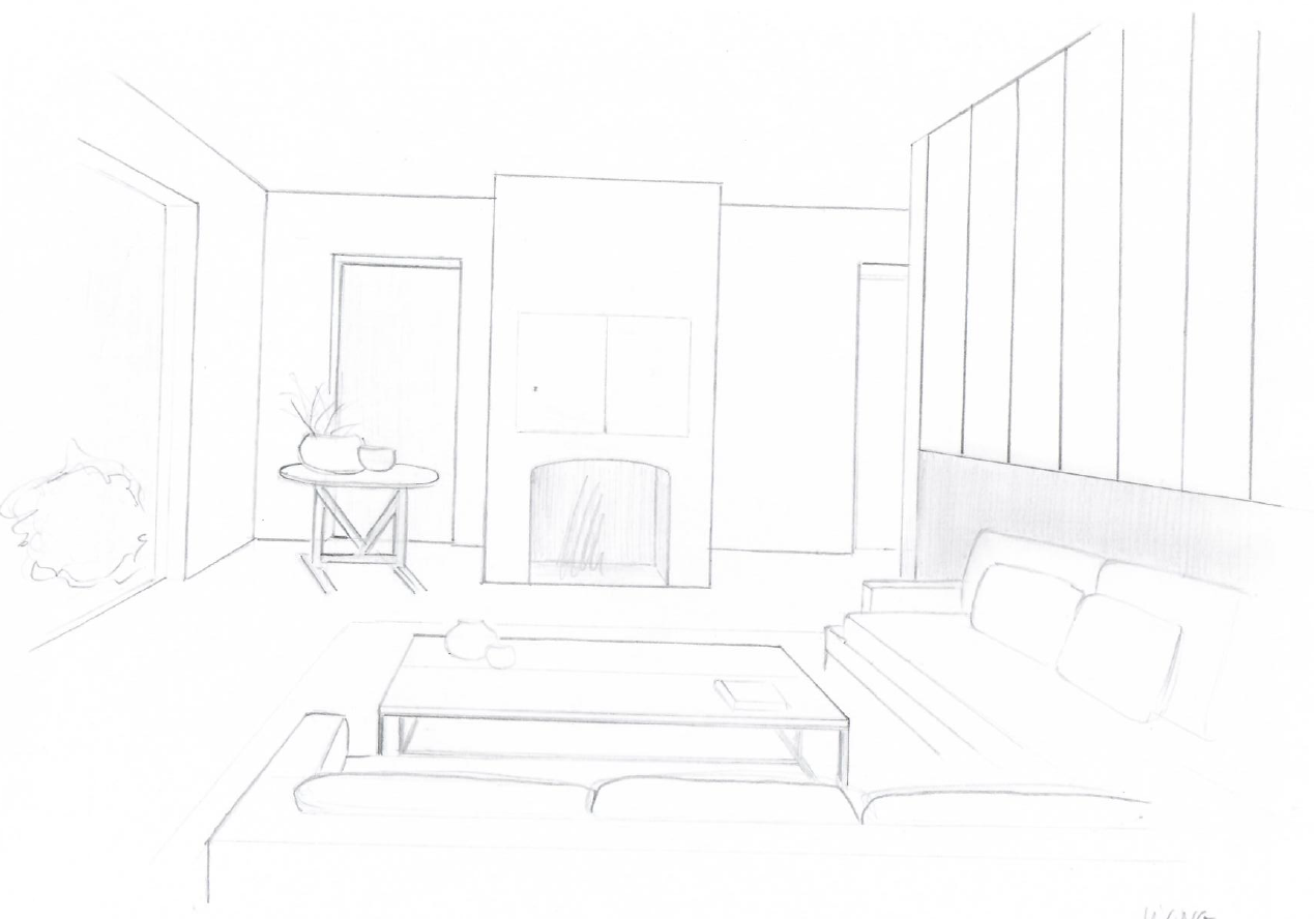

by the way: this is a drawing of our living room. Speaker is to be placed in the upper left corner.
This brings me to my next question: If I install the drivers and horn of the statement speaker into a cornwall cabinet (BR) or an upgraded aristocrat cabinet (Horn) , can I do this without having to adjust too much to the Original crossover of the statement speaker?
I think by being broad with my answers it is making it more difficult... If you put the statements in the other cabinet, you then give them corner placement and corner bass loading, I can see three things standing out that will be different from the original.
One is a broad efficiency increase in the bass due to it working into eighth space rather than full. This will then be more smooth than the original due to the more careful arrangement of earlier reflections.
Then there is an increase in midrange reflections due to the midrange not being 'built in' to the corner, but instead being placed 'close to' it. This may produce response and spatial variations.
Thirdly, your bass will encounter variations due to the more distinct excitation of the room modes from the corner.
You will have to measure to know what to do. You will have to incorporate the corner into these measurements as it becomes part of the speaker.
