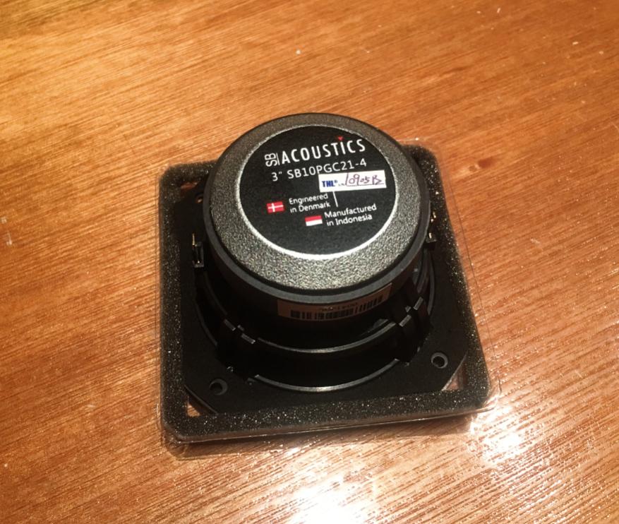

I have recently finished a pair of 3 way dipole speakers. Still finetuning them, but also looking into speakers for another room, about 3.5m x 4.5m and 2.5m ceiling. The room is symmetrical and corner line arrays would fit in very well - so I tend towards these.
I read a lot through Wesayso's thread, also the corner loaded array from ra7 and got some of the Vifa TC9FD-8-18 to play with. I also ordered some of these new fullrange drivers from SB acoustics (about 12 euros each, excl VAT).
SB Acoustics :: 3” SB10PGC21-4<br><font color="#C70039">SHIPPING</font>

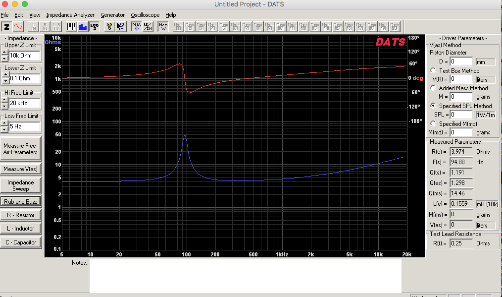

Is the lower Fs (89Hz instead of the 125Hz for the Vifa) an advantage? I think so?!
Does anyone know of a service, in Zwitserland or neighboring countries, that could provide me with CNC cut baffles? I am thinking plywood.

Rising HF, flattish FR, lower Fs, generous Xmax, controlled impedance, square frame.
I'd say that looks like a winner!
It should give the TC/TG9 a run for its money.

Hi Erik, where did you find the new SB drivers for sale, and at that price? Frank showed them to me at the SB booth a year ago in Munich, but I haven't seen them anywhere on actual sale.

Thanks for the replies!
The supplier is Compacbel, a Belgian company.
Compagnie Acoustique de Belgique, Compacbel
Actually I buy from compacbel and the products are shipped directly from Denmark. Please note that the price I gave, about EUR 12 each, is without VAT! OTOH, Compacbel told me that SB will only give a price break at 250 units, I am sure we could arrange a purchase through Compacbel and have the shipper Frank split into 4 orders (assuming a pair of line arrays will use about 60 drivers) - who is in for a GB? 🙂

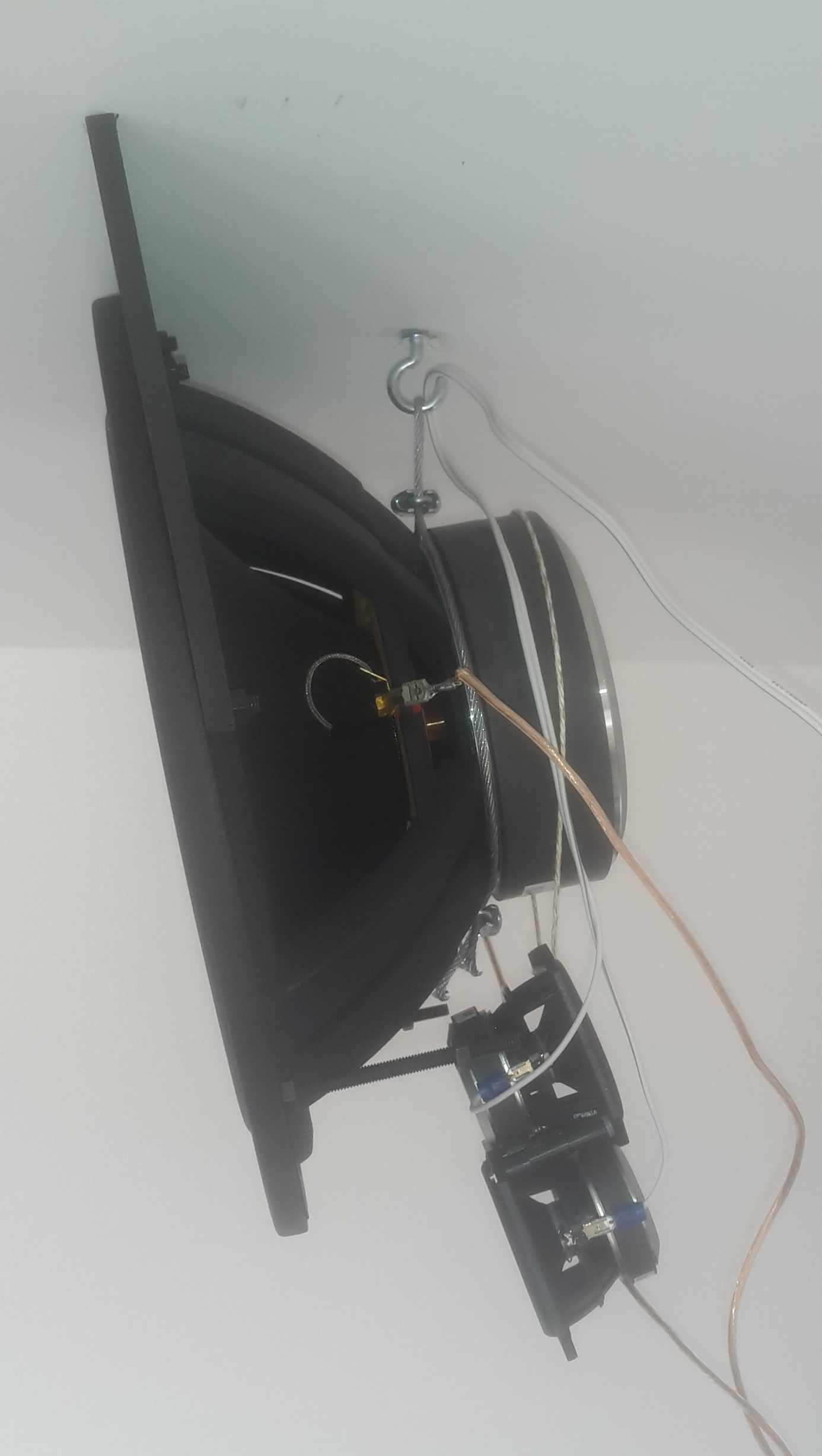

I am slowly catching up with this project again. The last months I listened to a pair of back to back of the drivers, supported with a 12" SB34NRX75-16. It hangs from the ceiling, freeing up some precious floor space which is nice for the our children! I can enjoy the ECM records stuff quite well, so I am going for the line array setup in another room!
I must admit I have not made a lot of measurements (just some tuning of the crossover and SLP filters needed in the OB operation, but no distortion) and I am aware I will need to do that on the line arrays for optimum performance.
Regarding the Open Baffle line array:I must admit that I still like that idea very much. One of my ideas was to extend the array of FR drivers to the floor 🙂 Still, for the moment I am looking for something that can be "hidden" in the corners and still has potential for excellent performance (as I read in other threads).
Now, I have no experience with sealed boxes. How to calculate the required volume for the sealed enclosure? 🙂 I will read about that!
