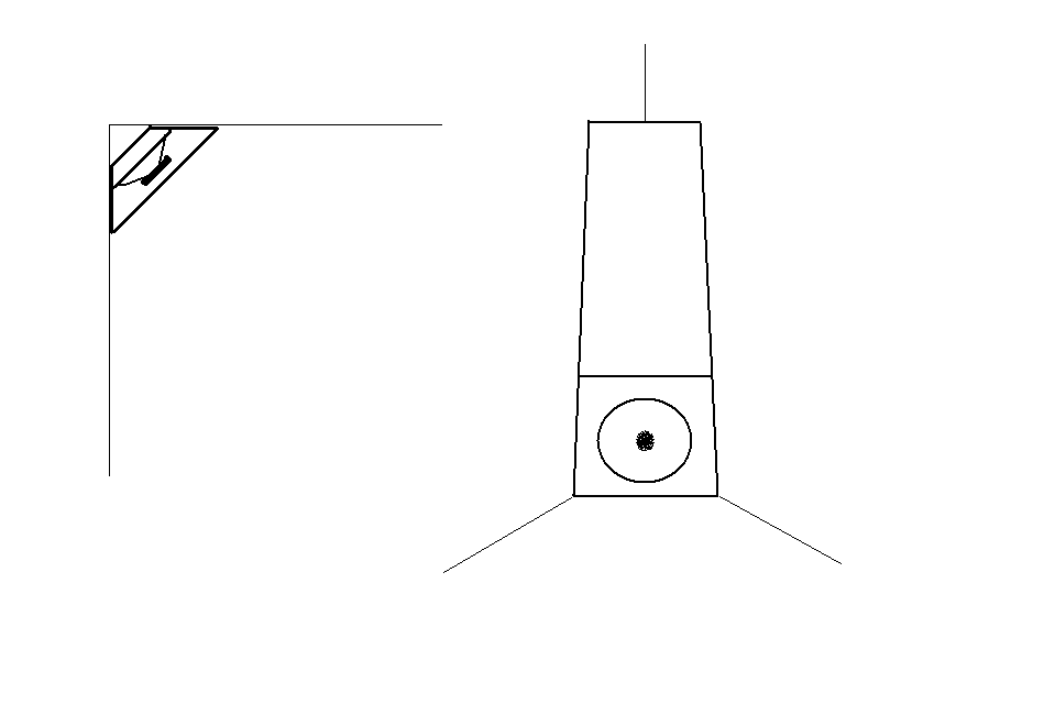

For several years i have thought of how to make a SIMPLE triangular shaped corner horn
IF you mount speaker on the front baffle, you will have the last horn section in the corner, and thereby loose space and surface to construct the horn.... hope it makes sense
The solution came with the idea of mounting the driver in hornmouth, and thereby have the last horn section away from the corner, having much more surface to work with - and at the same time have the corner to load the front of driver
Problem is ofcourse, that it is restricted to use only as basshorn - on the other hand it ought to be wider in frequency than a frontloaded horn - anyway the idea was to use a cheap 12", which would be of no use at higher frquencies anyway

Nothing like a puzzle to start the day.
Due to the non directional attributes of speakers at low frequencies,
any speaker placed in a corner, becomes horn loaded. A square box will leave gaps, reducing coupling.
The triangle x-section overcomes that. The simplest way is a front ported BR. You could go all out and build a Klipsch, lots of timber and 45 deg cuts.

Some thoughts on this. If you were to build a fairly common baffle, you could attach a bass horn that went into the corner. If you lined up your cutoffs and tuned and damped accordingly, the horn would make baffle step compensation unnecessary, and this means the driver wouldn't need to go into the corner.
OTOH if you design the horn to play louder than the driver and only want bass from it, it isn't going to matter as much where the driver goes.
In my experience, appropriately designed corner loaded bass horns can get you to 20Hz with ease.

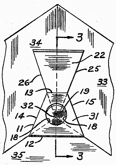

US Patent 3,554,314
Schneidewind Jan/12/71
Regards
James
APPARATUS FOR CONSTRUCTING A SPEAKER ENCLOSURE
Abstract The invention relates to portable panels which, when mounted into a corner of a room in conjunction with the walls of the corner, substantially encloses a speaker that can be attached to one of the panels and provides the enclosure with a horn duct that makes possible a wide range of frequency response, especially in the lower range.
Regards
James

That patent on the corner baffle: That'll teach me for sitting on an idea too long! My idea was to have a trapezoidal baffle in the corner, leaving a gap at the sides, to form a slot BR. I have run out of corners!
Ah, the Elkhorn. An alternate is a front firing WR rear horn loaded.
