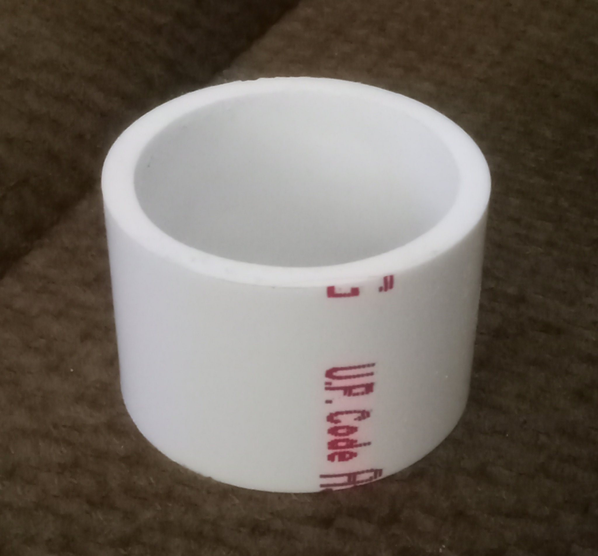

If you go air core, PVC rings suffice....

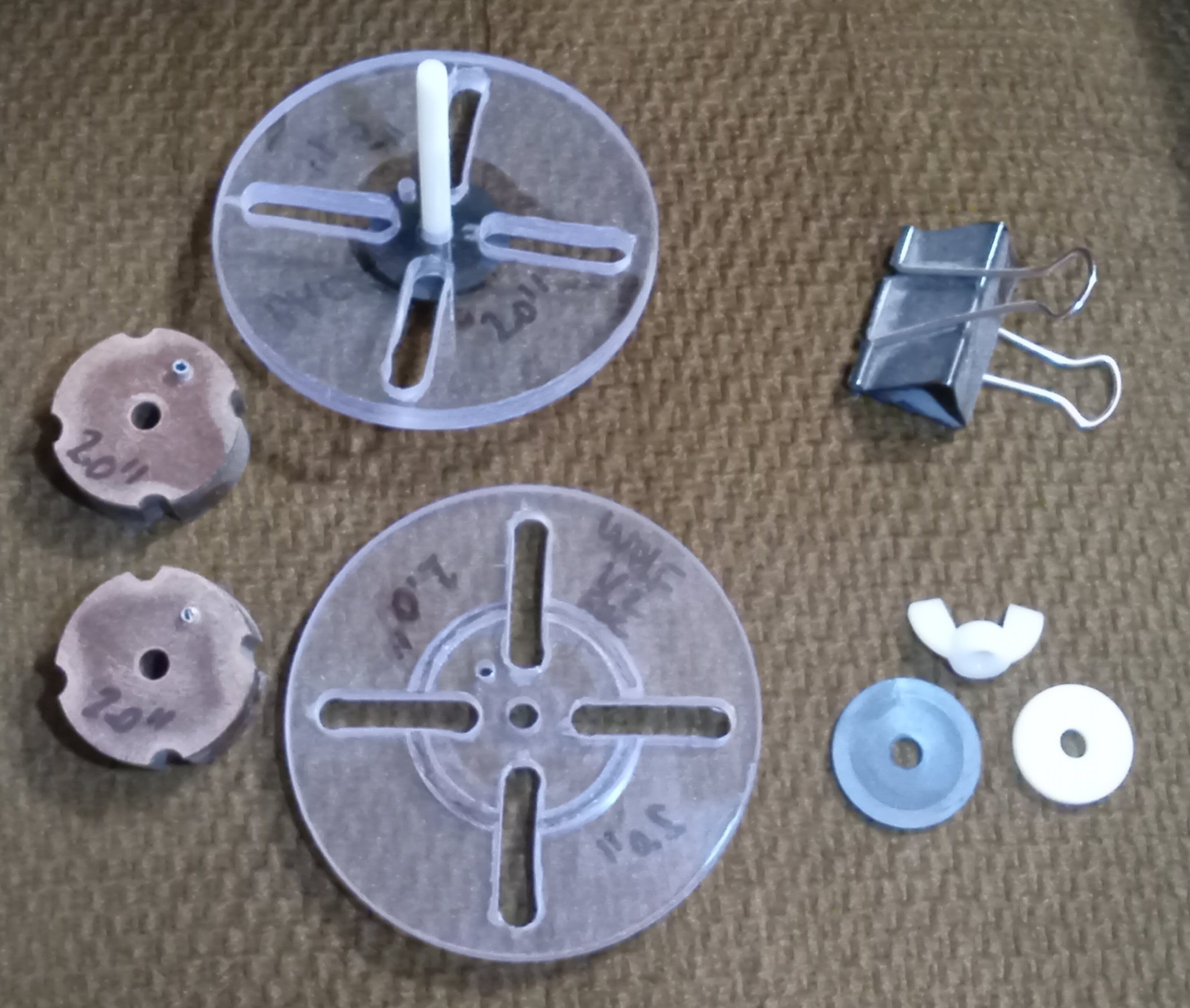

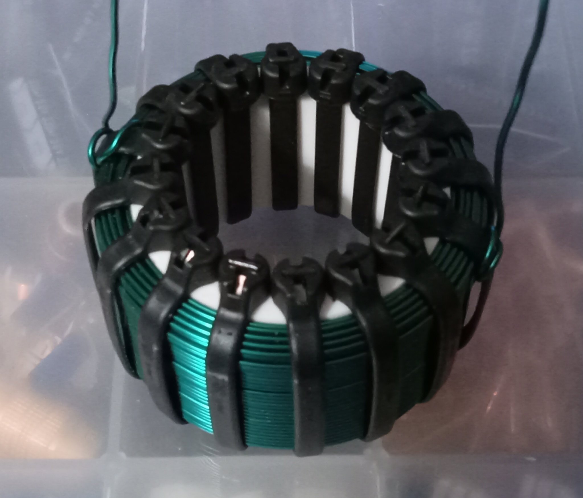

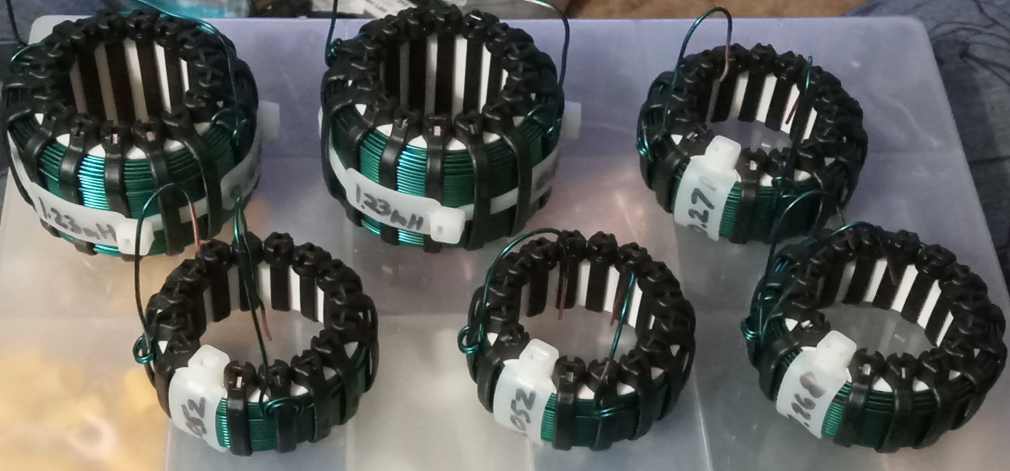

The faces are 3/8" lexan. The face has a groove for 2.0" diameter PVC center hubs to be used. I have another face made for 1.5" PVC. Wire pictured is 18awg with Blue (dry oil) polyurethane coated enamel. Zip ties are Thomas and Betts steel-barbed ties.
Reactions: jordheis
Amazing work, Sir! I like how neatly tied it is.

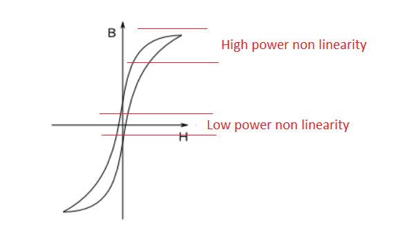

You need to check the effective permeability or THD of these C-Cores, cause high effective permeability can distort even below 1W, cause signal will be affected by the hysteresis and natural non linearity of iron all along the BxH curve.
In your case, using very low power, saturation will not be a problem if you take cores designed for 200W, 400W and this information is available from vendors.
So even if they push their cores to 400W and touches the saturation region, with 10W, 20W, 50W you will be far away from that region.
