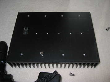

I have followed some of the advices in this post, and I have been tapping quite successfully. Althought I was unable to find a spiral fluted tap until it was too late (*after* I got a normal hand tap); The hand tap was still sufficient however.
I have tried two methods to help myself tap square. One was to use a drill guide I made with two thin sheets of aluminum. It worked well. But I find that every hole I tapped with the guide, the guide would enlarge quite a bit. Perhaps a guide made with thicker, harder sheets, and some better fit bits would perform better.
The second method I used was with this:
Wolfcraft Drill guide (without the angle adjustments)
Tapping flat surfaces was very easy with this gadget. I am still thinking if it would be possible to use this drill guide to tap the end of a bar however...
There are two sizes that I am tapping with, M3 and M6. Tapping M3 holes was quite easy with the cordless drill; all my M3 tapping went through in one run. Tapping M6 proved to be a little more challenging. Occasionally, the tap would jam and I would have to back the tap up entirely and clean it. I use a nasty but effective solvent, Toyota Brake Cleaner, to quickly clean my taps. I strongly believe that brake cleaner should be added to the 'build the world' items like duct tape and zip tie.
