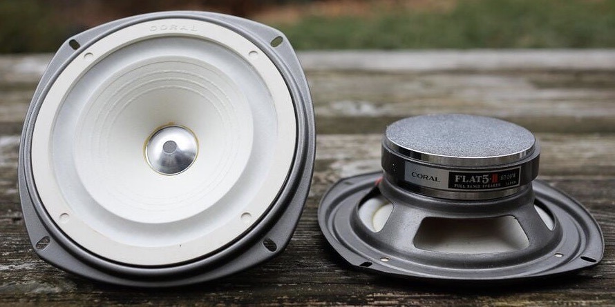

Hi all, Can I hear of the view of you fine experts on whether Coral Flat 5s would work in Fostex FE108ez horns. The drivers are 132mm wide yet the horns designed for 108mm wide drivers. With the Corals being a 5-inch driver, there are limited horn designs, plus I’d love to build the above design, but I need to get advice as it’s a lot of effort and money to get wrong.

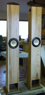

The Fostex horn has such a small mouth area that it really just work as a quarter wave resonator below 100 Hz, so why not use a well designed voigt pipe like the frugal horn.
If you really want to build a horn something like a 5/8 scale of "the big fun horn" or "Schmacks horn", might work, with their far larger mouth areas

I try not to get too involved with names. With the technical hat on, FH3 is a [single] tapped* parabolic corner pipe-horn with an internal low-pass expansion choke. Which isn't much of a name, so these days I usually just call it a tapped corner horn. It's a nominal hypex, but having parallel sides strictly speaking shifts it into the parabolic. A [single] tapped horn is arguably another way of saying 'Voigt horn', aka 'pipe horn' -but not necessarily the same thing as a 'Voigt pipe', which in its most common form (e.g. the LCON VP variation shown) technically makes the definition because it's a pipe with positive expansion to the terminus, but isn't really designed the same way since its a pure standing-wave generator in its passband, whereas something like FH3 & some other types actually have sufficient expansion for horn loading.
Voigt is a bit of an odd one really, since if you go back to his original '34 patent application, he never really made much in the way of specific stipulations. He noted in one implementation [up to] a potential 2.5:1 expansion & in essence a 1/2 tap location for certain organ-pipe derivations, but the majority, including the expanding pipes, were end-loaded or nearly so. Same went for his famous corner horn -end loaded. All the expanding pipes were truncated, with the arguable exception of the organ pipe which was slightly more complicated in the details of the cross section & the slightly offset small vent, though he didn't provide any details and since all he really said about the sketch was how the driver 'might be mounted' I suspect he never actually tried it -or hadn't at that time. I've never got to the bottom of where the typical 'Voigt pipe' (e.g. the attached) ever really came from; I always assumed it was developed empirically from a handful of ROTs that had developed over the years, partly from slightly erroneous interpretations of Voigt's patent, partly from trad. BR design, and partly from -your guess is as good as mine & probably better. 😉

The Coral Flat 5 were very nice drivers once and still are, IF they are still in good state. Many of those old FR drivers with light paper cones and light suspensions suffer from problems nowadays. But IF you have a nice and equal pair, they´re worth the efforts to make a nice "box" for them.
How to be sure? Measure impedance, calculate TSP, measure response and distorsion. Then you have a base for simulating behaviour in different types of enclosures, all else is guesswork, sorry.
