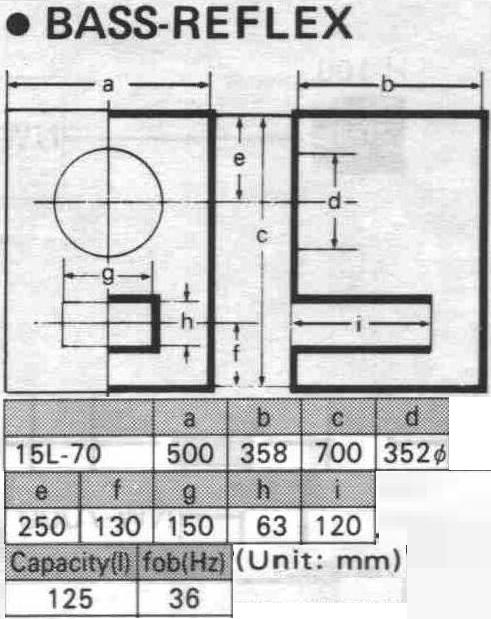

Hello !
I am from Germany and found this very interesting forum 🙂 .
Does anybody has Information about the CORAL 15L-70 from Japanese company Coral.
I need the Thiele-Small Parameters and all information about this speaker. I have two of them. Both are refreshed and I would like to build a box with them. So I need Information and ideas.
Thank you for answer
With kind regards
Andreas
