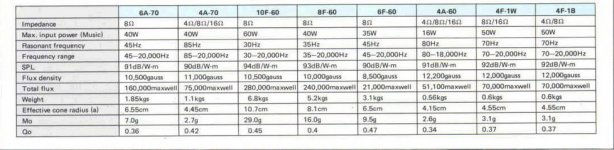

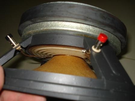

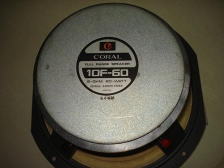

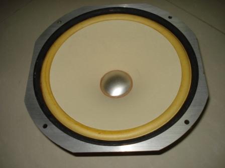

Hi AroS3,
Thanks for posting the pictures. Yep that's the one.
My friend have those specs but was wondering if
onyone have tested it's parameters. I kind of wonder
if it really could go to 20K. One thing I find interesting
when compared to other FR is that the cone is very hard
unlike other paper cones that I've seen. Hmmm maybe it's
distortion is much lower with this cone set up. Have you ever
heard this speaker ? If so how does it sound like ?

i highly doubt so... my beta 10 cannot even reach 10k without rolling off. My friend's flat 10 is worse.

Hi fffO,
I do think so too. A two way would be the way to go I
guess. Given that the cone is pretty stiff, I should think
that the sound would be pretty clean & clear
