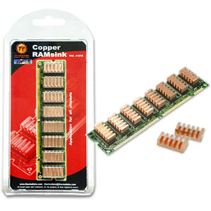

There is a quick tweak that you guys can try.
Thermaltake sells copper ram heatsinks for DRAMs. These heatsinks comes with a special 3M heat conductive adhesive to allow one to stick it securely to the any chip.
These heatsinks are rather thick and they should also act as good shields for EMI/RF shielding purposes.
The heatsinks are retailing at a couple of buck for a pack of 8.
You can stick them to your dac, receivers, opamps, digital filters etc...

You'd need to connect these heat sinks to ground to get the EMI/RF shielding. Wires to connect them to ground should be as short as you can easily make them, like a few centimeters long. But be careful you don't create any ground looks if you use multiple wire connections.
Yep. To get proper shielding, you have to connect the heatsink to the ground via a short length of wire.

The purpose of shielding is to shunt RFI to ground. How can you achieve this whithout connecting the copper heatsinks close to the gnd pin of the underlying IC? So soldering is inevitable! Ho cares about adhesive ..buy a new epoxy kit!!
no ..no ..no!! Each shield must be connected close to the underlying IC. Otherwise you generate a RF mess radiating everywhere!how about connecting the heatsinks in 'series' with wires, and then to ground? wouldn't that avoid any issues with ground loops?
Ground loops aren't generated by single shields connected each indipendently at one single gnd point.

Hey guys,
Do try it out and see if this tweak works for you. It is cheap and it is very easy to implement.
You can either ground it or if you are lazy like me, stick it on the chips and do the grounding another time.
The copper heatsinks are about 2.5 to 3mm thick and they are quite heavy (relatively to the aluminium heatsinks).
The fins are too short to act as a tuning fork and even if this is the case, I am sure that you guys can find a way to damp it.
In my crude experiments based on a handphone as the generator of EMI/RF, I found that thicker copper sheets provide better protection from EMI/RF.

Well,
My Thermaltake copper heatsinks arrived today but they are diferent to the ones pictured above. The ones that I have bought have a square base and unfortunately are pretty incompatible with the I.C.'s in my CD player. Especially as they are SMD devices.
I have attached 2 of these across four regulators that lay flat on the PCB. So that 2 regs share 1 heatsink. I know it's probably a waste of time and money but what else can I do with them?!!
They are pretty cool things in the flesh though and are surprisingly heavy and rugged for their size. The adhesive sticks fairly well but leaves the sinks able to be twisted slightly.
I'm pretty sure they're going nowhere though unless I drop my player!!
If anyone wants to get some of these then just make sure they are the right version.
