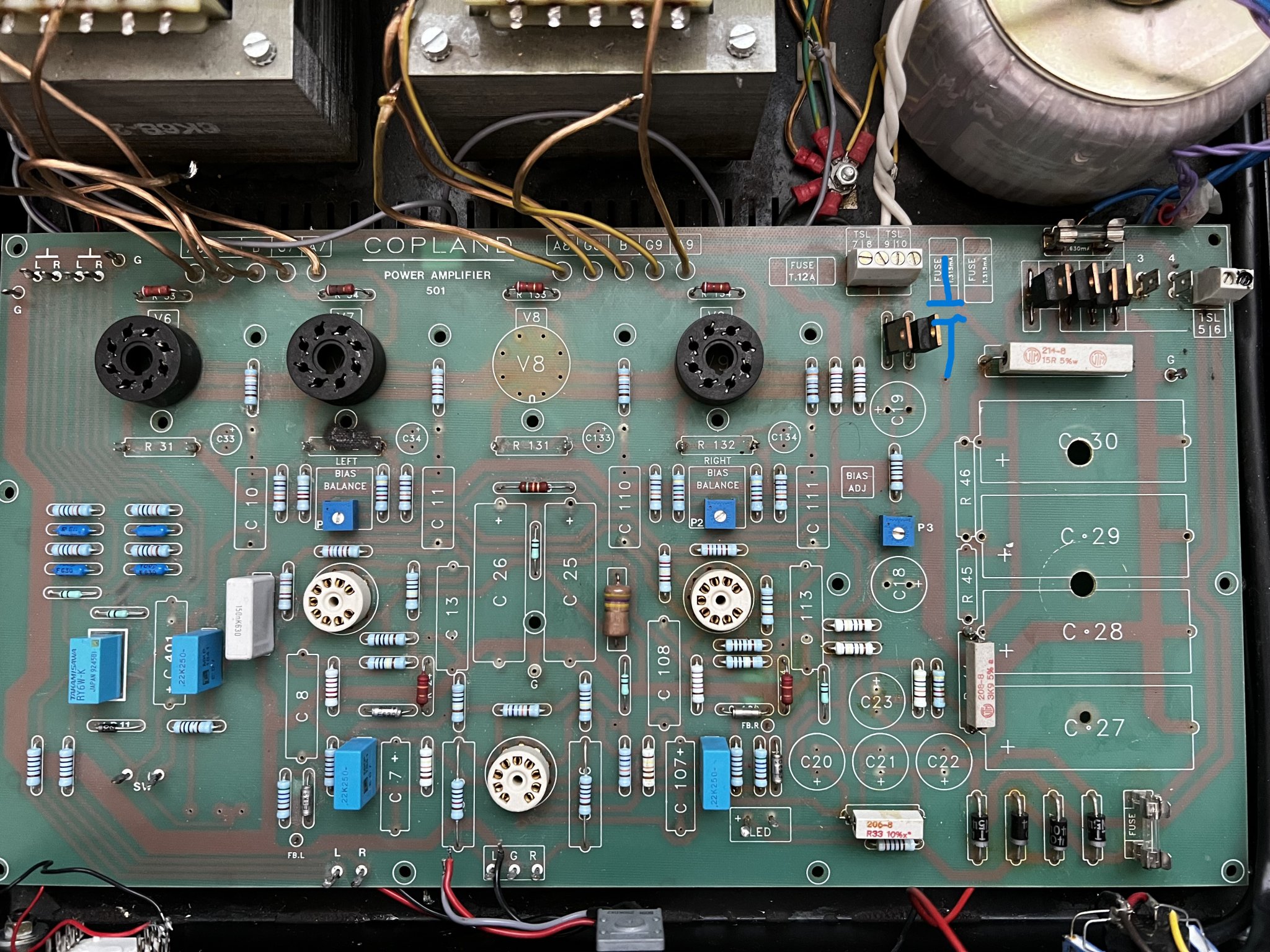

Short story. 15-20 years ago I removed plastic from capacitors in search for better SQ. No components, please 🙂 . I have to replace these capacitors but need help to identify ratings/values for: C18-C23. See schematics.
Yes, I know I have "vandalized" an great Copland amp, but I hope I can restore it with some help. Thanks.

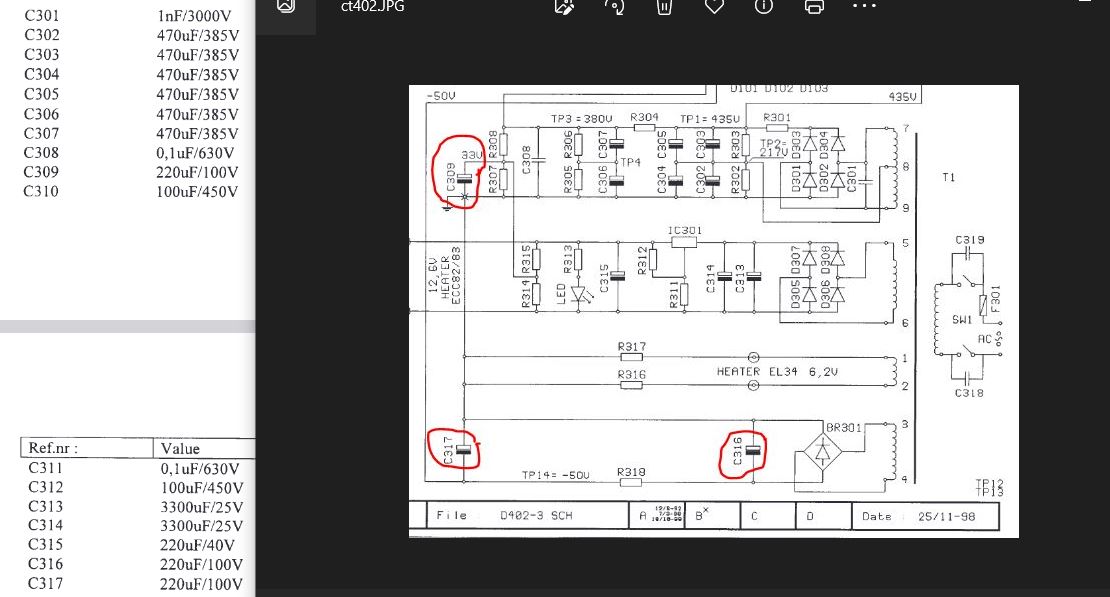

Many Coplands have roughly the same power supply.
https://www.drtube.com/copland/
has a service manual of the CTA402 with part list.
Looking around at the other schematics should give you a pretty good idea of the values.

Personally , I don't think it's wise to assume this model will use a shared design just because some of their other models do.
Why not measure the working voltage across them . Then pull them and measure the capacitance?

In 2022 I completely replaced the electrolytic capacitors on a friend's Copland CTA301/CTA501 pre-power pair.
I can't say the exact correspondence between the codes of the capacitors in the diagram but the 6 electrolytic capacitors are 3 of 3300uF/16V and 3 of 470uF/63V (I used the Panasonic FR capacitors).
I think I can say that C20-C21-C22 are 3300uF/16V while C18-C19-C23 are 470uF/63V; however, once the old ones have been desoldered, you can check with a tester where to put the new ones that you will replace.

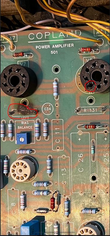

I have removed all electrolytic capacitors and the "biasing resistors" due to failure. Thank you for your tip I will order same resistors! Also need to replace one tube socket due to bad connection - heat? C33 - C34 - C133 - C134 is not populated on my PCB, should I do something about it?

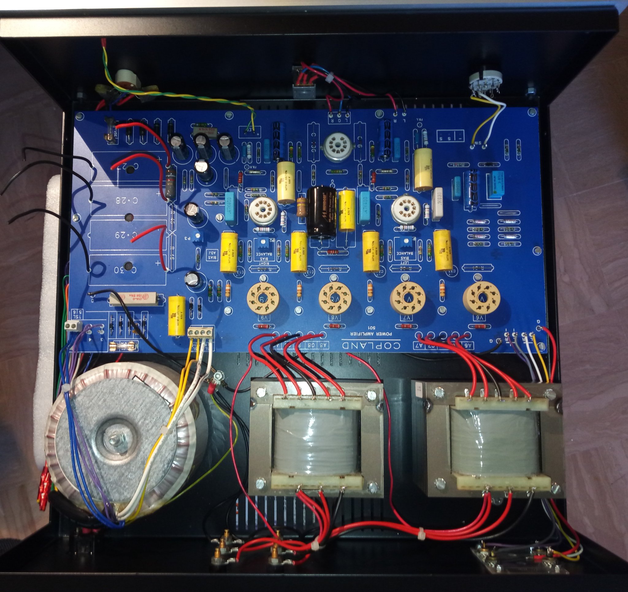

I check the photos available to me and, if necessary, my friend's amplifier...

As you can see, there are no capacitors in C33 - C34 - C133 - C134.
But ICEL plastic film capacitors are missing in your PCB: why?
Taking your photo as a reference: where are C8, C11, C13 and C26 (C25 is an electrolytic capacitor) plastic film?

I have them removed - want to try some fancy audiophile capacitors.As you can see, there are no capacitors in C33 - C34 - C133 - C134.

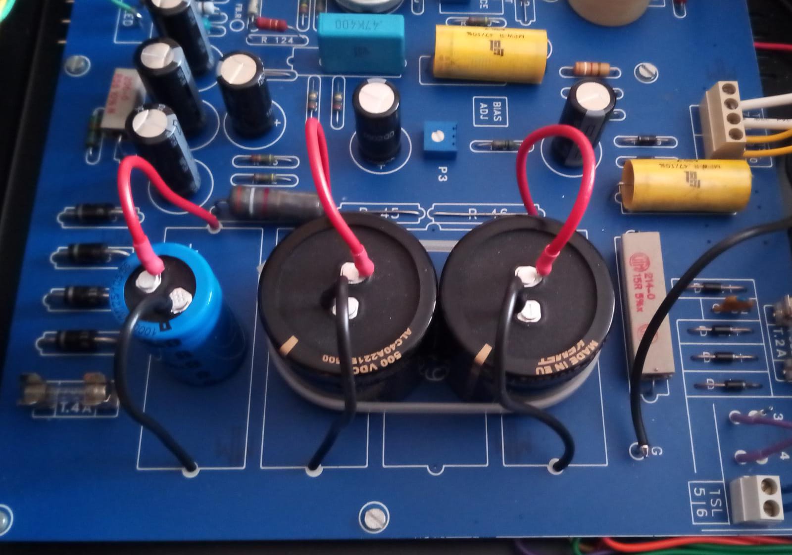

Here is the list of codes of the capacitors to be replaced, only C25 is missing which has been replaced with a Mundorf MLytic HV Power Cap (but I don't remember the value... I'll be able to tell you soon).Yes please 🙂
MAL211818221E3 - n.3
EEU-FR1C332L - n.3
EEU-FR1J471B - n.3
ALC40A221EC500 - n.2
MAL215919101E3 - n.1
They were chosen for their durability and reliability; regarding the most important ones on the power supply, it will be necessary to remove the old ones that are screwed in and position the new ones using adhesive pads (quite tenacious).
This is the result...
Now I have cleaned the PCB and removed the parts I want to replace. I am very grateful for your advice and will order parts form Digikey.However there are some minor differences from your amp to this amp, such as my amp is missing coupling capacitor for HV electrolytic.This is a photo of the amplifier during maintenance: I still had to replace only the three most important capacitors...
