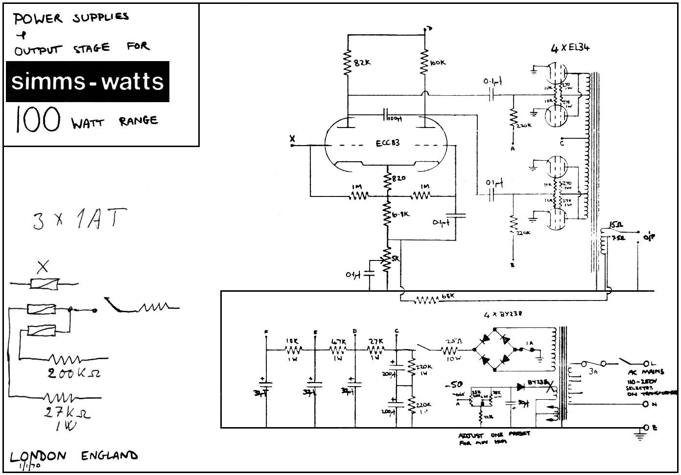

I have a simms-watts PA 100 head http://www.drtube.com/schematics/simms/100w-amp.gif , that im trying to convert in a guitar amp. I already turned off two tubes (OT still sees impedances), this softened the sound a bit..
I wonder if it is posible to convert the power amp in a triode mode. The plate voltage is around 500 V, I think this is too high. And should i conect the screens with 100 Ohm resistors too the plates?
Any suggestions?
Yes, 500v is much too high for triode operation, especially since that amp uses grid bias, so there is no voltage lost across cathode resistors. In fact, 500v is really too high for ultralinear operation too. EL34 screens are rated at 420v max. What you need to do is drop B+ to about 420v.
As you say, you can just connect the screens with 100 Ohm resistors to the plates and leave the UL taps on the OPT unconnected (and safely insulated). The OPT should still be a reasonable match for triode operation. Just watch the bias when you switch it on - set the two bias pots to maximum negative voltage (minimum current) and adjust from there.

Ah, that's where I got the idea of 420v from. Thanks!
If you replace that 25 ohm 10w resistor with a 5H 600mA choke, you should be OK, That will give you about 320v which is fine for Class A. You'll need a much higher quiescent current - around 90mA per tube - and that may require some changes to your bias network.
