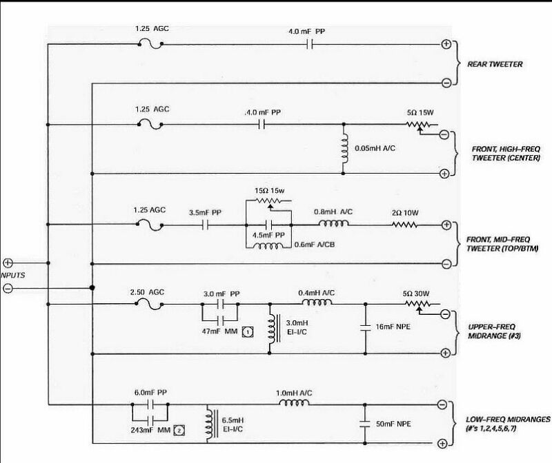

I want to convert the attached HP crossover of my Infinity RS-1B speaker system from passive to active. My knowledge concerning crossovers is limited to very basic theory, so I need help and examples of a converted version. Any help is greatly appreciated.

You haven't given us much to go on.
How basic is your knowledge?
Do you want a completely active crossover with four sets of stereo amplifiers?
Do you want to use commercial active crossovers or design your own? If yes to the second part, have you done any active filter design?
How much equipment for measurement do you have for measuring the acoustic and electrical frequency response.
This is a hell of a big project. Even with my knowledge and equipment it could take months depending on the amount of it that you actual what to build from scratch.

If you really want to mutate this I'd start one step at a time and work my way up. 1st step would be to just biamp. Lose the low pass on the upper midrange and the entire XO on the lower mid. Everything is 2nd order. You'd want to stick to that, and the same XO frequencies unless you have at least some of the kit Fred mentions.
And this question needs asking -- where are the woofers? Already active.
My personal take would be that you'd probably be way ahead to just start from scratch. This sucker is a 5-way with a back-fill tweeter -- way too many crossoover points to get things seemless.

Nice link Fred, it does have an earlier version of speaker in question. It clearly points out that what we actually have is a 3 way with rear firing tweeter, tapered mid & tweeter arrays and an active woofer. Now i'd be even less likely to bother rejigging the speaker, better to use it as inspiration and start fresh.

I've done a passive-to-active conversion on a number of speaker systems. It's not a trivial job, but it can be done. You'd need to make terminal measurements at each of the drivers to generate "target curves" for the electrical response that an active crossover would have to match. Alternately, you could measure the impedance curve of each raw driver and then "construct" the crossover with a simulation program to generate the target curves.
This, of course, is assuming you actually WANT to recreate the original the crossover with an active version. I think it's certainly possible that an active crossover system would allow you to improve upon the original design.
The whole thing could get pretty complicated, but the tools (software programs and measuring systems) are out there to accomplish this project should you decide to proceed.
I agree with some of the other posters. Most of the benefit from going active can be gained by concentrating on just the lower crossover points.

Franklin:
First I have to say that I`m really a fan of active speakers and I hardly do anything passive anymore.
Although said this, I wouldn`t change this crossover to active because I don`t see much benefits doing so in this particular case.
The reason is that this drivers are isoplanar drivers (or magnetostatic) and IMO those do not benefit as much as moving coil speakers from an "activation" and the (moving coil) woofers are already driven directly (active) .
The main advantages (besides others) from active driven moving coil speakers over passive is better electrical damping and less "thermal modulation" as I would call it.
Magnetostatic drivers do not benefit from electrical damping because they are completly mechanically damped.

If You still want to make anything better I would suggest "just" to drive each range with an individual amplifier (multiamping) and leave the passive crossover as it is (of course You have to diconnect the nodes at the x-over input terminal in order to make seperated inputs for the individual ranges).
Not only that You avoid the "hell of a big project" as mentioned already by Fred, I really doubt that You gain much (if at all or making it even worse) by completly changing THIS x-over to active due to the mentioned reasons.
