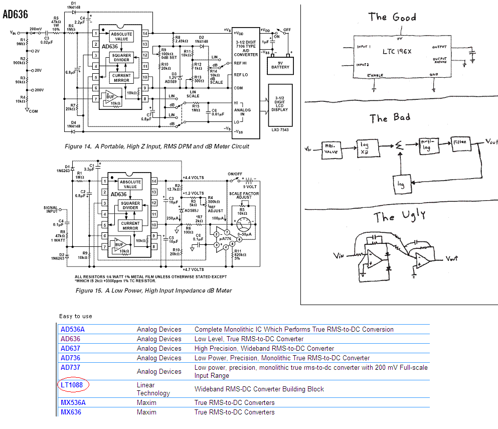

Ok, nearfield measurements can result in high levels, high enough to provoke the non-linear behaviour I mentioned above.
My recommendation would be to compare your design with a "known good" level meter. It is quickly done by holding both meters near a loudspeaker cone and varyling the sound level.

Thank you, Svante, for confirming my formula for calculating SPL difference and indicating how to go about checking linearity of my mike. Actually at this point I am happy with measuring SPL change only and don't want to tackle the more difficult pursuit of building the circuits supplying an absolute dB reading.
Also thanks to bjorno for the references to circuits and ICs for constructing a sound level meter. Given the available free time that would be interesting to pursue.
