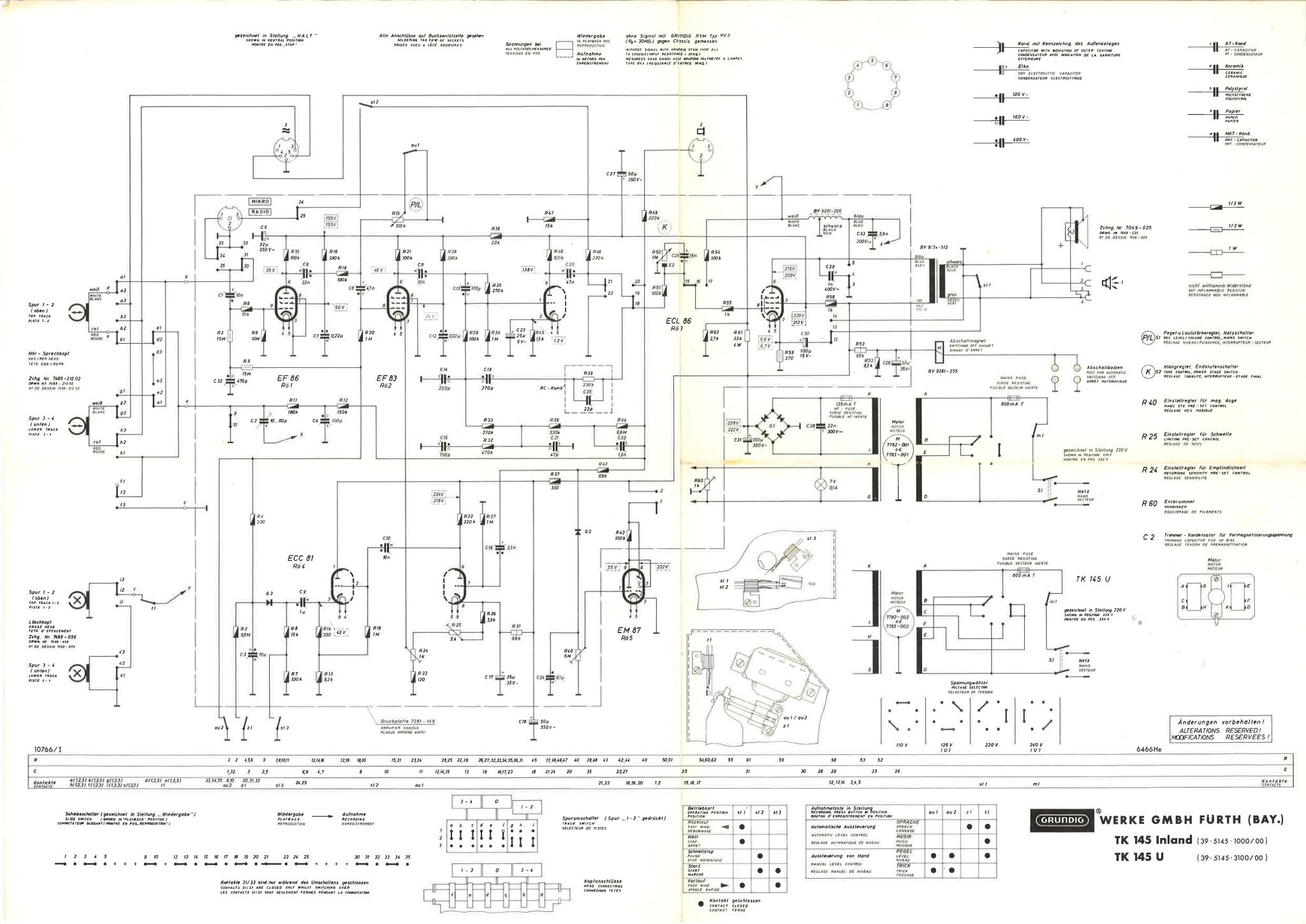

I want to use Grundig Tk145 as an Amplifier, can you help me with what I need or need to eliminate in the circuit? I'm having a hard time because there is no external audio input. Can you help me by drawing?

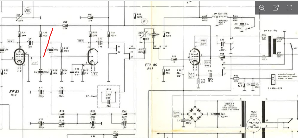

Splitting it where the red line is would be OK I think, but that capacitor and resistor make a high pass filter, and you would proibably need a grid leak resistor and a volume control.
The complication is the switching for the different biases required for the different tape speeds. I would recommend getting familiar with LTSpice and drawing the circuit excluding the switching. LT Spice is very useful for creating schematics, and that part of it is not a very steep learning curve. If you have that then you could get some help to get it to run, and then you would be able to get a good picture of expected voltages and component values.

Looking at it again maybe you need another stage before that, depending on what source you are using.
What's the desired input sensitivity? If it is line level, follow Old Hector's advice, leave only the ECL86/6GW8 triode pentode combo and build a textbook two stage AF amplifier with some mere 4 watts output power. Ground C30, connect C11 to R55, put a 1M grid leak from this connection to ground, disconnect C23, insert some carefully designed GNFB from the output to the triode cathode (pin 2), that's it.
Anything else can be omitted (besides the PSU, of course).

If it will be of better quality, I want to protect the stock circuit by dividing it from the red line.

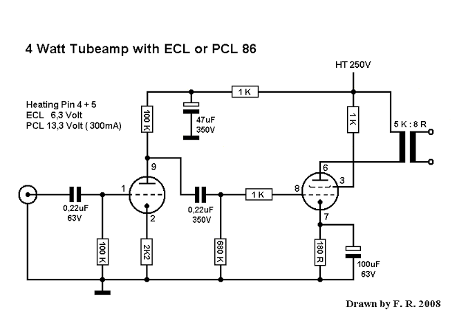

But if the circuit in the next picture I share is better, I can do that too,
or if you have any other suggestion.
The circuit you shared is beautifully simple. It can be a bit tricky doing all the wiring on a triode-pentode like an ECL86, so it would make it easier. There are a lot of connections to 9 pins in a small a small space and it pays to think about the layout before diving in. (This is a good tool for layouts, DIY Layout Creator).
