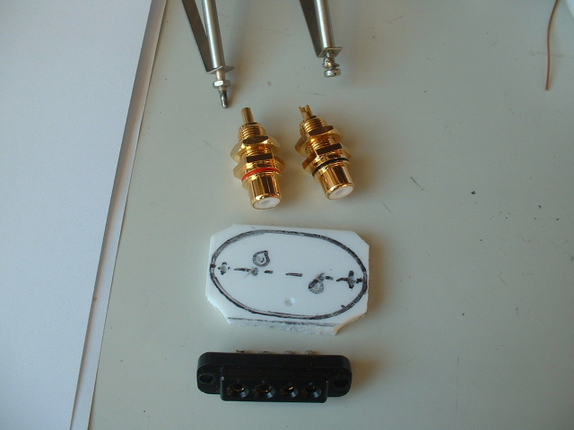

Here's a photo of the bits.

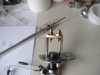

Hi Brian,
Thanks for the photos, very useful given that I don't have the arm to hand and have to prepare for this job and then do it in a weekend, when I next visit the UK. How are you intending to connect the earth tonearm wires to those sockets? There doesn’t appear to be an earth solder tag from the photo.
Mark

that looks nice Holger, mine obviously doesn't look that good, the sound has improved though. interestingly they seem to have joined the earth to the signal grounds, (i can't see a seperate earth pin) i decided to keep it seperate back to the pre-amp on mine, i put a small earth pin through the ptfe. that one looks like it could do with right angle phono plugs as well though!
Mark
YES,
i believe you have a good point sreten, i have only earthed the wire that comes down from arm tube (5th wire), which is electrically isolated from the rest of the arm by the plastic arm bearings. I will investigate this and probably add a link from my new earth stud to somewhere on the lower arm body in July (next time i see the arm).
very observant sreten! Thanks
