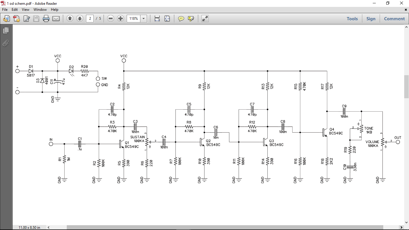

I've seen most of the coupling are 100nf except one 10nf,does anyone think that could be a mistake in the schematic? would having the way smaller coupling cap defeat the purpose of having the rest larger or do people use larger and smaller value coupling at different stages for a reasons?
Wondering should I go larger on the tone capacitor C10 to ground and does R19 help decide how strong the affect of C10 has signal? i read this configuration is a treble cut.
I think i have seen the 470p / 470k parallel used with op circuits. does these values effect tone or it just to stop oscillations? should the 470p be ceramic type in this position?
Yes, yes, and yes. Might be a mistake, might be intentional, part of the "voicing" of the pedal.I've seen most of the coupling are 100nf except one 10nf,does anyone think that could be a mistake in the schematic? would having the way smaller coupling cap defeat the purpose of having the rest larger or do people use larger and smaller value coupling at different stages for a reasons?
You have to look at both the capacitor value, and the value of the resistor it feeds; a smaller capacitor will let through just as much deep bass if it's feeding a larger resistor.
In this circuit, it's hard to tell what the (input) resistance of each stage is. That's why people are telling you to just double all the capacitors as a starting point, which will halve all the bass roll-off corner frequencies.
For an audio circuit, a capacitor is a capacitor. Use whatever type you like, there is no difference, as long as its 470pF. Ceramic, polycarbonate, polystyrene, whatever.Should the 470p be ceramic type in this position?
(If you were building a circuit to operate at microwave frequencies, it would be a different story. But you're not.)
By the way, input impedance of this pedal is probably low enough to cause "tone suck". That is intentional and part of the distorted tone for some guitar distortion pedals. I don't know how well it will translate to a bass guitar.
-Gnobuddy

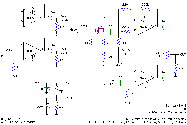

thanks, I was wanting to do something like that would i need to add a buffer at the start and some kind of balance knob at the output?
I would build it with 3 buffers, a simplified version of this:
Splitter-Blend
A single TL074 would be all you need.
Here's a good article that explains the role of the roll off caps, albeit this is for a tube screamer: Fat Mod for the TS-808

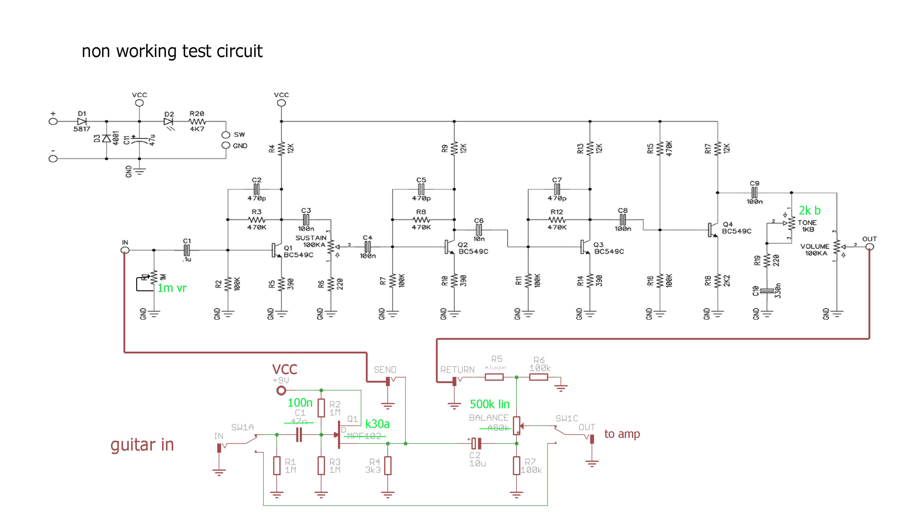

hello , i have been working on this project and am having some problems
i have researched and studied bass amps and band pass for the cap values for a bass version but am working on getting a guitar version working first

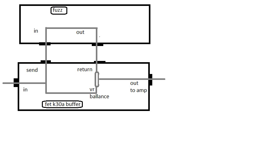

my problem is with sorting a mixer/ blend for the clean sound.i am getting alot of oscillation that varies pitch when i turn any of the knobs. making it almost unusable unless i drop the voltage right down. then i can just avoid the oscillating area on the pots. this leave not much headroom though because i only have 9v battery to start with. ( btw i dont have a scope)
i have studied what i can find for causes and all my leads are short and signal lead are shielded and i have tried a 1meg vr trim pot to varied the impeadance to overdrive stage and still have problem.
i wonder i i have to remove mixer pot and build the yamaha channel audio mixer in other schematic at the end of the circuits?
could someone please take a look and maybe tell why i have this problem please. the changes to original schematics are in green.

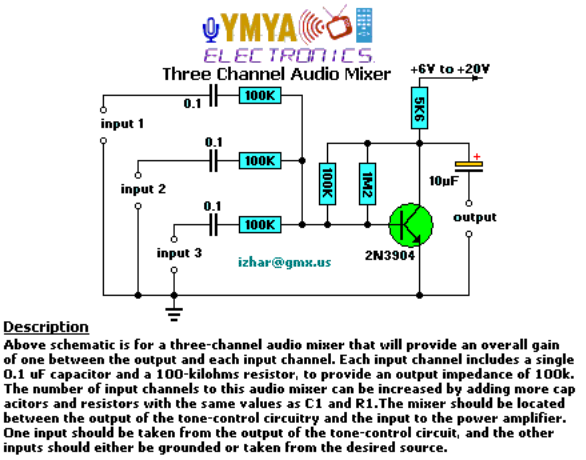

The circuit on the left has four high-gain transistor stages, and your schematic shows all four operating off the same Vcc, without even a decoupling cap to ground. If the actual circuit is built exactly like the schematic, it is a recipe for oscillation problems because of unwanted signal coupling through the Vcc supply line.i have studied what i can find for causes and all my leads are short and signal lead are shielded
At a minimum, try a 0.1uF ceramic cap and a 100 uF electrolytic cap (in parallel), both connected from Vcc to ground, as close as possible to the four transistors in the fuzz circuit.
If the mixer is on a separate PCB, do the same thing for the mixer as well.
You may need to take additional steps beyond this, but try the simple things first - maybe that will solve the problem for you.
There are mistakes in the mixer schematic. First, the 100k resistor between collector and base of the 2N3904 will completely ruin the circuit biasing - add a 0.1uF cap in series with it, so that DC current cannot flow from collector to base.
Second, the 1.2Meg resistor is too big by a factor of about 300%. Perhaps this circuit was originally designed for a higher gain transistor, and the person who substituted a 3904 didn't understand how that would affect bias? At any rate, remove and throw away the 1.2 Meg resistor, and replace it with a 390k or 470k resistor.
Finally, I suggest putting a small capacitor between collector and base of the 2N3904, to control bandwidth. You can use 100pF, 82pF, or 47 pF here.
The mixer should come after the fuzz, not before. Do you have it before the fuzz now?i wonder i i have to remove mixer pot and build the ymya channel audio mixer in other schematic at the end of the circuits?

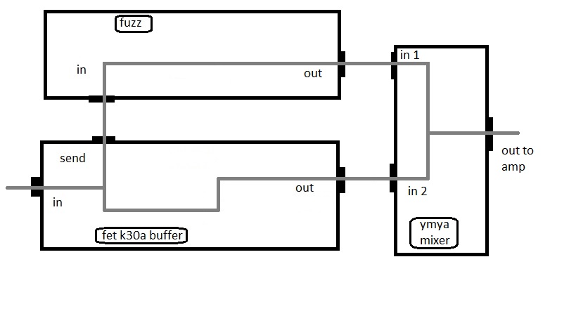

hi Gnobuddy, thanks for all the advice i will try what you have suggested. so far i have only built the block diagram on the left.The mixer should come after the fuzz, not before. Do you have it before the fuzz now?
by saying "removing the the mixer pot" I ment to say "should i remove the balance pot and build the ymya mixer"
I thought the passive balance control may have been causing the oscillations so was going to change the layout to the block diagram picture on the right but may not need to now.
i tried this simple order like normal effect chain just after i posted last post .....
guitar to ____k30a jfet buffer _____ to fuzz ____to amp
..... and still had problem so figured it wasnt the balance pot part of the circuit creating the problem and thought maybe the fuzz was only designed to handle a a passive guitar signal.
will try the sugestions and post the results

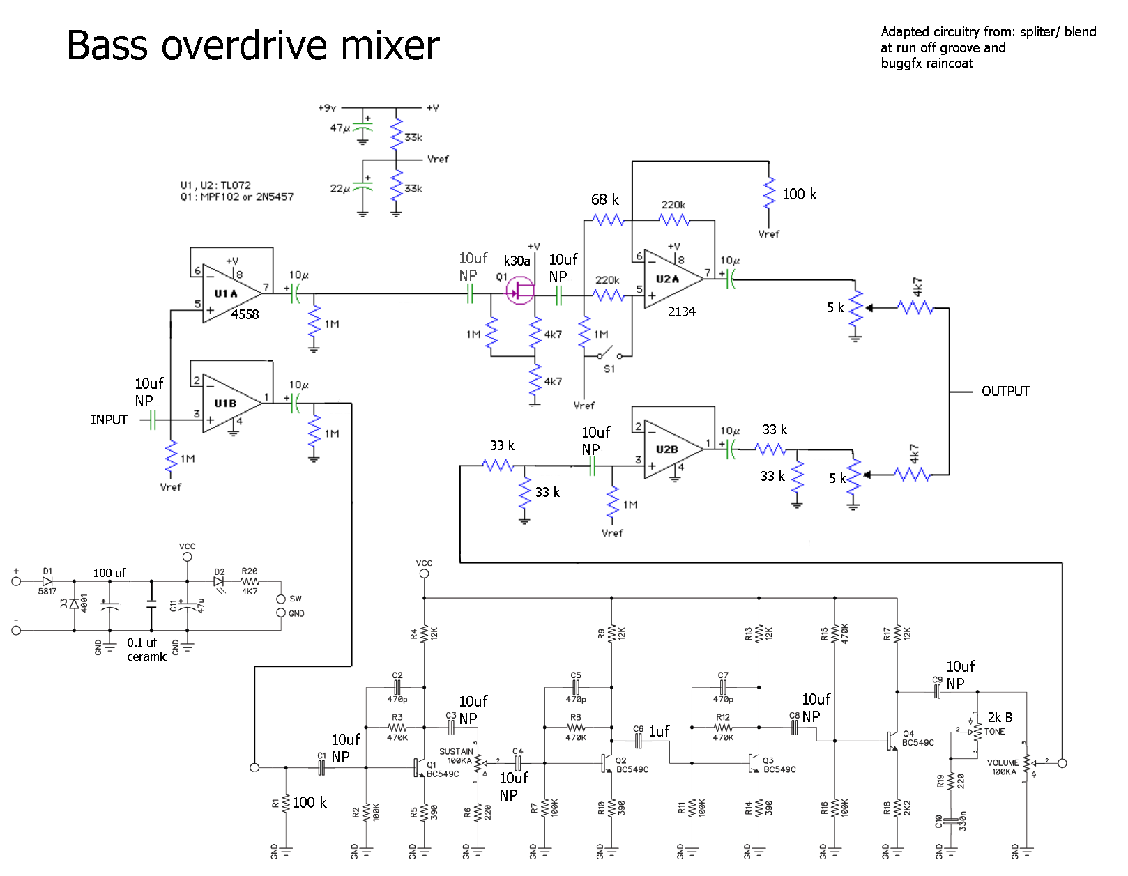

Hi,At a minimum, try a 0.1uF ceramic cap and a 100 uF electrolytic cap (in parallel), both connected from Vcc to ground, as close as possible to the four transistors in the fuzz circuit.
I tried this suggestion and when running
----guitar to ____k30a jfet buffer _____ to fuzz ____to amp ---
and only got oscillations when volume gain pots were at very high settings.
when running
___guitar to ____k30a jfet buffer to ____ fuzz ____ Balance pot______to amp
.............................................\____to pot_____/
I got oscillations at mid range volume gain settings.
Am thinking to replace k30a jfet buffer with the op circuit below and maybe try find a lower gain sub transistor for the first bc549 in the fuzz circuit.
I think it would be good to build op circuit below but with a higher voltage than 9v using +/- power rails and just use a 9 vreg to drop the voltage for the fuzz circuit.
but am not sure how the higher Voltage would effect operating capability of Q1 in the circuit below or if the rest of the design would operate with a higher voltage.
