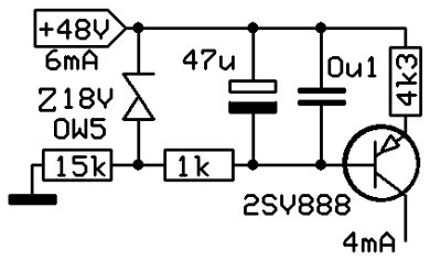

At the moment I'm pondering on how to convert 48V Phantom Power from XLR into a 4mA IEPE supply on BNC cable.
My measurement microphones need a 4mA constant current source (called IEPE or varying on the manufacturer also called ICP, Deltatron, CCP,...) at preferably very very low noise.
I have a very good A/D converter for microphones which provides 48V Phantom Power on 8 channels.
Is there an elegant way of solving my problem? One thought was to reduce the supplying voltage of each channel to 24 V by letting some current pass to ground via Zener diodes. (I guess the Zeners cause unnecessary noise in my curcuit?)
Then I could use a standard JFET current source to power the microphone.
An interesting IC element would also be the LT3092, a programmable CCS which I could use for each channel:
http://www.linear.com/docs/27892
A big concern for me is also that a XLR to BNC connector would short curcuit one of my XLR signal lines to ground causing a 7mA current to be lost and probably cause some unwanted feedback or noise.😱

Did you get to do it? Aco Pacific also has a commercial solution but it would be great to have a DIY solution.
