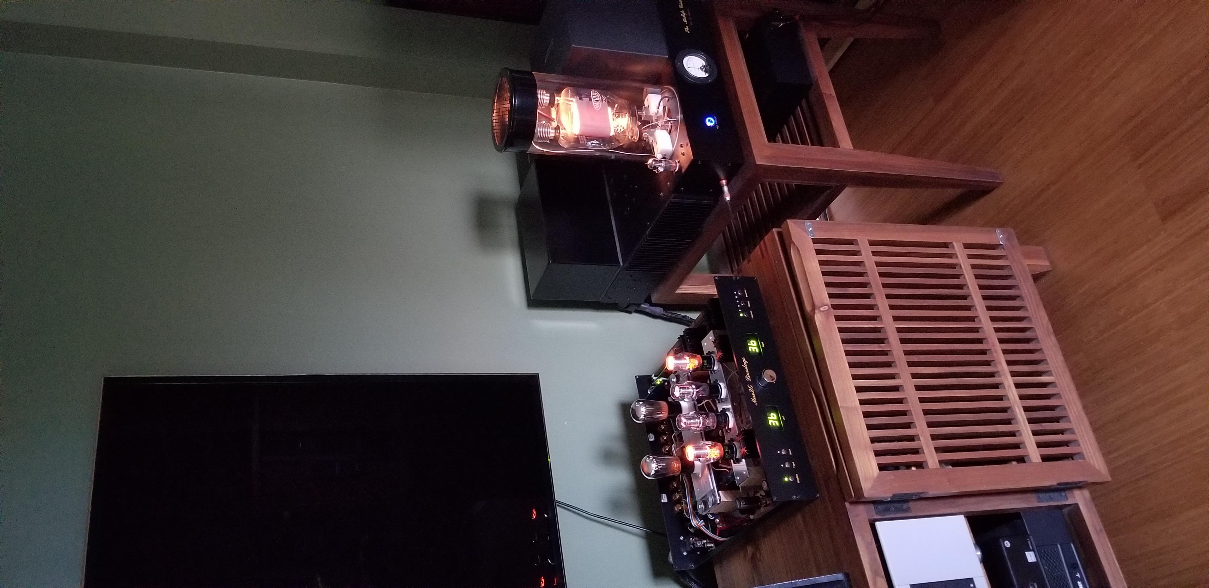

A few pictures. The preamp as first built (picture 2). Topless shot with the new CX-301A tubes (picture 3). The Buffalo IIISE DAC and Sonore USB input boards are in the top right corner of the box. I have a switch on the back to go from DAC (SPDIF or USB) to preamp (5 line inputs).

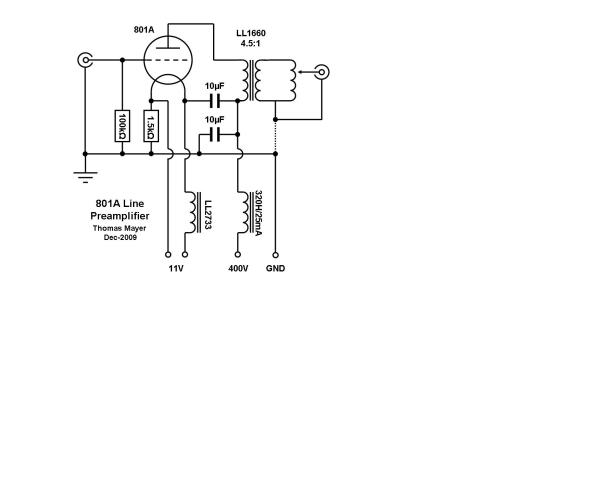

801 as a preamp tube? A bit of overkill, I think. Nice power tube, but I have the 833 to satisfy my amp thorium habit. ;-)
Here’s a basic 801 preamp schema posted by Thomas Mayer some years ago. Has a Lundahl line OPT (step down) with Slagle AVC at the output for volume control..
I'm using a remote control Slagleformer on the preamp output, but instead of an additional OPT before it I just used a cap tuned with the autoformer in parafeed. In effect, the autoformer is the OPT. Works great!
