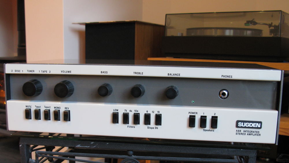

I had my A88 completely overhauled
Hello sorry for the slow reply, but I have just seen this post. There were only 100 A88s manufactured, so we are owners of a very rare amplifier. I bought mine new in 1983. Last year I had it completely overhauled even down to stripping the sticky paint finish abd respraying the case. The company that did the rebuild is AMS, see the pdf attached. Also a picture of the finished item. I an running it with a pair of Tannoy Revolution XT6F speakers which seem to be a perfect match, trimming the bass which can be boomy in some speakers, but allowing the warmth of the midrange and a crisp high end to gel together magnificently. Unless I spent a ridiculous amount of money (which I do not have) I think I have an amplifier that is hard to beat.

Andrew, there were only 100-150 or there abouts as they made on commission for someone in. Nigeria iirc. In end they didnt have money or some such problems ensued. Sugden sold them via normal channels.
It is based on a48 but has double the power and double the class-A so about 80w and 10 in class A.
Anyway both my pots (volume and balance are goosed, the selector switches are on way out and there are no spares) and outside was pretty tired when I got it.
The cost to repair (and there are no spares left for selectors) makes it pointless to go through full refurb route (looking after my autistic wee boy means money is short) and tbh the selectors fail eventually on them all so even if I could afford repair it will likely have issues again. If outside (front panel too) was in good order I'd consider that route.
So I have ordered din socket so I can make up a lead from phono to do socket and will try the power amp section with a meridian 541 as the preamp. If it sounds noticeably better than my crimson the power amp route it is.
May mean if any of you guys have an a88 then I could maybe part with my preamp/selector boards etc if you wanted spares to try and work out a way to refurb them.
Will let you know how test goes hope it'll give me something nice. The a88 to me sounded like an a21 rather than 48 but with lots more balls and bass grip/slam. So hopefully adding a modrnish pre of reasonable quality will give me same sugden sound with maybe even more resolving power then a vintage pre section with very old pots and .
