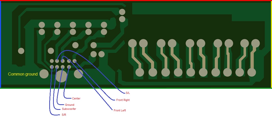

I was given a Sanyo DWM-3500, an older 5.1 surround sound system with a powered sub and a main unit. (I know its not good, but its better than what I have and right now I cant spend money.) I would like to connect my computer to it. The problem is that I am missing the main unit which the sub connects to via a DIN-9pin. Im not sure if its proprietary or if it follows a template/standard, but I want to connect it to 3x TRS 3.5 mm outputs from my computer. How can I determine what each of the pins in the DIN-9 are for, and then how can use that information to figure out how to convert the the 6 channels being output from my computer and what the other 3 are for (just guessing thats how it will work).

I dont want to replace the main unit, I want to bypass it. Sanyo customer support is HORRIBLE too . I would greatly appreciate any / all help! Im pretty handy and I follow directions well too.
Solder on the back of the board six pairs of wires (one signal+ground for each channel) to six RCA female jacks (three pairs). Drill holes for the jacks in the back of the case. One pair will be: Front Left - Front Right, the second S/L - S/R, the third Sub - Center. The 9 pin connector remains disconnected.
The two dots that you left unmarked are the "Mute/Stand By" - probably if you short them you will mute the amp.
Or if you don't plan to use the 9 pin DIN connector ever, just cut the small white connectors and solder them on the female RCA.
From your computer you have the standard 3.5mm stereo jack- red/white RCA cable - three of them. The "surround back" channels (jack) will not be used.

Thank you so much! I had thought of that, but I had no idea if that would work or if it would mess something up. I plan on never using the DIN connector again, so I will solder the wires directly to the RCA ports. I will look up a tutorial on how to do that since im not familiar with it, ive always been a software guy 😛 If you happen to know of one lemme know! Once again, thank you!

The info is in Sonic's post above, what's missing is how to power the amp, for those wishing to use it by itself. He show two rows of solder pads. The first one on the top row is not designated. I'd guess you simply short that unmarked connection to ground. That's how the control box turned on the sub. Any normal switch connects two terminals together, no different here. All the others are the inputs for each channel.
Of course, your own input will control the volume. This amp would run only at full volume, so it could not be used with a cassette deck, for example, that only had straight line-level output.
For my purposes of using the control box as a preamp of sorts, I can use the diagram to follow it to the 9-pin connector and determine wich pins I want to tap into. I needn't worry about powering the sub/amp, it won't be used.

There's no "plug 'n' play" method, you'll have to trace wires and solder connectors one way or another to use the 5.1 audio of either component separately. If the 9-pin connector is a standard type, and we figure out the pinout, a custom set of 3.5 mm plugs could be fitted to it without needing to open the cases. And the same custom cable should work on either the control box or the sub/amp.
