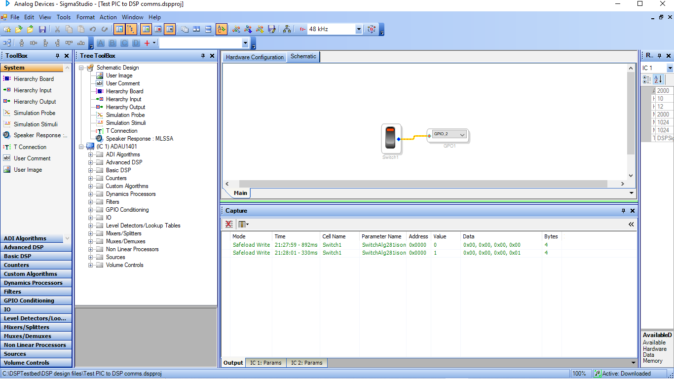

Hi, this is the command as displayed in the capture window of Sigma Studio
Safeload Write Time: 21:02:11 - 104ms IC: IC 1 Cell Name: Switch1 Param Name: SwitchAlg281ison
Param Address: 0x0000 Param Value: 0 Bytes: 4 Param Data: 0x00, 0x00, 0x00, 0x00

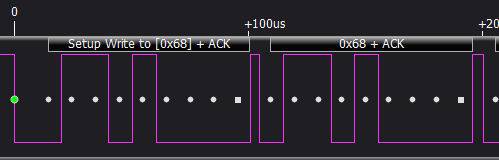

The 0X68 is the I2C address of the ADAU1401. It has to precede each segment of data being sent to the ADAU1401. The screen shot of the data stream that I put on my post is identical for both Sigma Studio and my 16LF1936.

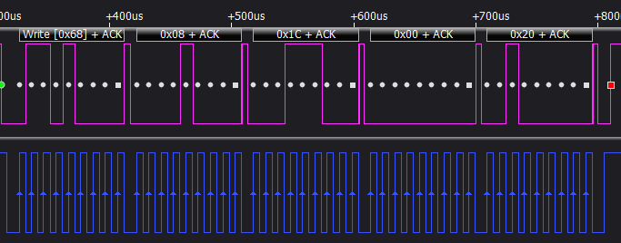

That is correct, 0x68 is the device address.The 0X68 is the I2C address of the ADAU1401. It has to precede each segment of data being sent to the ADAU1401. The screen shot of the data stream that I put on my post is identical for both Sigma Studio and my 16LF1936.
So the register address is 0x0000 and the data is 0x00000000 or 0x00000001 according to the screenshot you posted.Param Address: 0x0000 Param Value: 0 Bytes: 4 Param Data: 0x00, 0x00, 0x00, 0x00
That means transaction should look like this:
START 0x68, 0x00, 0x00, 0x00, 0x00, 0x00, 0x00, 0x00, 0x00/0x01 STOP
What you show in first post looks more like this:
START 0x68, 0x68, 0x00, 0x00, 0x00, 0x00, 0x00, 0x00, 0x00, 0x00/0x01 STOP
Which does not look right.
Hi, I've looked at that screenshot again. If you look carefully, it is 0X68 followed by 0X08.
I don't blame you for not seeing that, the screenshot is not very clear.

As you can see from the subsequent screenshot I have set up a very simple test design.
This is just so that I can attempt to control a self bootload program via the I2C control port.
I see 2x 0x68 and then 0x08. What is the register address you are trying to write in this transaction?

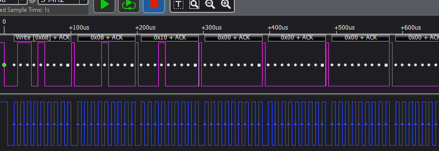

So right now the ADAU1401 ACK's every piece of data I send to the safeload addresses but when I send the IST command
nothing happens.
Please note that this is not the full data stream..

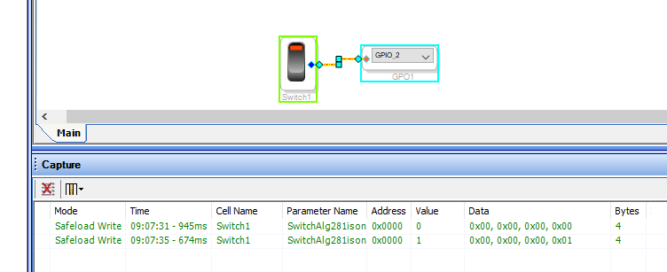

This is my test circuit, it turns a LED attached to GPIO2 on and off.
It is loaded into EEPROM and autoboots at power up.
It works fine when connected to Sigma Studio, but not when connected to the PIC chip.
The I2C traffic is identical.... I'm hoping its a case of not being able to see what's in front of my nose-itis..

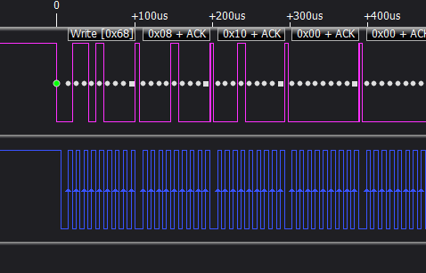

Forget about safeload for now. Just do the transaction that is shown in the sigmastudio log, which is:
START 0x68, 0x00, 0x00, 0x00, 0x00, 0x00, 0x00/0x01 STOP
Hi there that is an instruction to turn on cell switch1.. In this test design it simply turns on the LED attached to gpio2.. Sending just that string whether the last byte is 0X00 or 0X01 turns the LED on. I cannot turn it off again.

Hi there, eclipsevl...
My data stream was 1 byte too long,, the value to turn the LED on was 0 and to turn it off was 1..
With the string being too long it never saw the off value... So now I have even more to think about....
Like why 'safeload' doesn't work for me....
