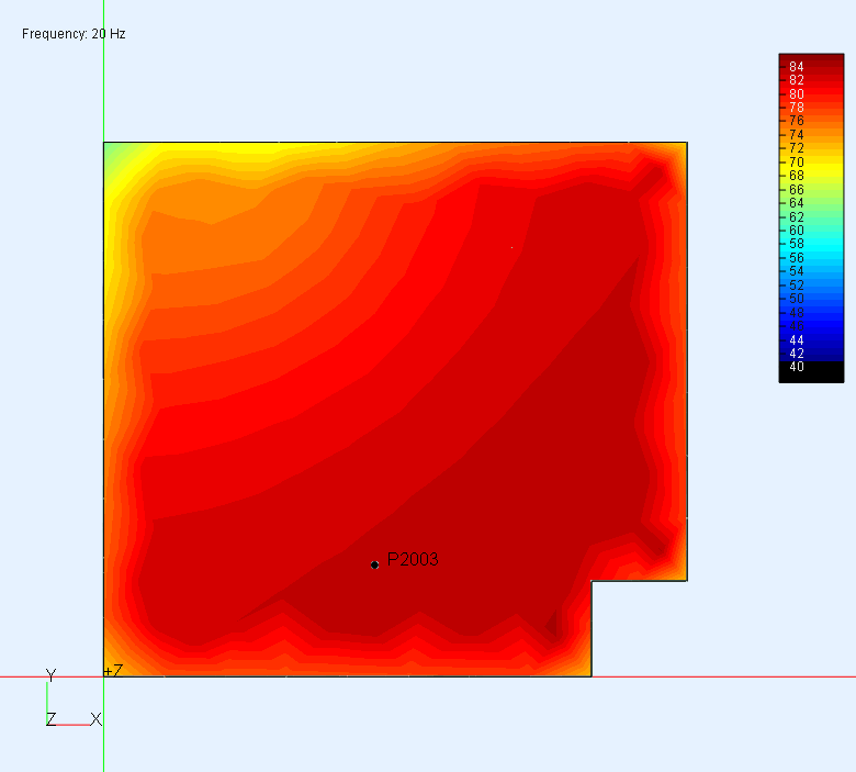

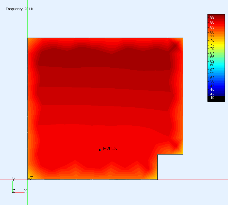

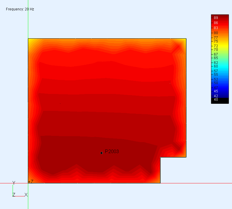

Using a single subwoofer in the top left , these are the field patterns generated for this particular room. All subs have BW4@80Hz LP filters.
What was the benefit for 2 extra subs.?
[Pic1] shows the FR at the listening position. The CABS SPL is lower (-3dB) because there is destructive interference at the back wall. It's also a more even response, as would be expected by distributing subwoofers around the room.

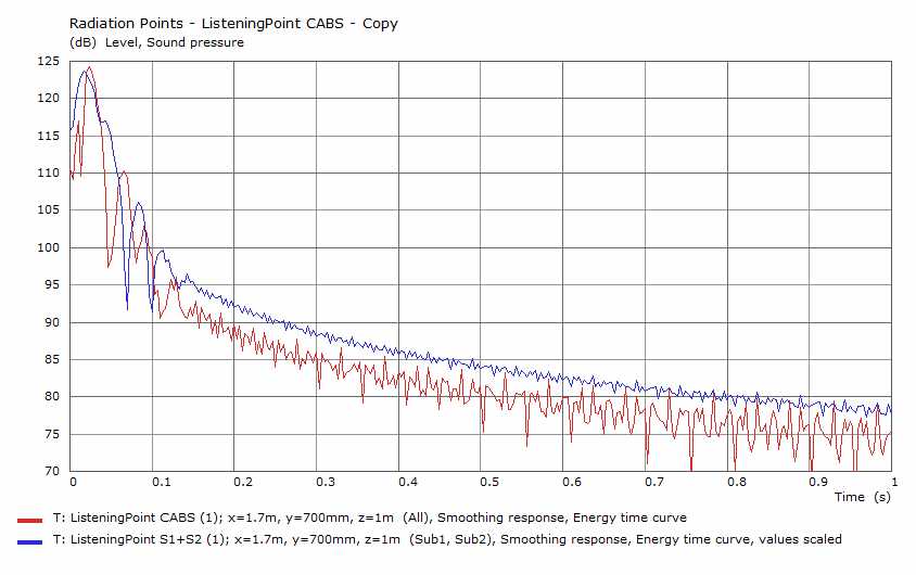

[Pic2] shows the ETC decay time. I have shifted the "2 sub" curve down -3dB so that both curves start at the same level. It does not look like a big difference but for a particular level (horizontal line) there is significantly reduced decay time. As an example, the decay from ~125dB down to 90dB takes 0.15s for CABS and 0.25s for 2 subs.
