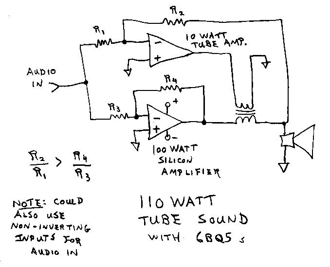

You don't need a DSP for the power supply control, just use a conventional SS amp connected in series with the output of a tube amp. The feedback for the tube amp comes off the combined sum then (by special design, and special OT) so as to produce overall tube sound using only a few tube Watts. It is effectively a class G or H amplifier then.
Image from an old thread: (and another oldee image for paralleling tube + SS to unload the tube amp, using a high Zout, current output SS amp)

You don't need a DSP for the power supply control, just use a conventional SS amp connected in series with the output of a tube amp.....as to produce overall tube sound using only a few tube Watts. It is effectively a class G or H amplifier then.
I tried the circuit in your top schematic when you first posted it. I could never get it to work. The SS amp (I used a LM3886 chip) overpowered the output impedance of the tube amp. I never tried to really work on it though.
I now believe that it is possible to build a simple agile SMPS without a DSP, but the whole purpose of the design contest that provoked the amp in the first place was to find new and unique applications for Microchip's new dsPIC chips that were optimized for SMPS power supply use.

"I tried the circuit in your top schematic when you first posted it. I could never get it to work. The SS amp (I used a LM3886 chip) overpowered the output impedance of the tube amp. I never tried to really work on it though."
If the tube amp is lower power than the SS amp you have to use an OT with a lower output Z than the usual 8 Ohms. Basically the tube amp only contributes a fraction of the total output voltage at the same current when connected in series, so you can figure the secondary impedance (versus 8 Ohm) from the Watts ratio required. Typically the secondary will be under an Ohm, so the effective OT primary/secondary ratio is higher than normal, which then makes it a lot easier for the tubes to drive.
