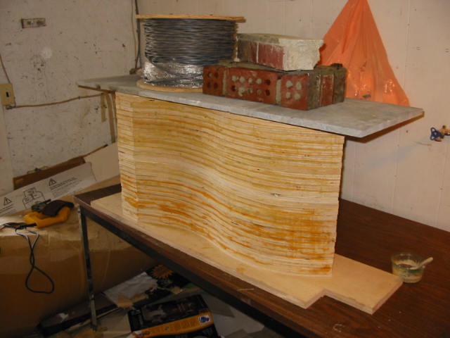

Hello, I have been thinking of taking MDF, cutting the sheets down into the shape of a "C" and sandwiching (stacking) them together using glue and high pressure. This way I can create something with more curves to it. I have seen pictures of this done by others and there seems to be a trend of leaving the face open and adding a baffle. Does anyone know why I should or shouldn't cut my MDF into the shape of a "D" rather then a "C" and eliminate the need to add the baffle. I could just cut my openings out of the face of the "D" shaped enclosure.
Hope this makes sense. Thanks
No reason why not and this is what I have seen as being more common than a C shape. Are you planning to paint or veneer the result?

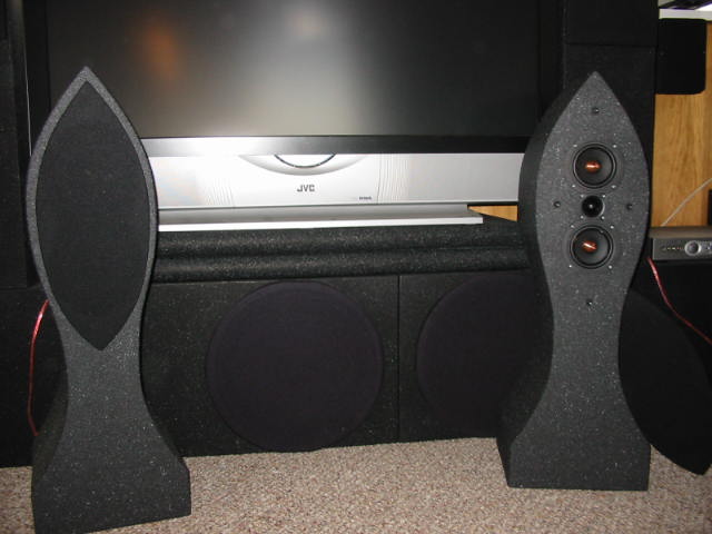

Whats the finish on those speakers? And do u find that the undulations of the interior walls effect the sound positively or negatively. Nice looking subs btw.
Finish: Accents by Rust-Oleum | Stone Creations - Black Granite | Home Depot Canada
Undulations are there to help with standing waves.
Those subs are actually 15" Selenium Coaxials. They are for party time only. I have them on the floor so if you are close to them your ears don't start bleeding. The subs are off to the right.

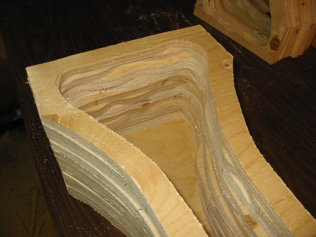

I can think of one reason: You will have to drill into the edge of the MDF to mount the driver, which carries a risk of splitting it....Does anyone know why I should or shouldn't cut my MDF into the shape of a "D" rather then a "C" and eliminate the need to add the baffle. I could just cut my openings out of the face of the "D" shaped enclosure...
