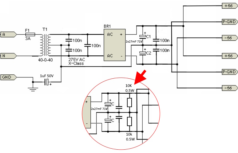

I also have a question about the power supply.
I drew a diagram of the power supply I have.
It's not what I plan to build, but what I salvaged from my broken amplifier.
I compared it to the power supply diagram provided by Rod and noticed that there are no components to discharge the two 27mF capacitors after the device is completely turned off.
I'm not sure if this is useful, or if the capacitors will discharge ‘naturally’ in all the device's circuits when it is turned off.
If it is useful or necessary, I was thinking of adding two 10kOhms 0.5W resistors (see image).
What do you think ?

This is not trivial, since 50V or more is considered potentially fatal, and those big caps hold a lot of charge.
These resistors just help drain the large caps when the amp is turned off. At 56V a 10K resistor draws 5.6mA. And 5.6mA at 56V = .3136W. So yes, .5W is cutting it a little close. Alternatively, a 22K resistor would work as well. It drops the wattage to .1423W so a .5W resistor would be fine. But the time it takes to discharge your caps double.
No need for despair as the MOSFETs under normal idle current drains the caps withing a few seconds when the amp is turned off. A resistor across a cap is merely a safety feature when you tinker. 🙂
I like to add a LED is series with the resistor. Adds a visual reminder that the caps are still charged.
