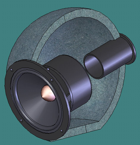

Hi all,
I am designing a set of small BR bookshelf speakers using a full range driver, and I'm looking into how to go about constructing spherical cabinets for them. My initial thoughts is printing out a shell using a part printer I have at school (can print parts up to 30cm*30cm*30cm IIRC), but the printer material is not suited for speaker enclosure.. So I can either dress a thin shell with layers of fiberglass, or I can use it to cast a silicon mold. The latter would perhaps provide the better result, but I have never tried something like this.. Any tips of techniques or molding material from anyone who has good ideas or has gone down this route in the past?

There is an extensive thread here about a spherical woofer.
Keep in mind that the outside of a sphere is great for minimal diffraction, but quite ugly inside for resonance.

how about fibreglass over a cheap plastic football ?
Or using the inside of the football as a mould ?

I think styrofoam spheres will be the thing. I plan to intersect it with two planes (cut it) one on the bottom side, and one at the speaker mount. After that, I'll cover them in epoxy and fiberglass or something similar... continue in layers for about a cm, then sand and smooth it, using a planar sander on the bottom side, and finally drill holes for port and driver, and pour acetone in it...
Now, if I could only find styrofoam spheres of the right size... 23-25cm diameter..
EDIT: I mocked up the translation here I think... I wasn't referring to styrofoam, but something we call "isopor" here in norway.. Clue translates it to "expanded polyester". The stuff the chips you put in boxes when shipping triodes are made of..
one more vote for one of those cheesy soccerballs you used to get when you were a kid to play in the pool with. usually smooth plastic with a soccer ball pattern printed on it. after you coudl just deflate it to take it out.
xstephanx said:one more vote for one of those cheesy soccerballs you used to get when you were a kid to play in the pool with. usually smooth plastic with a soccer ball pattern printed on it. after you coudl just deflate it to take it out.
Problem will be the planar surfaces... How would you guys do that with a soccer ball..?
It would be doable with the ball... it could be constructed as a sphere, then sanded down the planar surfaces and reinforced with more fiberglass from the inside after the driver hole is opened.. I might give it a try if I can't find what I need in any of the local hobby stores.
for the holes glue a couple of plastic or carboard rings
on the ball, e.g. short sections of 4" PVC waste piping.
🙂sreten.

I think the spheres introduces a whole new set of problems.. Not so much the construction itself, which I believe will be feasible enough, but doing the inside right, as Dave pointed out in the 2nd posting.. Port placement, etc.

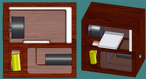

Also, since I'm designing for someone else (a birthday gift to my sister), I don't have the opportunity to tweak and listen over a long period, especially not in the apartment where she will be using them, so I believe it is safer to take the rectangular frontplate with all its flaws, and correct them as best can be done. As yet another point, the spheres started to look kind of stupid as I increased volume to my needs, with the tiny FR125S driver looking way to small for the fat spheres.. And I wouldn't sacrifice performance to make'em look good either. In other words; my spheres is canceled.. for now at least.
I'll move this discussion back to the fullrange forum where it came from , thanks for the tips though, I'll definitly build some spheres on another occasion.
Svante; The intention was (still is but in a regular box) a fullrange driver (CSS FR125S) with no tweeter. Interresting remark you made though. I'll make sure I never try that stunt with a tweeter
Anyways, I believe something like this will work far better than what I can do with the inside of a sphere.. :
