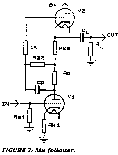

This little bit of work led me to look at a constant current draw pair. Here is the diagram:
The idea here is that since both tubes are at the same operating point, but their currents are 180d out of phase, their demands on the PS will cancel. And, therefore, they can share a common Rk which won't need much, if any, bypass. Since the output is a follower you still get low Zo.
First, the distortion comparison to the tube ccs device:
This is as expected, because, although the pair of tubes is constant current, each tube still sees a load resistor and doesn't get the benefit of a CCS load. So the distortion is higher than for the pure CCS device.
Now we may ask, does this device's PS current requirements differ from the mu follower for the same load? Here it is at 100K load. I've taken the fourier transform and am showing the current amplitude at 1KHz. Ck=10u.
So, from the PS point of view the current draw should be nearly identical. However, the mu follower needs 100 extra volts on the PS while the constant current pair needs twice the idle current. Also, the mu follower doesn't depend on the tubes being in balance (which they usually aren't).

The Zo of the constant current pair is about 80R. The tube mu follower has about 135R.
So, the only distinguishing feature of a real CCS loaded device compared to what could be done with a constant current draw pair is the level of distortion. Assuming that a real triode performs the way the models do, then this difference might be enough to choose the CCS loaded amplifier. ANd, of course, the need for some balance in the tubes for the constant current pair.
I guess the PS trade-off depends on what you like to do, supply current or supply voltage.
What about the frequency response? If we set Ck=10u for both stages and if we normalize the output, we get:
If we set Ck=0 we get:
For Ck=0 the curves are nearly identical. Even for Ck=10u they are very close. (I realize that I haven't normalized the outputs precisely, but they're close enough).
Some caveats again. This is simulation and these are perfect Rs and Cs. Also, I've only explored a few possibilities. There are many others, but I think these get the ideas across. At least, this helped me to see what's going on.
