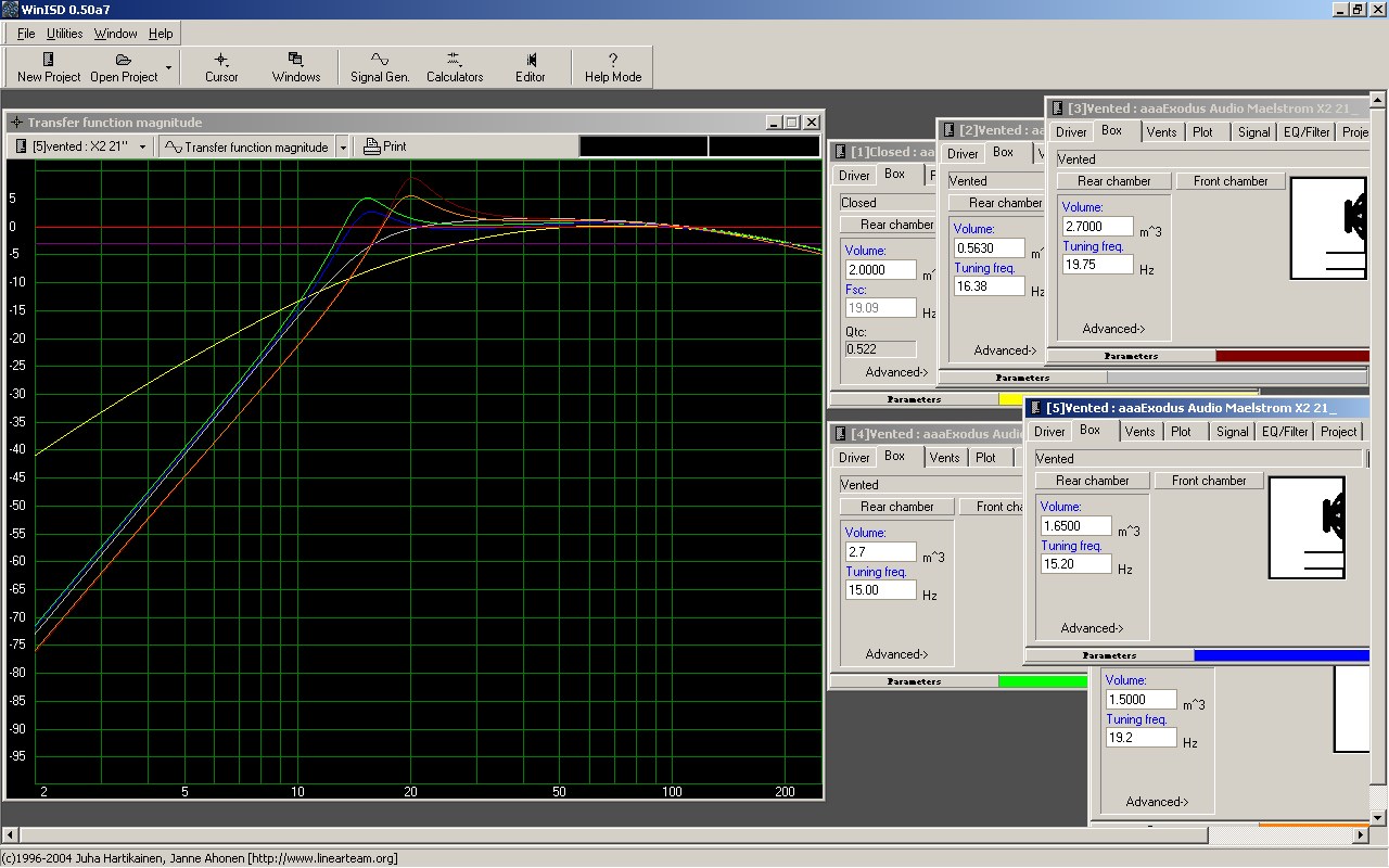

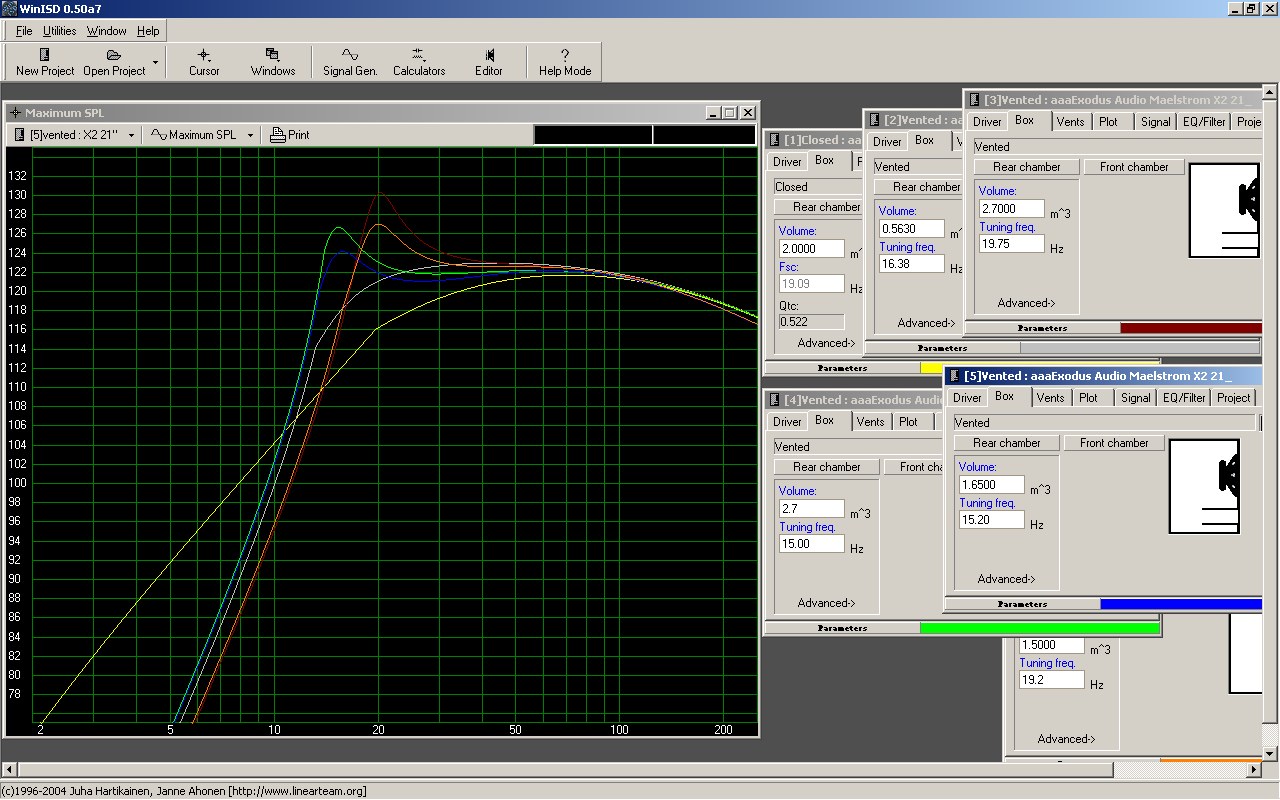

Here's what I've got so far after doing a bender till 7am morning of twiddling and starting all over again.... 😀
all 20deg ambient with 40 degree rise and 1500w in
yellow 2m3 sealed love the rolloff
grey 0.5m3 WAF proof (as much as a 21" woofer can be waf proof lol) 2"x20" x14" deep port good compromise sub? perhaps more retail dimensions lol
red 2.7m3 non-WAF approved 2x12" x7.54" deep ports to reduce chuffing (is this enough?) and my favourite high output so far...
green a tradeoff but damn flat, low chuff with dual 12" ports and nice 108db 10hz
blue is a green setup tradeoff smaller ports 2x8"x14" deep and box
orange 1.5m3 19.2hz tuning 16" x16" deep port not a bad compromise either
attachment.php
I have stumbled upon a set of curves i'd forgotten a long time ago.. the 'equal loudness curves' http://upload.wikimedia.org/wikipedia/commons/thumb/4/47/Lindos1.svg/2000px-Lindos1.svg.png which reckon for 100 phon reference in mid to low range its pretty flat till 100hz which it gradually increases till when you need about 128-130 db @ 20hz to keep up, vastly more db required than at 300hz.... so as far as I understand and hear on mine and other rigs.... once you approach under 30-40hz it appears to drop off even though everything is rattling, to compensate you need a metric crap-tonne of spl to get a percieved flat response. So if I rigidly stick with a flat response on paper I get a percieved dropoff in sound volume even though it's 'flat', which sure as hell isn't what I'm looking for, I want it to sound flat to me, not a graph. I'm guessing this is one of the reasons why the sub has been designed with a 16hz fs.
ANyone have any comments or feedback on especially the equal loudness curve and has anyone else designed around it. I understand it is an average and may be different to me but it's a good start for now.
However, will tuning it so peaky (dark red line) make it sound rubbish down low around 25-20hz? And yes I am expecting the room to screw up any decent build hehehe.... digital eq correction? Whats the lowest noise approach? Seen velodyne controllers around which can tune to room and adjust, any hints on these or other types?
I notice cone excursion appears to go over 60mm around 10hz on most setups, is this just winisd not modeling it properly or what will actually happen (aka it pops @ 1500w rated at 5hz????)?
Have checked out the Beyma and B&C drivers... nice drivers (love the waterproofing too!) but they don't deliver the goods for what I'm seeking - orchestra/drum kit reference spl when occasionally needed. I really want this sub for overhead, not destroying eardrums and as good sound as it comes. I will keep em [other drivers] in my mind should a diy main speaker ever come to fruition 🙂
Porting wise.. down or front or back or sideways? Will downfiring dissipate more into the ground thus creating better infrasonic response? What's cleanest sounding usually? Or does it not really matter which way with such a setup...? Have looked into PRs but cant get the numbers I seek from them... unusual things but cool.. seen some pretty crazy subs with them. One I think was about 2m high, stuck in a 30something floor penthouse apartment of course, 22" PR with like 9 woofers driving it hehe.

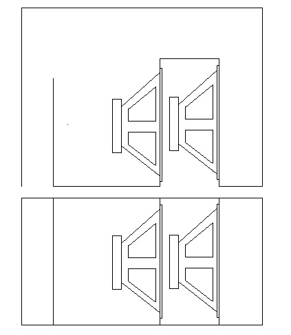

I'd also look at using two drivers in a PPSL enclosure (a la djk), as that may (very likely) prove superior to one large driver due to the several advantages listed:
High Efficiency Speaker Asylum: PPSL by djk
And here's a picture:
http://www.diyaudio.com/forums/atta...c-clamshell-vs-push-pull-slot-loaded-ppsl.jpg

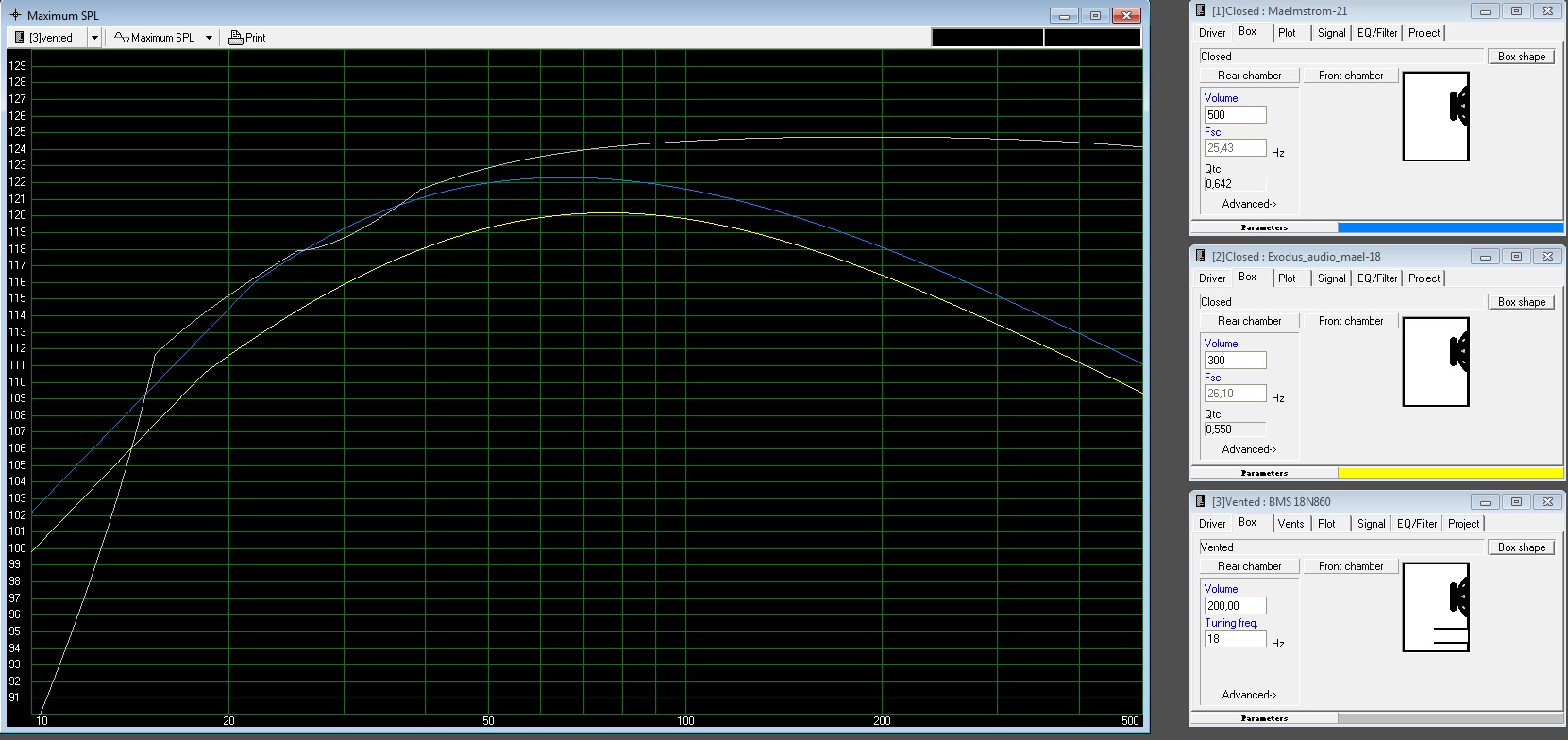

You may also consider 1-2x BMS 18N860 subwoofers. Their motor is very linear and has good technology to prevent distortion and sandwich voice coil and efficient ventilation to reduce power compression. The motor and suspension is quiet up to fairly long excursions. BMS's woofers have very low inductance (due to triple shorting rings) which is good for transient response and extension of the freq response. You may also appreciate their weight due to neodium magnet system.
I use four of 18N860s along with four 18S430v2s in dipole line array subs. The bass has nice attack and decay. They are usable to lower mids, 6dB/oct low pass is no problem. The higher you set the crossover point, the better the slam will be. 🙂
I shot some excursion videos of BMS's woofers: YouTube - Lasse84's Channel . Note that woofers are in dipole configuration, which reduces the efficiency of 20Hz 10-fold (20dB) compared to the bass reflex enclosure and also does not cover any noises that motor and suspension creates. I should also note that in "20Hz video" 1# and 2# the amp (= EAW CAZ 1400) clipped and limited the the excursion because I drove two woofers with it. In the 20Hz 3# the (single) woofer reached it's suspension limited excursion (approx. +/- 30mm).
18N860s also fits in a bass reflex enclosures in contrast to Maels, which like to reside in closed enclosure due to EBP-factor [Fs divided with Qes] being below 50.
Here's simulation of 860 in BR and 21&18 inch Maels in closed boxes. 860 is simulated with "safe" +/- 19mm xmax.

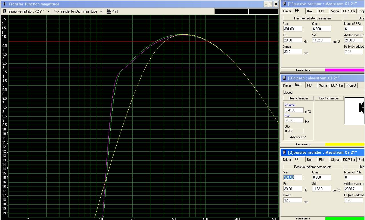

transfer
Sorry forgot to post transfer function and I can't edit the last post because it appears to be trial by fire for the n00bs like me, not that it's a bad idea either. :flame:
It would appear to likely need an eq to lower the 30-40hz range a little as is to remain flat perceptively if that's the right track.. see how the room does things first.

The grey curve looks good. Remember, the room is going to change the response more than anything else, and you'll get a rise on the low end from room gain. Make sure your port velocity is less than 17 m/s (the lower the better) at maximum power at any frequency, and be sure to flare both ends. Follow standard design guidelines. Some stuffing uniformly distributed throughout the box (but not allowed to get into the coil gap) will be beneficial.
EDIT: Haven't run your numbers myself but some of those curves look like they might have audible group delay.

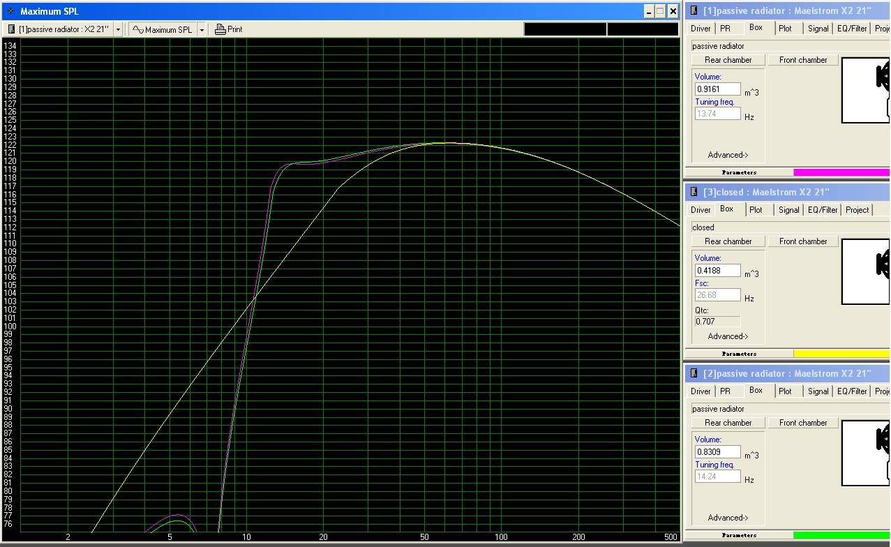

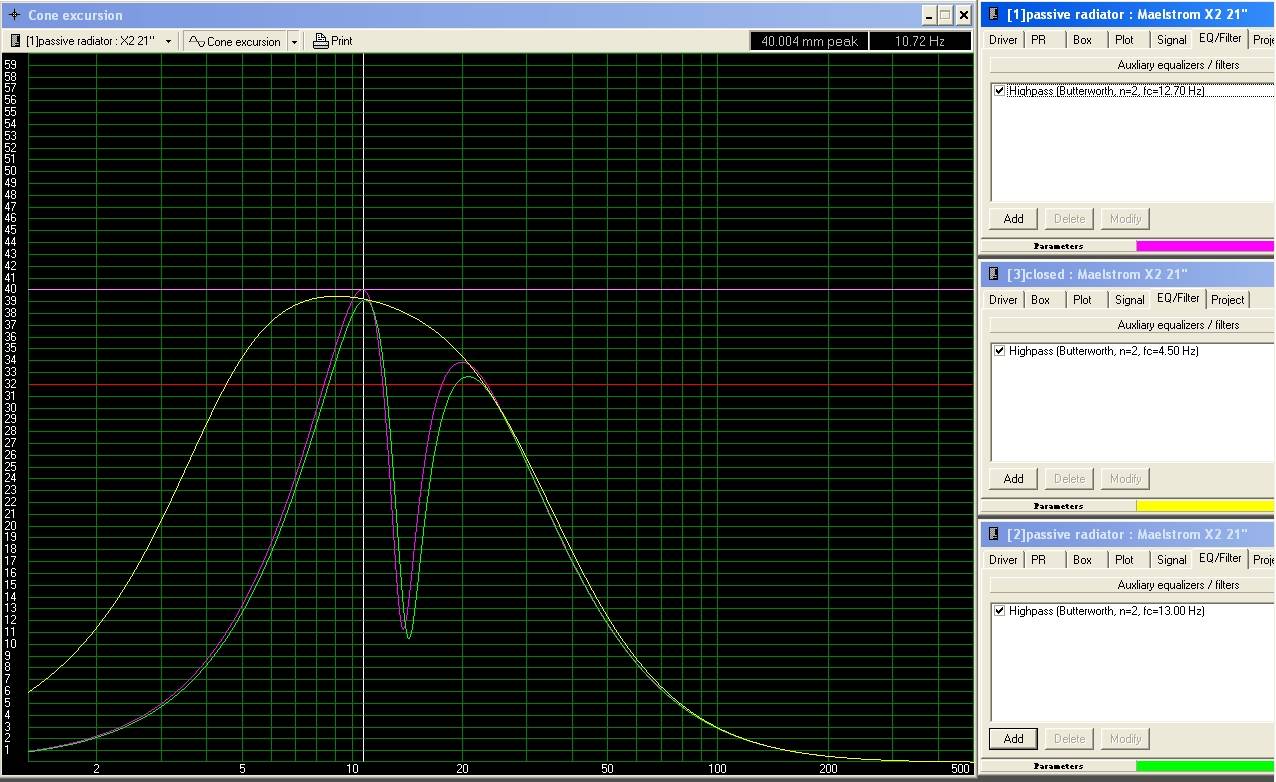

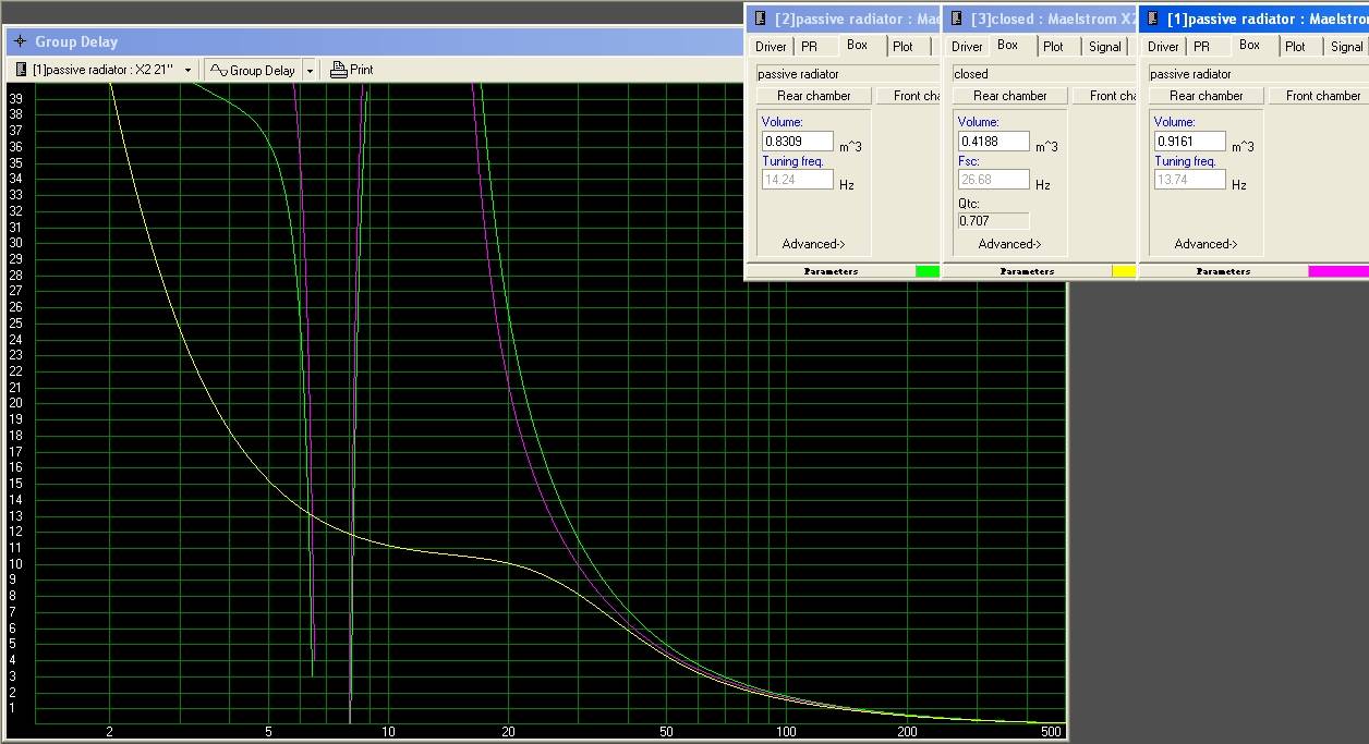

Anyway been working on these last two to three nights till very late am 🙂 so let me know what you guys think.
Sealed is probably the way to go @ qtc .707 .418m3 however PR seems to have some impressive and relatively clean numbers with added cost of twice the box size and 300+ usd cost.
Still thinking about amps, I have a feeling that's going to be the hardest decision as I'm trying to avoid going cheap pro amp..
Transfer function phase is pretty much identical 150-20hz
And lastly I must thank everyone on this thread and forum for the little tidbits of info which have helped me greatly in my quest for ultimate bass 🙂

What constitutes audible to you? I've heard some say sub bass group delay is not really audible but I highly doubt this (and scientific papers confirm this), it's probably one of the things sound characterisitics that put me off ported setups usually.
Group delay audibility is relative to frequency, with greater delay more tolerable as frequency goes down. I don't think there are any hard numbers to go by, but if there are any sharp spikes in group delay in the passband it could be audible.
