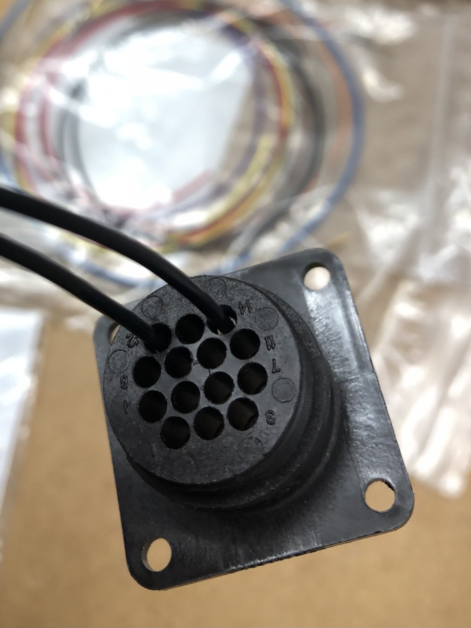

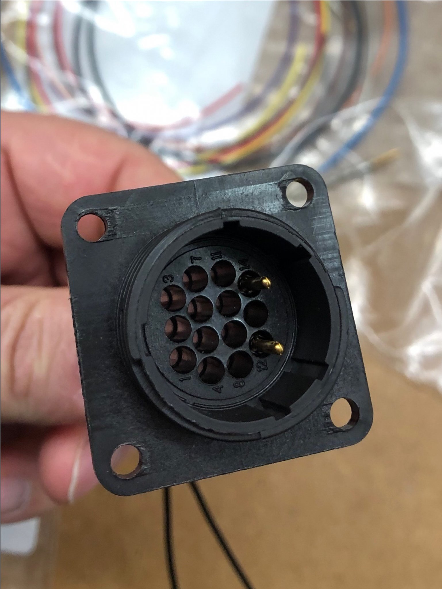

From all those connectors (and I used them all) probably the best connector system is the TE Connectivity AMP CPC Series 1.
Not the cheapest though.
Pins in the connectors are automatically isolated from each other by inserting them into holes, so no shrink wrapping needed and the quality of the crimp/solder can be easily inspected prior inserting into the connector.
Pins can get removed very easily with the pin removal tool Mouser #801-R5926, makes it very easy to change or add later additional wires.
Different pins are available for different size wires and wire isolation thickness (if you prefer to crimp), also different material (gold, tin), male and female, for crimping and soldering as well. Being able to do high voltage as well.
Check the catalog (attached) as there are different Series with sizes and number of pins available.
Use on the PSU chassis side female pins (no exposed pins to touch) and use male pins on the amp side chassis connector.
Can't reverse the cable as well.
