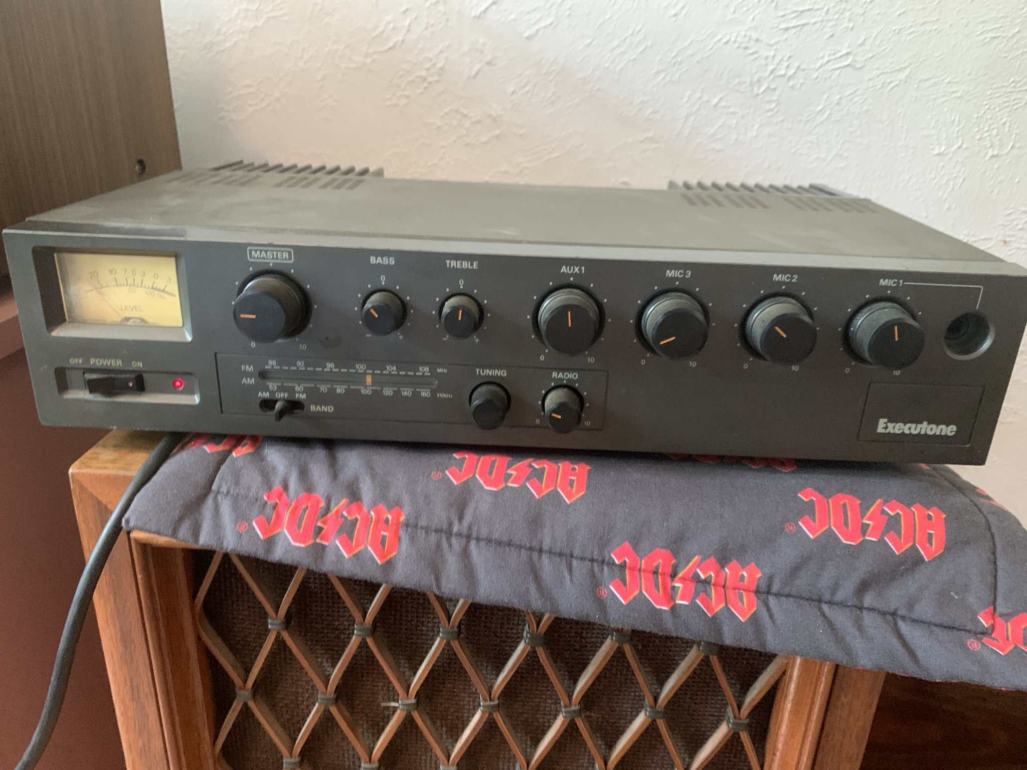

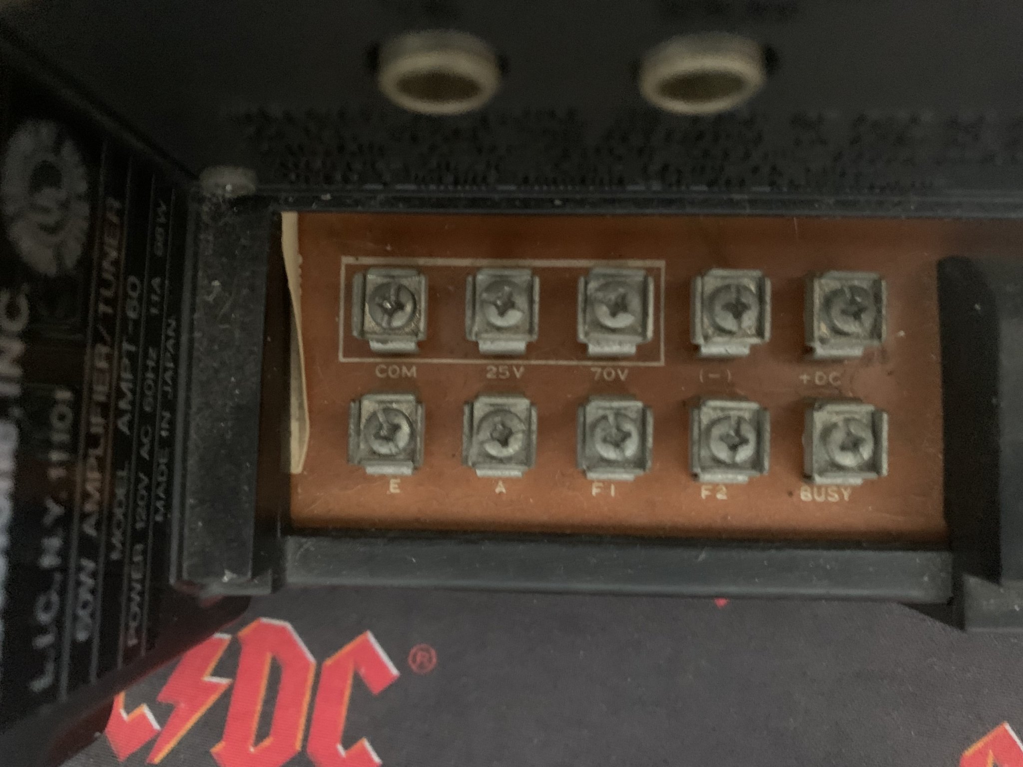

I am trying to figure out if this salvaged Executone AMPT-60 PA receiver is in working order. It powers up fine, but I don't know how the correct way to connect speakers to the the unit. I can't find any schematics on it. There are 1/4" connectors on the back, and also 10 terminals. They are labeled {COM, 20V, 70V}, (-), +DC, A, E, F1, F2, BUSY. The first three are all in a specifically marked box for grouping.
The unit seems to be a 60W amplifier.
I hope to connect this to speakers and see if the radio works.

This is a PA amplifier designed for use in a factory or warehouse to power 70V line speakers, thus minimising the power loss over large distances.

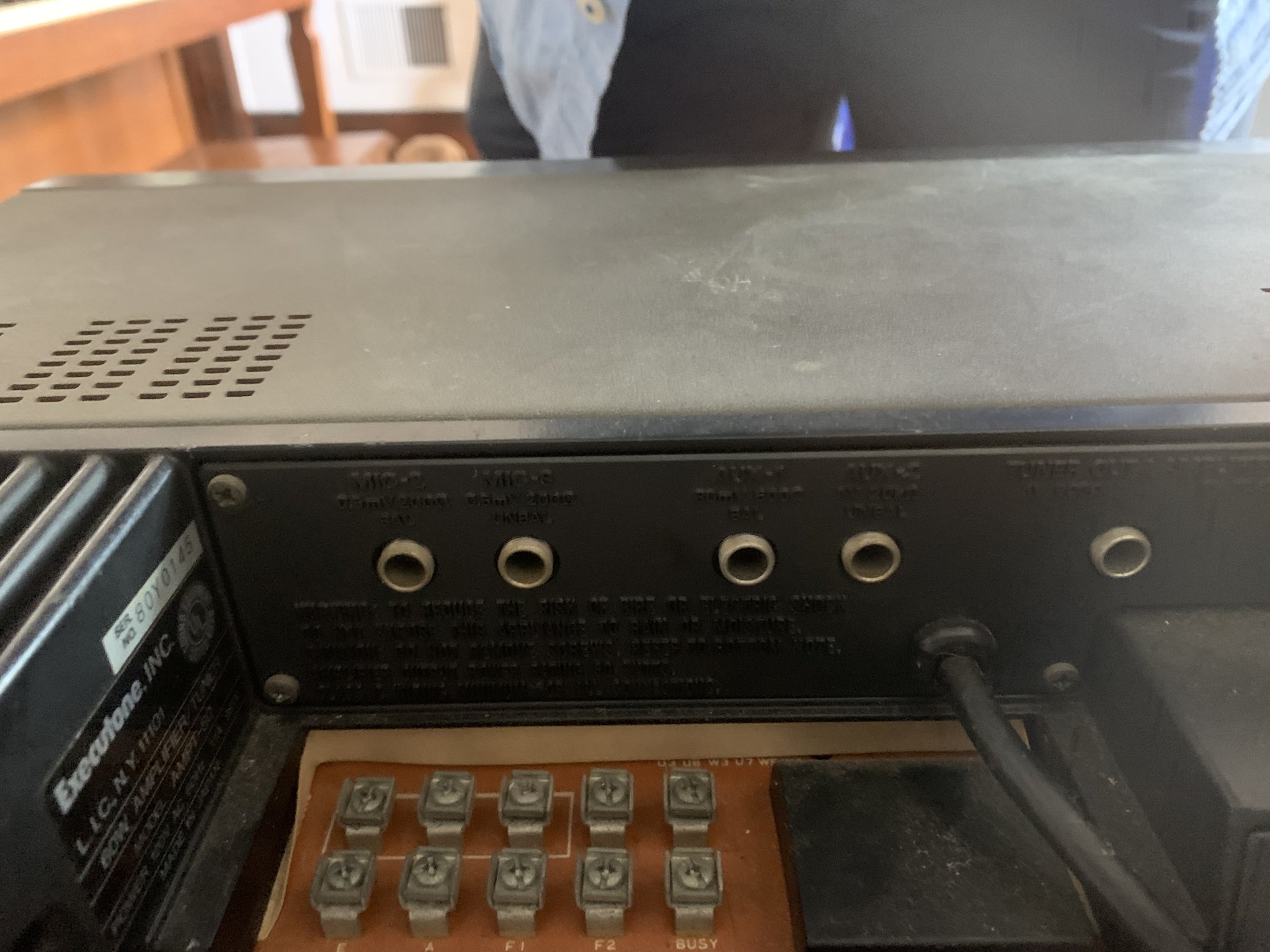

The four left hand jack sockets are inputs for microphones and an aux socket. The fifth one at the right says "tuner output" - tell us what the rest of the writing on that output says.

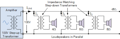

FYI A PA amplifier like this has a step-up voltage transformer at the output - see diagram.
Sometimes there is an internal, unused tap for 4 or 8 ohm which close internal inspection may reveal. Post photos.

It is possible there is no voltage step-up transformer in the amplifier and that the output circuit drives the 25 V or 70 V line directly.
In that case, an 8 ohm speaker would require the addition of a step-down transformer.
simon7000 says that you "should" be able to connect an 8 ohm speaker direct to the 25 V line, but I should like to be convinced of that.

It is a 60 W amplifier.
Taking V = 25 V and P = 60 W, we can use R = V^2/P to discover that we have a 10.4 ohm line.
By that measure, simon7000's suggestion should indeed work.
I think it should be mentioned you can add a 100/70V audio transformer to any regular speaker if it doesn't fit any of the output voltages or level you're dealing with. For HIFI use it's also worth mentioning you won't find any stereo 100/70V amplifiers since you will not have any stereo perception while moving through a high voltage PA sound reinforced areas. It's made to have very low power loss over very long distances, which makes the requirements of very high power (most of which will be wasted over the long distances lines resistance) and make the long distance cables a lot less expensive. Think about big buildings, ski piste or large area covering PA (stadiums, exposure events, sport events etc).
Yes, 70 V in the OP's case. Like this one for $6 : https://www.parts-express.com/70V-10W-Line-Matching-Transformer-300-040?quantity=1

After losjng my CS800s, PV-4c amps & 2200 LP & 200 CD to theft, I bought a couple of MMA-875t for $25 and $40. 75 watt warehouse amps. <0.5% THD 20-20000 hz. They work fine on the 25 v output into 8 ohms. $5 the pair 3 way speakers (6" woofer) replaced the SP2-XT psir & 1210 pair that were hauled off in a Jeep Cherokee. One amp for LP & CD in the music room, one for the HDTV and PC sound in the dining room. WIth the RCA jack mixer cards, they can mix stereo down to monaural. One cool feature, if you do use the output transformer, an output transistor meltdown can never damage your $3 speaker.Or in other words, an average guy doesn't have the need for a 70/100V amplifier. It's very specialized and doesn't meet the most requirements of a HiFi enthusiast.
