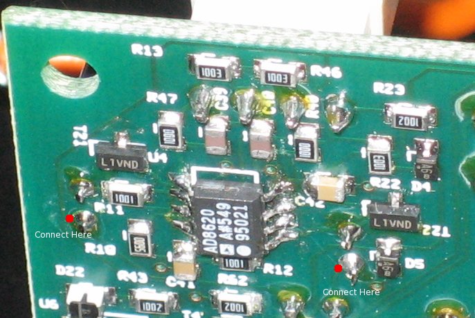

I am gearing up for fully active loudspeakers. Shortly, I will be posting crossover pcb, +/-12 v power supply pcb, project writeup, etc.
The next step will be to put the crossover circuit board and ucd amp in one box. I have a spot for adjustable gain on the crossover, so I can jack it up to 5, and hopefully connect the output directly to the UCD, bypassing the op amps. The OPA2134 in my board are low dc offset, I don't believe they will be a problem except for maybe the bass due to an LT circuit potentially amlifying any interstage DC emitted (in that case I'll use decoupling caps).
Any directions on connecting the circuit boards directly, bypassing the op amps. Without any further instruction, I may just try connecting the signal ground to amp ground and soldering input directly to the existing opamp output. I anticipate dealing correctly with the grounds will be a problem due to my unbalanced inputs.

Hi Lee,
If it helps, the AC coupling caps are _after_ the op amp buffers. So if you remove them you can solder your inputs directly to the comparator, or output side, of the coupling cap via, and you're good to go.
Use the signal ground to connect your supply to, not the power/amp ground.
Trace the inputs back to the op amp and you'll then know which coupling cap was acting as inverting and non inverting, then you should know all you need to make a go of it.

Yeap, I'm zombie brain at this hour but it looks right 🙂
You can also try being super slick and tweaky (....ahah..... sigh) and trace those pins over to the header pins of the daughter card, solder them direct to that, all for the sake of saving ~1cm of signal length and totally avoiding those wimpy lil traces.
I'd make a real effort to get them soldered fast though, and heatsink the header pins you're soldering to on the other side of the board (probably don't want too much heat getting into the daughter card!).
Whatever you feel most comfortable doing, but I think that will work.

Thanks, sounds like a bit of a warning about the daughter card. I think I'll be safer soldering to the main pcb. The other option sounds pretty extreme, and I'm out of money.

Yeah it's a little bit of a warning, they never hurt. Proceed with caution and all. I don't think you'd want enough heat getting into the daughter card to reflow anything, or even create a poor joint with the header pins going into it. You can visually inspect that and touch up if need be though. Some forceps clamped to the pin on the top side of the board would make an excellent heatsink while you solder it.
Probably the real advantage of doing it this way, far more so than avoiding that little bit of trace length, is that you can keep your wires tightly twisted right up to where you're soldering. If you do it the other way, at the cap solder pads, you're going to have a nice little loop of greatly increased area, be a great way to pick up noise.
If you trace it out, you'll see the pins you need are the top 2. I think that's how I'll do it when I try it.. eventually.

Hm, I think experimenting with normal twisted pair first would be the best idea, why complicate it if you don't need to?
The HF carriere wave will appear at these inputs since you're skipping the buffer stage, that's likely to be more of a concern than proximaty to the switching node.
What good a shield would be since you're driving it single ended I'm uncertain of, probably twisting will do the job nicely.
Another thing you could try would be a ferrite choke or clamp on the twisted pair, close to the module, I'd probably opt for that before trying to add a shield.
If you do decide to try it with a shield, I think you'll also conveniantly find the signal ground maybe just one pin down 🙂
Pop the coupling caps off, like you were going to do anyway, and you should be able to leave the op amps in place for all your testing, can't break em that way! It might be a good idea to tie both their inputs to ground though (at the usual connector) to ensure they don't their outputs flying all over the place.

Here's a brief writeup of the procedure and some results.
[Modding the UCDs]
I removed the capacitors as suggested. Cheap desoldering solutions like solder wick/sucker were too big/destructive for the small space, so I just heated one pin at a time and rocked the capacitors out, taking care to rotate around and let everything cool.
I traced the pins on the ucd daughter board. Top away from board is inverting input, top closest to board is non-inverting. I began using some forceps as heatsink, but I found that the + input did not have any suitable attachment point, so I went without them. The header did a good job of dissipating heat, and the daughter board did not subjectively get very hot (of course I was careful not to spend too much time). I did not end up using a heatsink for any solders.
I didn't have enough tools/hands to hold everything in place, so I did a sloppy initial solder job on both inputs, then twisted the wires together. After twisting the wires, they had some support, and I reflowed the solder.
The new inputs are very conveniently placed. I left the old inputs as they were. In future installations, I will probably just short + to - on the op amp at the board, and only connect ground and 'on'.

I measured two ucd modules side by side, fed by my standard stereo setup with everything on and nothing playing. The modded module had a DC offset of 8 or 9mV. The stock one had a DC offset of 4 mV. Switching on and off the amplifier still yields no audible popping noise. I am using stock hypex power supplies.
I tried to measure the noise level, but even practically touching the cone, its below the measurement ability of my RS meter, and I didn't feel like getting out a measurement mike. Subjectively, the system noise level dropped very significantly at all preamp volume levels when I decreased the amplifier gain. However, when I made up for it in my crossover, the noise level went up back to the original level. I believe this just points to background noise in the preamp/source as compared to my amp and crossover. I have not spent the time to trace its origins, my system is slightly too sensitive anyhow due to a +4.5 dB baffle step gain, and perhaps all 4 ohm drivers. So I may reduce the crossover gain slightly.
I tried the system first on an older driver. After that success I tried it on a speaker. It worked with and without an output resistor on the crossover. I was a little nervous that I should wait until the systems are in the same chassis so the wiring is reduced. I have not checked radiation.
I do not have the tools nor the memory to objectively measure a change in system character. Suffice it to say that it did not noticably get worse. I believe that this would be a good project for someone building an integrated amp, or a fully active loudspeaker.
