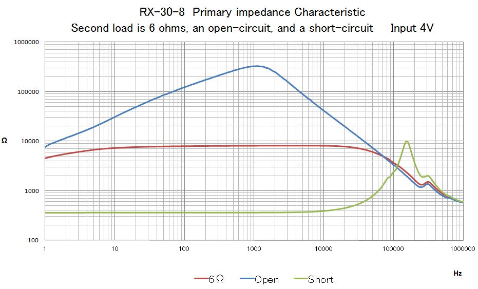

I think you will find that the limitations are significant. I've attached some measurements of a transformer shorted, resisitvely loaded, and open.
If you use a triode and load it with a transformer that is at least 3x Rp, then the changes in reflected impedance don't make much difference in terms of gain/frequency response, but as you have noticed THD will go down where the reflected load has gone up.
For the amp you have built, a resistor is not required across the output transformer terminals. The maximum possible voltage swing is well limited by the low mu of the triodes you are using.

audiowise,
1. Yes, I agree.
His triode amplifier in question will not arc over even if it is unterminated.
I listed it's approximate limits of peak plate voltage under normal drive conditions
(u x bias Voltage) + (B+ Voltage). See Post #6.
Only when driven with a fast rise generator, and only if the driver has a fast enough rise time and large enough voltage excursion, might the output tube and/or output transformer arc over.
But it can never happen when driven by a Redbook CD player (which are all bandwidth limited, and are all rise time limited).
2. Thanks for the graph!
That is a nice illustration of some transformer characteristics:
The open condition shows the resonance of the primary's inductance with the primary's distributed capacitance.
The shorted condition shows the resonance caused by the leakage reactance (non coupling of the primary to the secondary), resonating with the distributed capacitance.
I also noticed the curves all show a small additional effect from about 25kHz to 30kHz.

What was the model of the transformer you tested?
Question:
Did you ground one end of the secondary, relative to AC ground of one end of the primary, when you did the 3 tests?
Thanks for the picture anyway.
It really is good for some others to see.

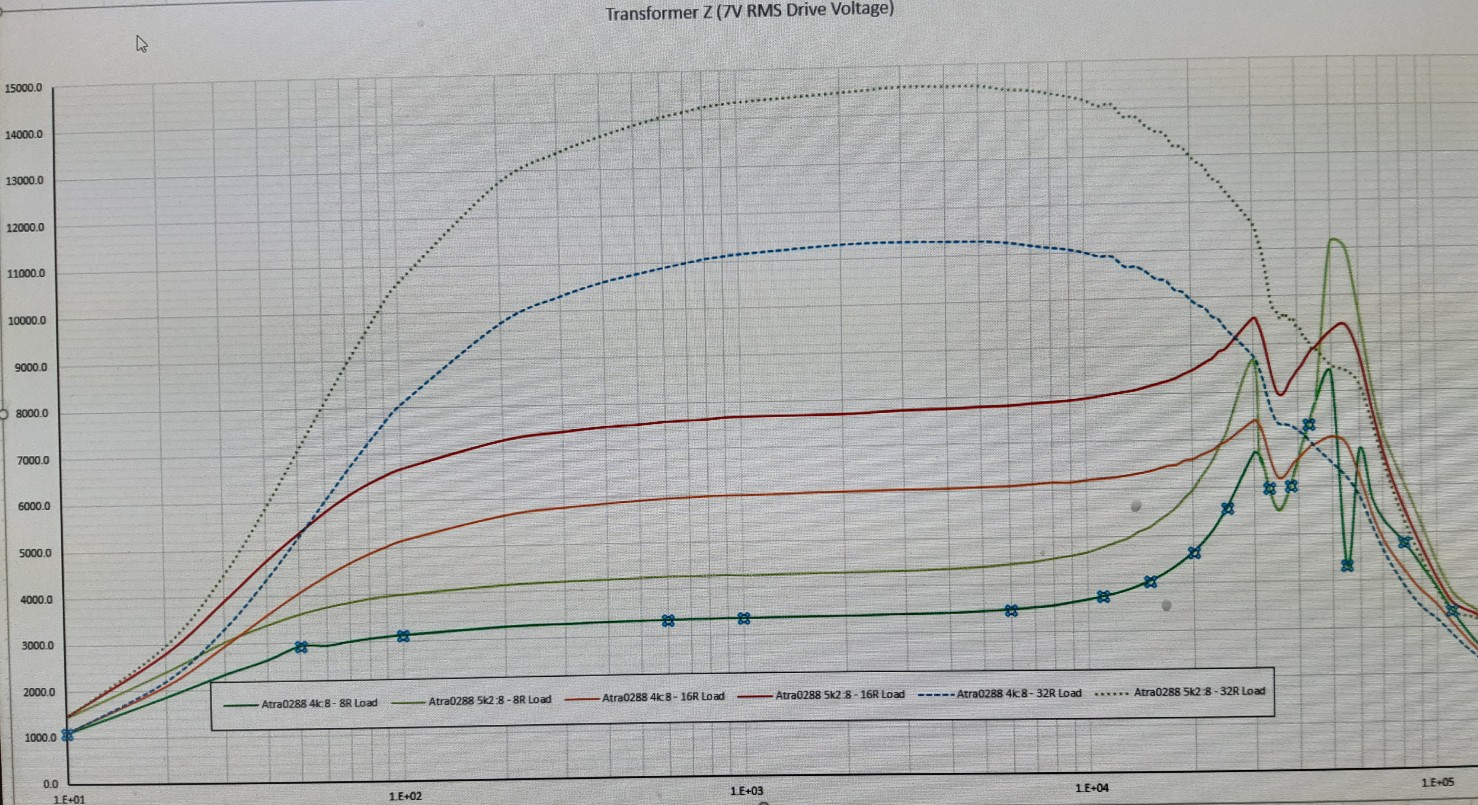

Thank you 6A3sUMMER, PRR, Mark Tillotson, and audiowize for your thorough responses.
Unfortunately I have been very busy at work and haven't had the time to go through them in detail, rest assured I will over the next few days. This forum has been invaluable for someone still new to DIY tube audio, very much appreciated.
I agree Audiowize posted graph is interesting and I've seen that around before.
Here attached is my own impedance investigation of a single ended OPT in my possession.
It shows the effect of loading the secondary with 1x, 2x and 4x the intended load. I didnt go as far as 10 times, as the restriction on frequency response is already very apparent.
