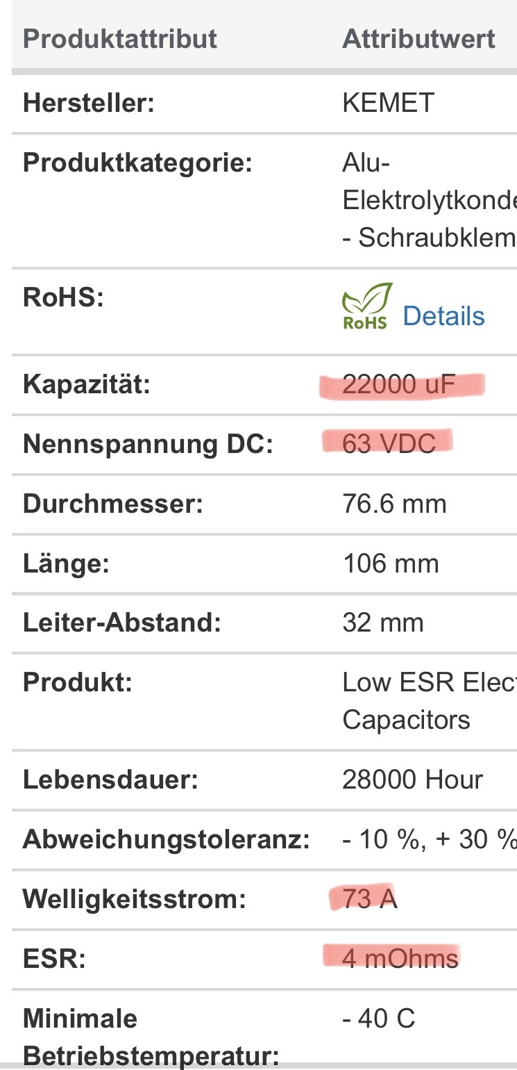

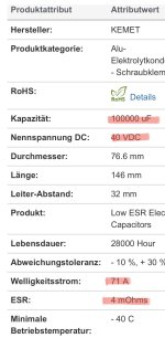

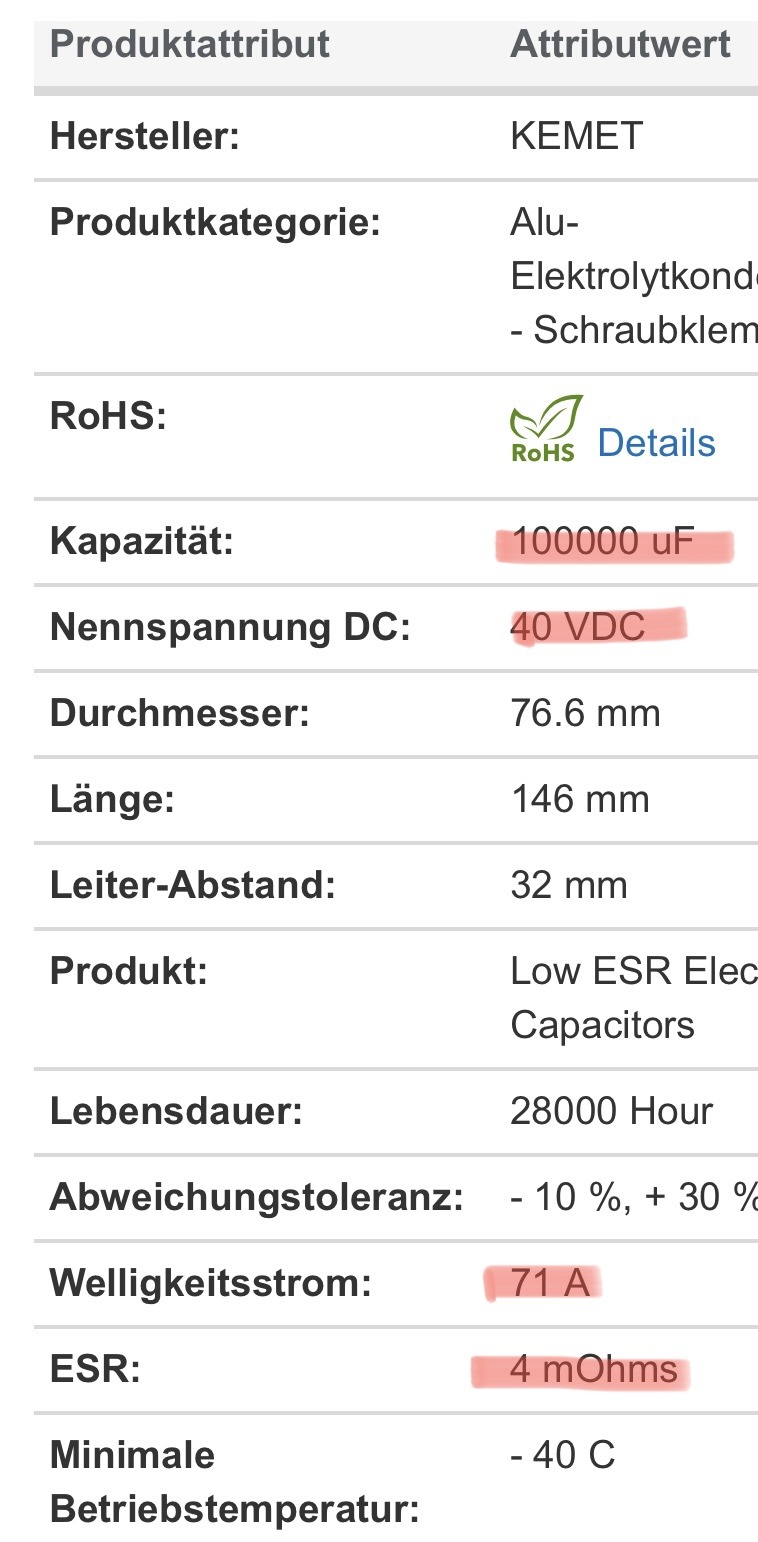

I am building a Power supply for my amplifier, intend to have +- 45Vdc, approx. 100000uF filter capacitance using KEMET PEH169 series capacitors. I have the choice of:
1) using 22000uF, 63V, ripple current = 73A, ESR 4mOhms capacitor x 4 = 88000uF
2) using 100000uF, 40V, ripple current = 71A, ESR 4mOhms capacitor x 8 = 200000uF (with every pair of capacitors connected in series)
Cost of solution 1 and 2 are about the same.
For solution 2, even though the effective capacitance is more than double, by connecting the capacitors in series would the ESR also doubled, hence ripple current became half too?
Could experts shed some lights on which solution is preferred?
Thank you

Esr limit max current, which capacitors can surge and output to load , when voltage from winding is lower and diode bridge is not conducting. If i'm understanding right, one type capacitor is for higher voltage, other type for lower, but same esr?
So then it's better to have higher voltage version in parralel, this will decrease esr and double allowed current for capacitor bank.
Also, series connected capacitors usually do not share the voltage equally, as expected in theory. However, for low current applications (e.g. SMPS front end), it is possible to use a pair of high value resistors to force the the voltage to split more or less equally, without much problem.
