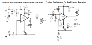

One tip is to look at the NS datasheet for the LM1875 chip, which is just an op-amp on steroids. You'll see two circuits, one for single-rail, one for dual-rail supplies.
With single-rail (page 2), a "virtual earth" is created at half supply voltage by the two equal resistors R1, R2 you note; it's added to the signal at the ingoing end and removed at the outgoing, allowing the signal to be magnified in-between, with the DC-blocking capacitors C1 & C6 preventing the high (half-supply) DC offset on the signal from leaving the amplifier at either end. Signal ground stays at earth (0V) potential throughout
Most op-amp basic circuits can be modified for single-rail use; there's a Texas Application Note SLOA058 giving examples.
