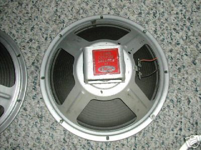

What I got: I found out it was indeed a conn caprice, and when I opened the back I got a nice little surprise: A Jensen special design magnet sticking out of a leslie unit!
I opened it up first, and found out it is a 1964 Jensen C8R. Took that home and popped it in my 6aq5 amp and it sounds GREAT!
Aside from that, I got two clevland 12 inch alnico woofers ( date code: 433441 = cleveland, 1964, 41st week.) I would like to make not that Rola ( owned at the time by Jensen) was made in Cleveland ohio, and that the baskets are identacle to each other. Were cleveland speakers made by Rola?

The speaker, I found a set from an earlier ( 1960-62 caprice 431) on ebay , they had a lable on them that said Cletron ( made by cleveland). Same things. Heres some pics:
