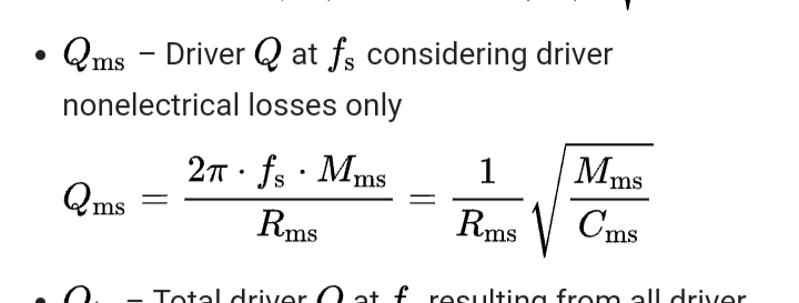

Rms is fundamental property, one of few in TS params, so needs to be measured from driver. If Dayton has Qms published you could derive it from that with Fs and Mms, as they had to have Rms while calculating Qms 😉

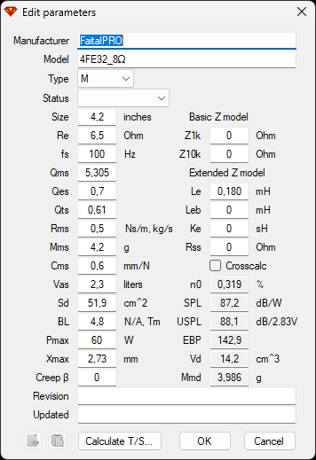

VituixCAD calculates missing values, just leave Rms to zero, or empty, and fill the rest, and it will calculate Rms for you automatic when you save the driver, assuming you've filled Fs and Mms and Qms in this case.
Image is screenshot from here:
https://en.m.wikipedia.org/wiki/Thiele/Small_parameters
Pressing Shift and clicking OK will calculate the missing parametersGreetings all,

Thank you everyone. I knew I could count on the diyAudio community! Shadowplay62's trick of holding down shift while clicking OK worked!
