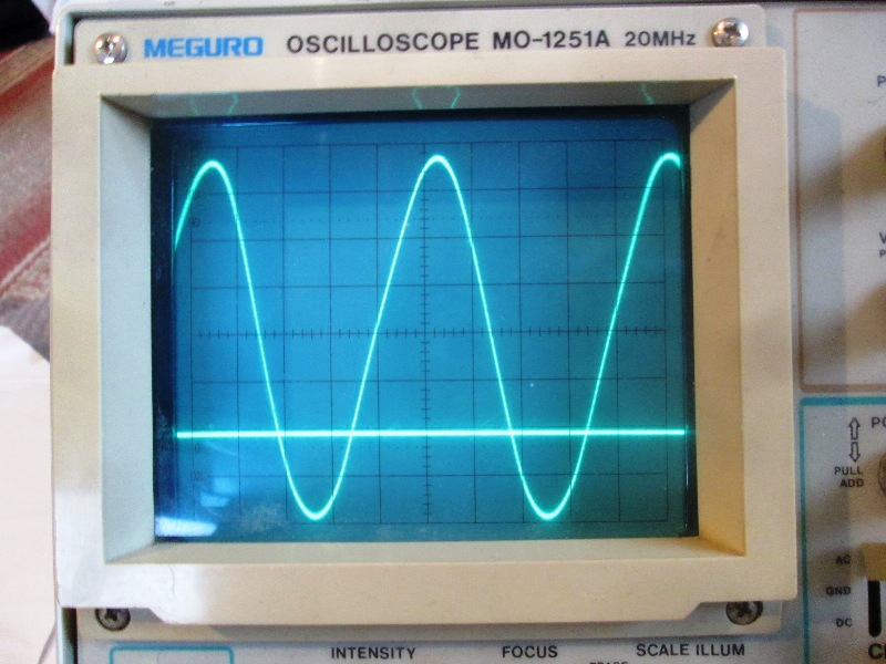

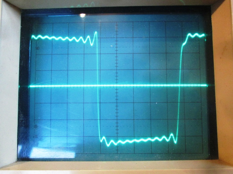

My 2 modified Bogen monobloc 8417 based amps are used daily, have much lower distortion than anything I have seen from Williamson and only use CFB, NO global NFB at all despite having dedicated OPT windings for it.

The output waveform of the H050 807 amps at full power leaves most DTN stuff in the dust, and this being at FULL power, not at a measly 15W where DTN's THD goes out of control, but at 50 where it was totally clean in AB2, so no nasty things happen approaching 0V on the grids.
I want to see any 70yr old amp make those kind of figures, never mind a Williamson.
