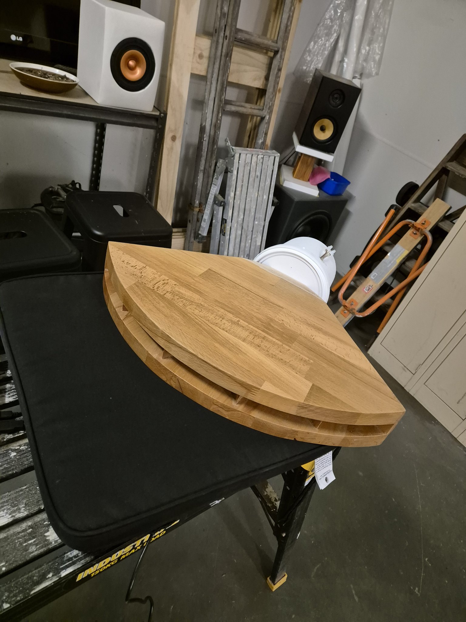

Basically a year or so ago I built some smith horns with left over 26mm laminated beech that I had from making bathroom vanities. Taken from plans on another forum and Adjusted to 5 cell and 90* horizontal pattern. I'm aware that diffraction horns have a mixed reception but they look cool af so that's where I started.

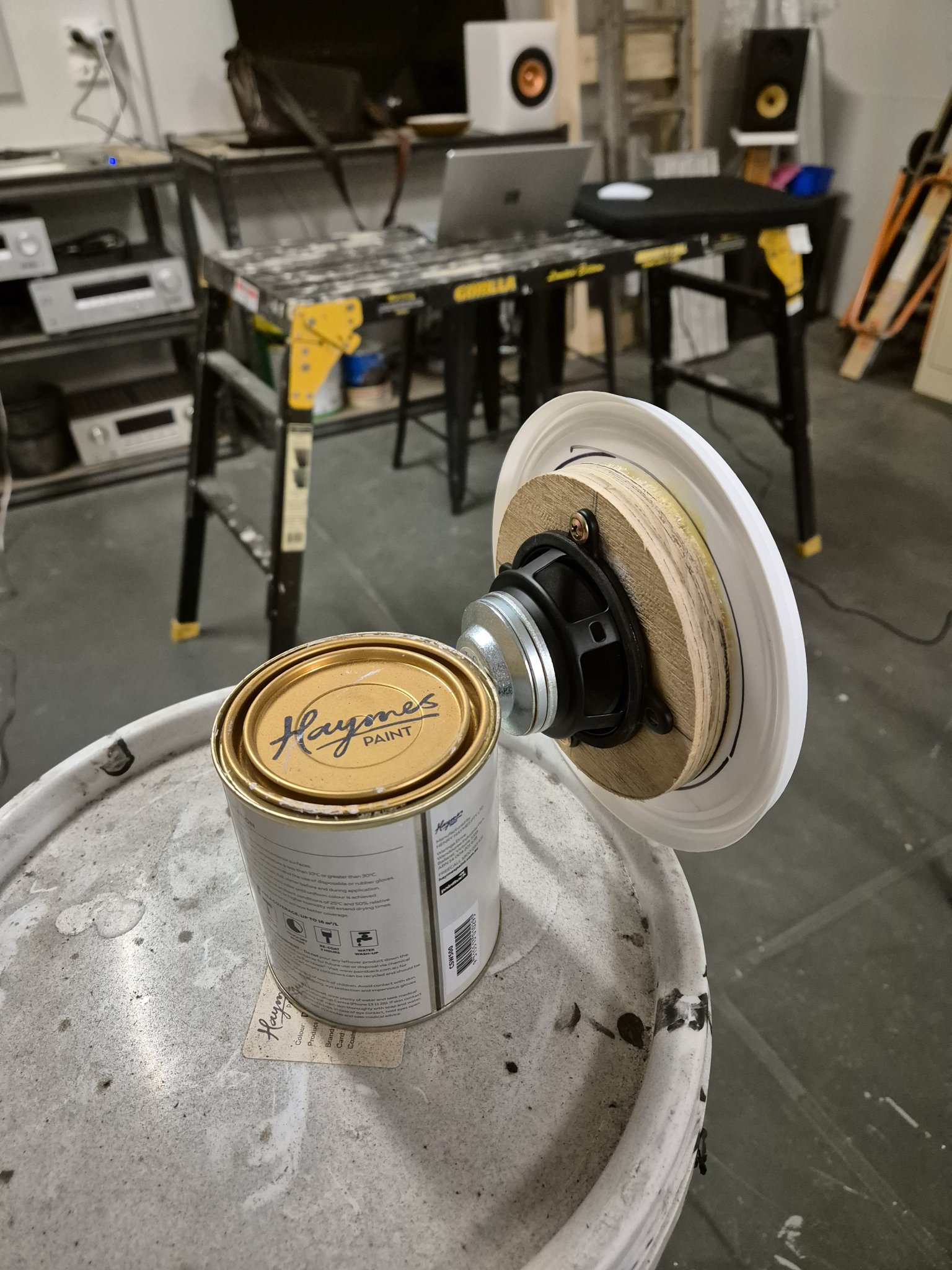

I have recently picked up some new in box faital pro 3fe22 8ohm drivers of Facebook marketplace for a very good price decided to give it a go in the smiths as I have some time at the moment to play with things- self employed, wife and 2 young kids......

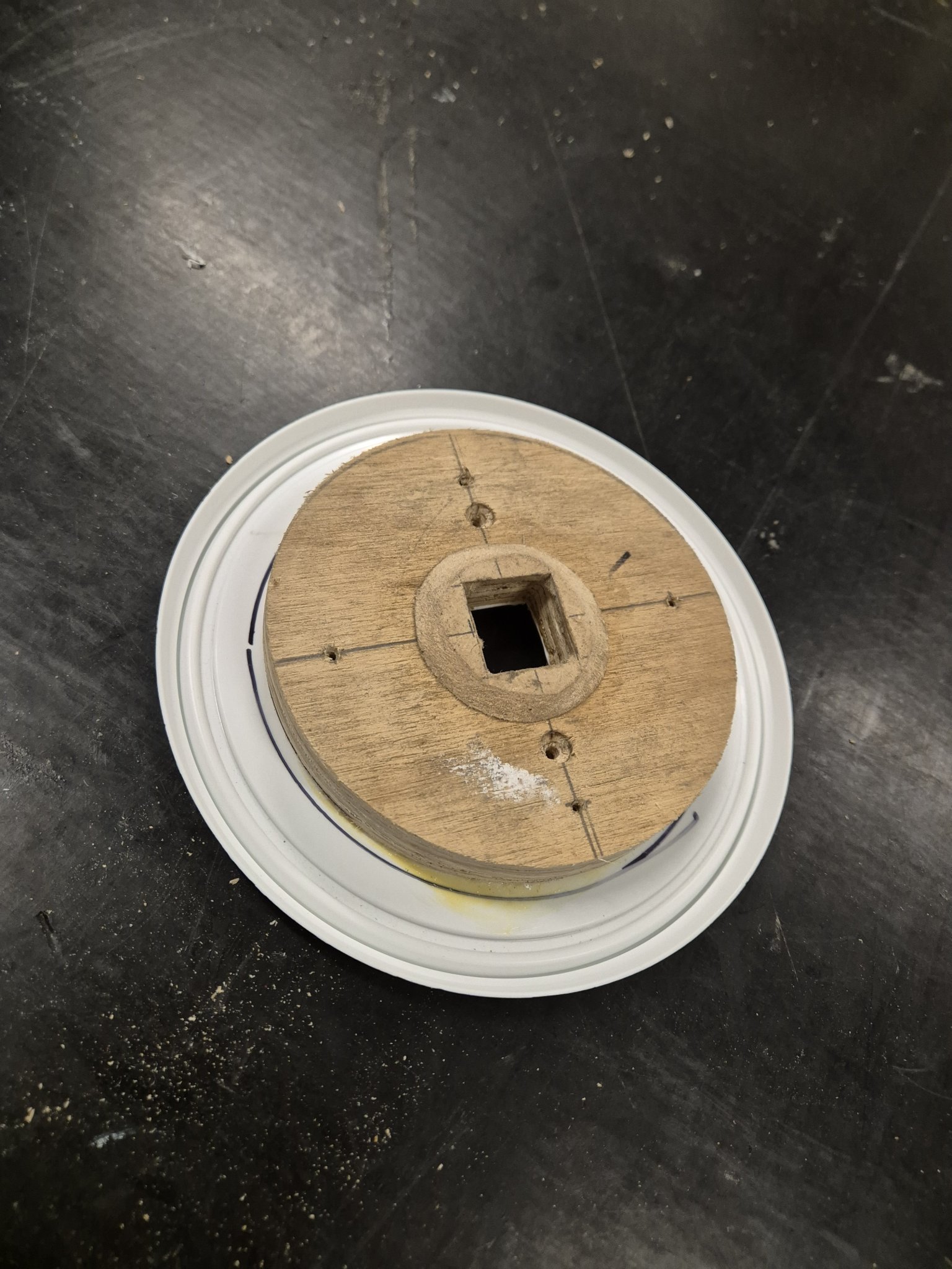

Started with a very rudimentary 2 litre airtight bucket filled with polystuff as the back chamber (obviously this is too big but just playing as a test of concept). Made a 15mm ply and 3mm mdf ring with a 25mm square hole for the entry to the horn- see attached (this is before file work to make it all neat and even so it looks pretty basic in the pic).
More to follow

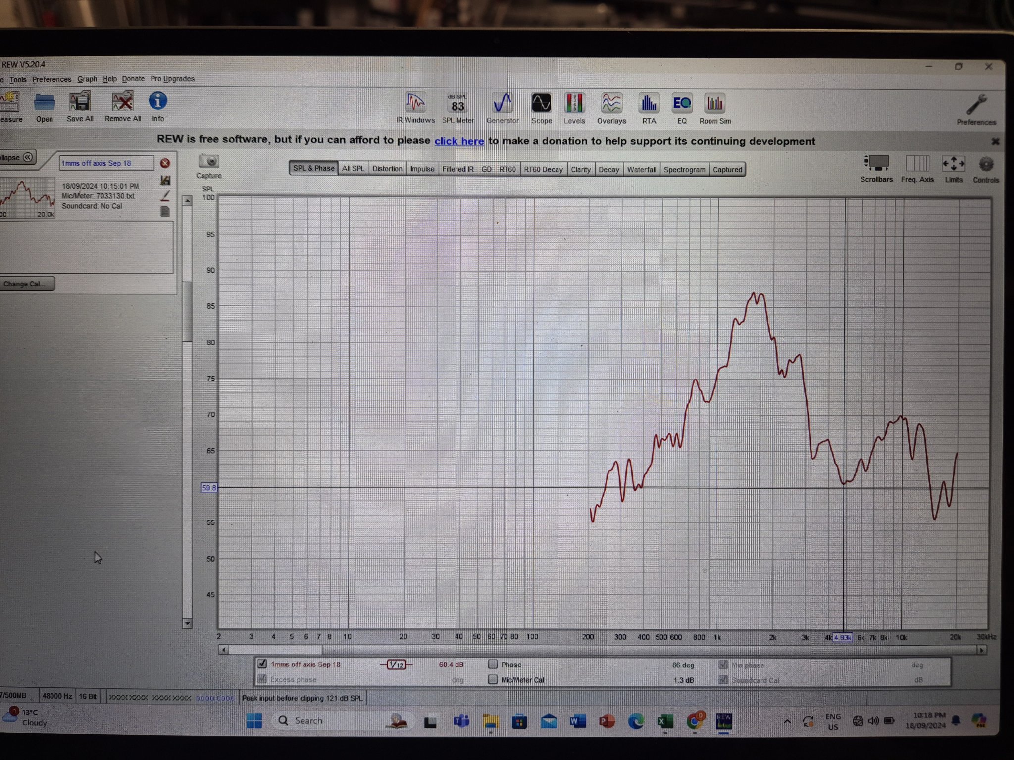

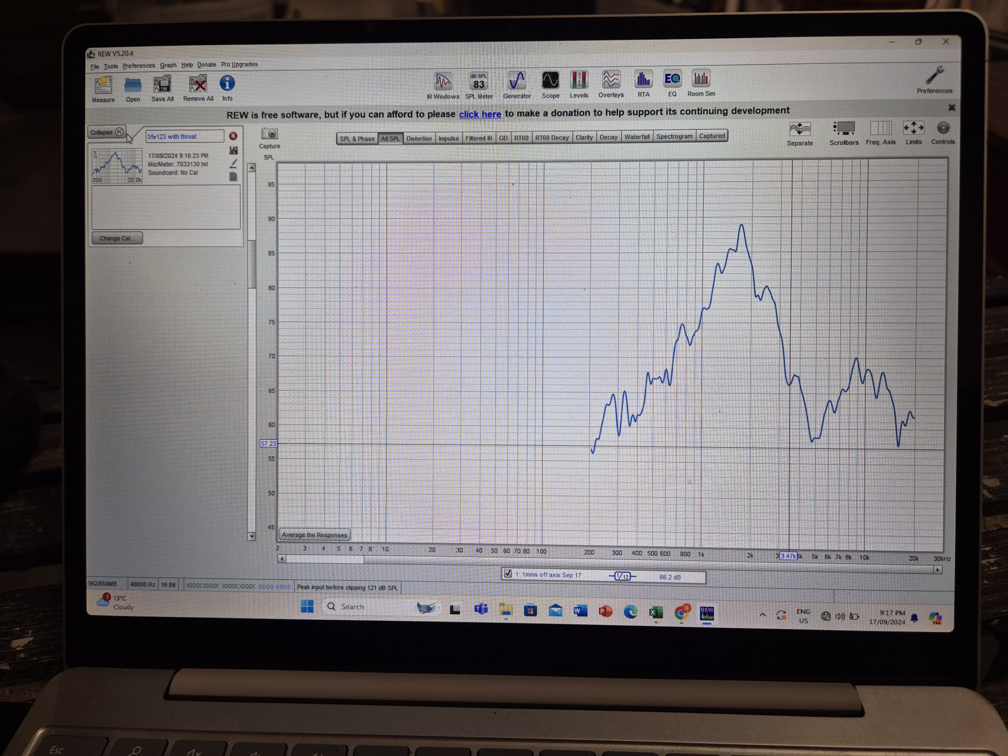

All connected up for some testing. And to run some sweeps.
Attached is the REW sweep, as you can see it looks pretty horrible! Measured at 1m gated at 4.4ms, First sweep with horn and driver, 2nd with just horn in its 'bucket' and no horn.
I'm assuming that it's the horn mouth as it enters the smith horn, hence why I measured without the horn but with the lense.
I wasn't expecting much tbh but this is God awful so I'm hoping for some advice on improving the >3k performance
I'll take any leads or experiences

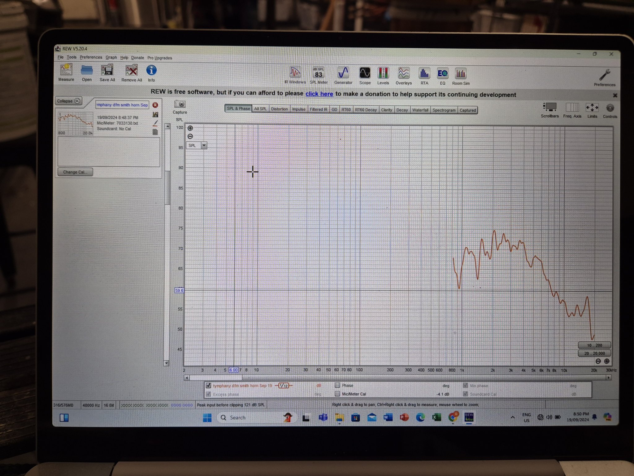

This is the horn 1m on axis with the driver and throat but no rear chamber or horn. I stuck the magnet to an old paint sample tin.

You should not expect much above 2-3 k from this - you could improve the low end by having a small back enclosure - I usually use 0.3 - 0.6 l on my MEHs. The volume in front of the driver together with the horn throat create a low pass filter.
You have adapted a driver with a 5 square inch Sd to a throat that should be under 1 square inch.
Even if you were to make a phase plug (very difficult with the cone profile and it's non-pistonic behaviour) to reduce the acoustic band pass effect, the driver has a relatively weak motor (only 4.5BL, compared to ~20 for compression drivers) so the high end will still be poor.
My advice would be to use a decent 1" exit high frequency compression driver on your Smith horn.

I will try a phase plug, I'm interested in how much of an improvement I can get from the current set up.
I actually have a pair of Tymphany DFM-2535R00-08 that I can use- however I was wanting to crossover to the smiths ~600ish and whilst I understand thats technically possible that seems to low to safely run a 1" compression driver in the large area I will play them.
Just made a very rudimentary phase plug as per the guide provided by cowanaudio.
Looks much better, still a lot of improvements to be had before I'm happy but goes to show what a difference a little bit of knowledge can do!
Attached is the before (same as yesterday) and then the after phase plug.
Still with no back chamber or horn Attached

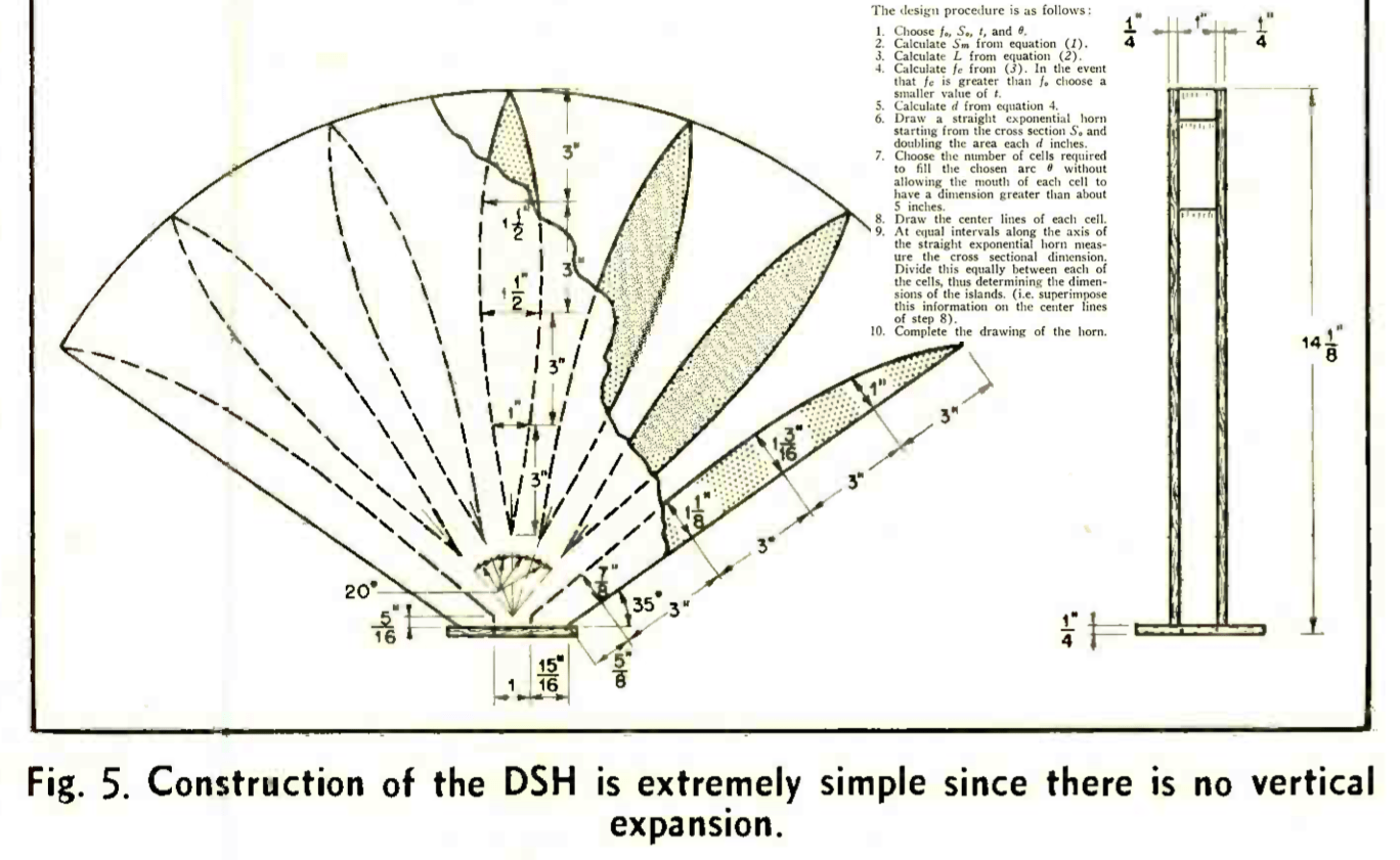

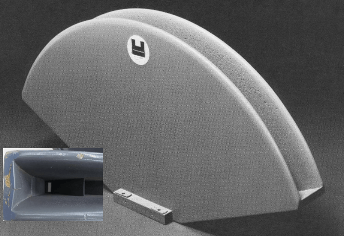

WozzaLee,
I forgot many people are copying a plan with a gross mistake.
The gross mistake is would explain the terrible response you have measured.
The "plug" in the design you copied should not be there, Smith's DSH horn, and all those made by JBL (and me 😉 ) have a clear shot from the driver throat entry to the exponential horn vanes, as can be seen in Bob Smith's January 1951 Audio Engineering article, "A Distributed Source Horn".
https://www.worldradiohistory.com/Archive-All-Audio/Archive-Audio/50s/Audio-1951-Jan.pdf
https://www.audioheritage.org/vbulletin/showthread.php?9148-DIY-500Hz-Smith-Horn-Please-help-me-design-one!&highlight=smith horn
As Steve Schell (R.I.P.) pointed out in 2006, " Note that Dr. Smith mentions that his design was to be used above 750Hz, even though it has an exponential flare constant of 375Hz...People are often confused by what looks like a rounded triangular section in the throat in the drawing. It is only there to show the angles of the "torpedo" dividers, not to indicate a solid structure."
Although the Smith D.S.H. primarily relies on diffraction for it's vertical expansion, it's high (and low) frequency response still would benefit from rounding the mouth exit, similar to JBL's 2397:
Have fun,
Art

WozzaLee,
The Smith horn is really pretty forgiving, if it's made correctly (as you say yours is) there really is no reason it should not be within +/- 6dB from ~750Hz to above 10kHz with a decent driver.
Beech is rather porous, if you have not sealed the throat vanes with varnish or paint, some high frequency absorption would be expected, but not near as much as posted. The vanes should be very sharp so as to not reflect sound waves back to the throat.
The on axis HF response should actually increase a bit in the HF.
That said, normally there is a center vane on axis, your five cell variant may have better response on axis to the vanes either side of center.

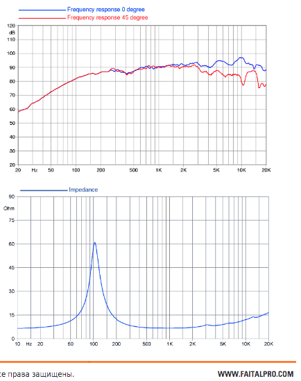

Before you give up on the Smiths, I'd still suggest you measure your front loaded 3fe22.
If it does not look similar on axis (within +/-3dB) to the factory curve above ~200Hz, something is probably wrong in your measurement set up.

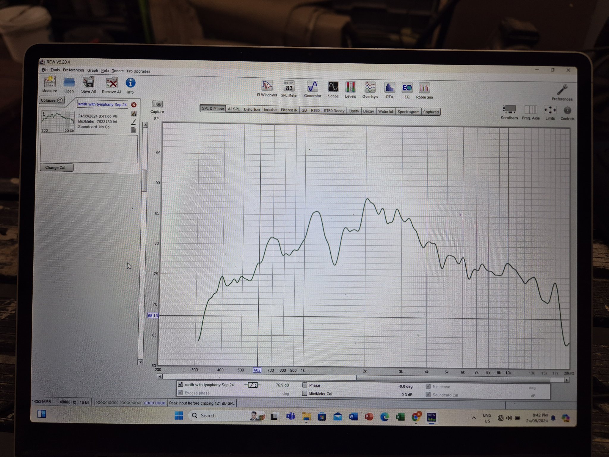

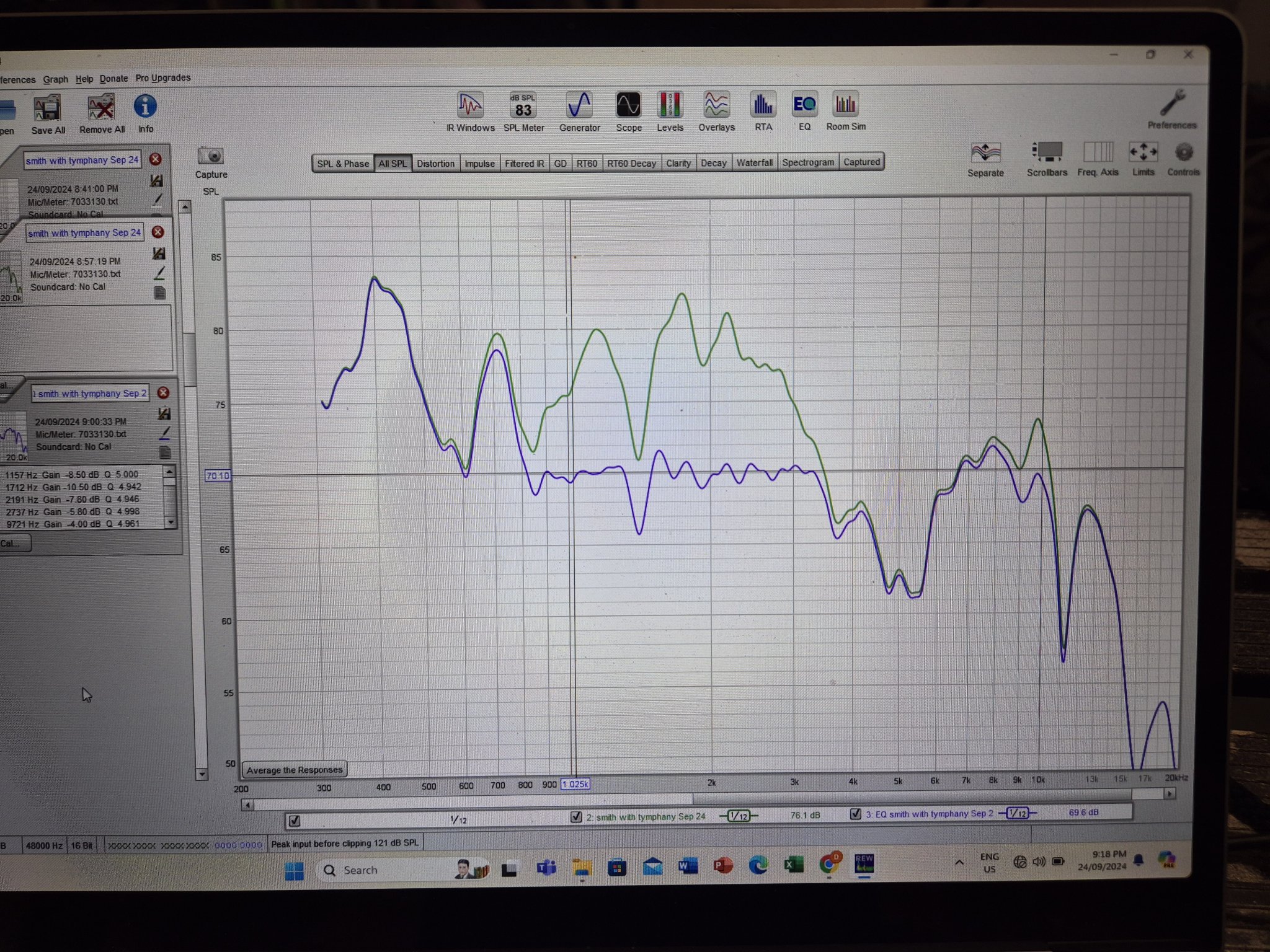

Righto,
Sorry been away for a little had a bit on at work and just doing bits and bobs as time permits.
After you posted that I had a light bulb moment where I realised that I haven't used REW since I got this new laptop.
And you were correct that there were some weird soundcard settings that were interfering a bit.
This is the tymphany on the smith measured at 50cm with 1/12 smoothing.
Still not setting the world on fire but a lot better. A bit of EQ and it could be usable

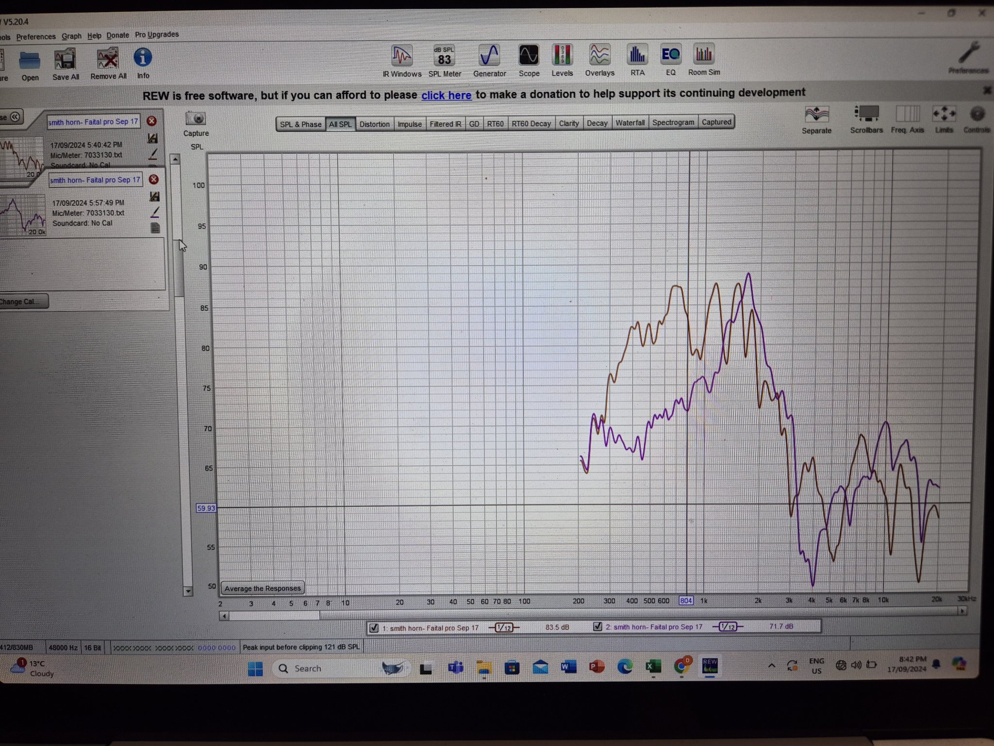

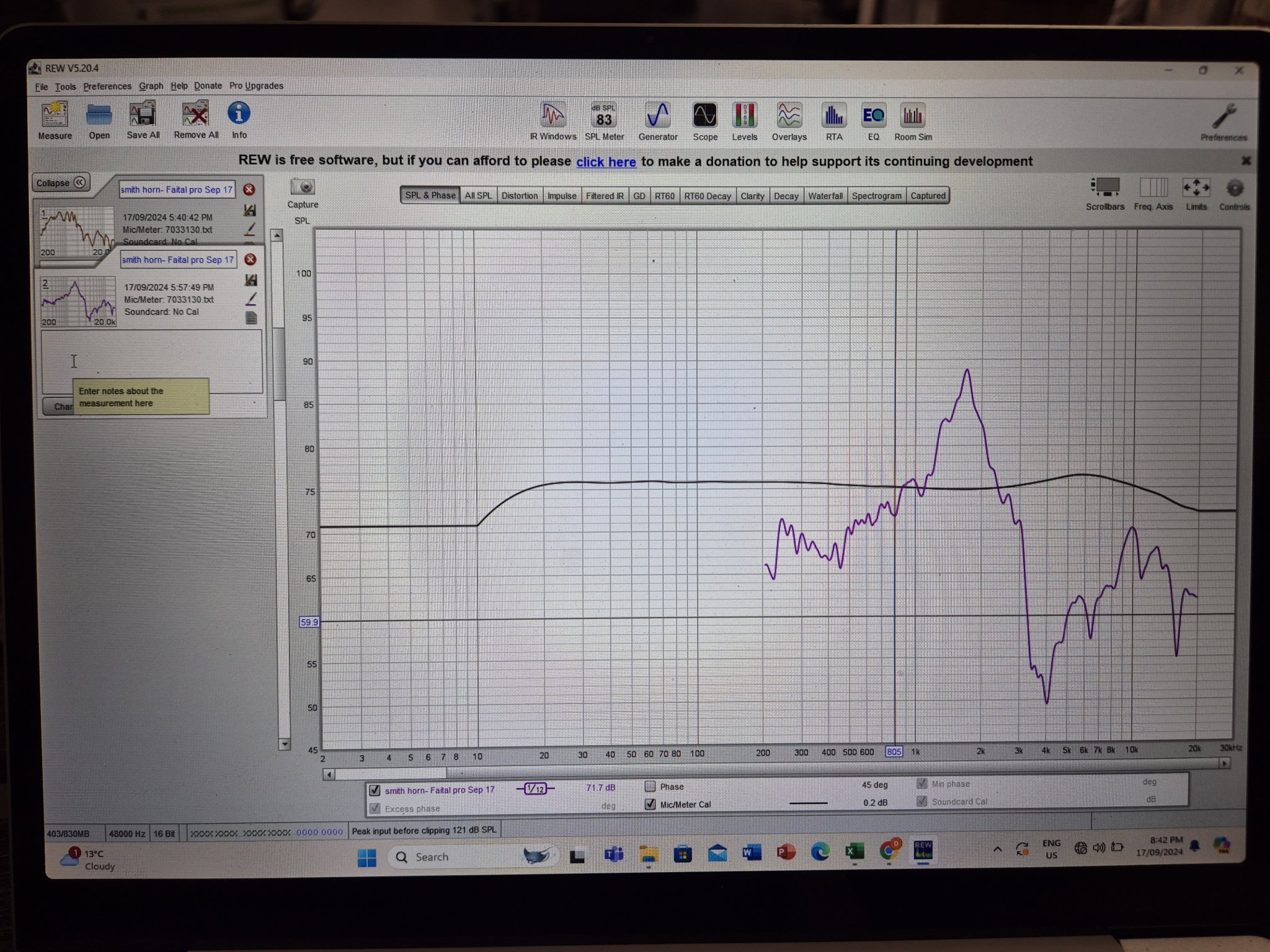

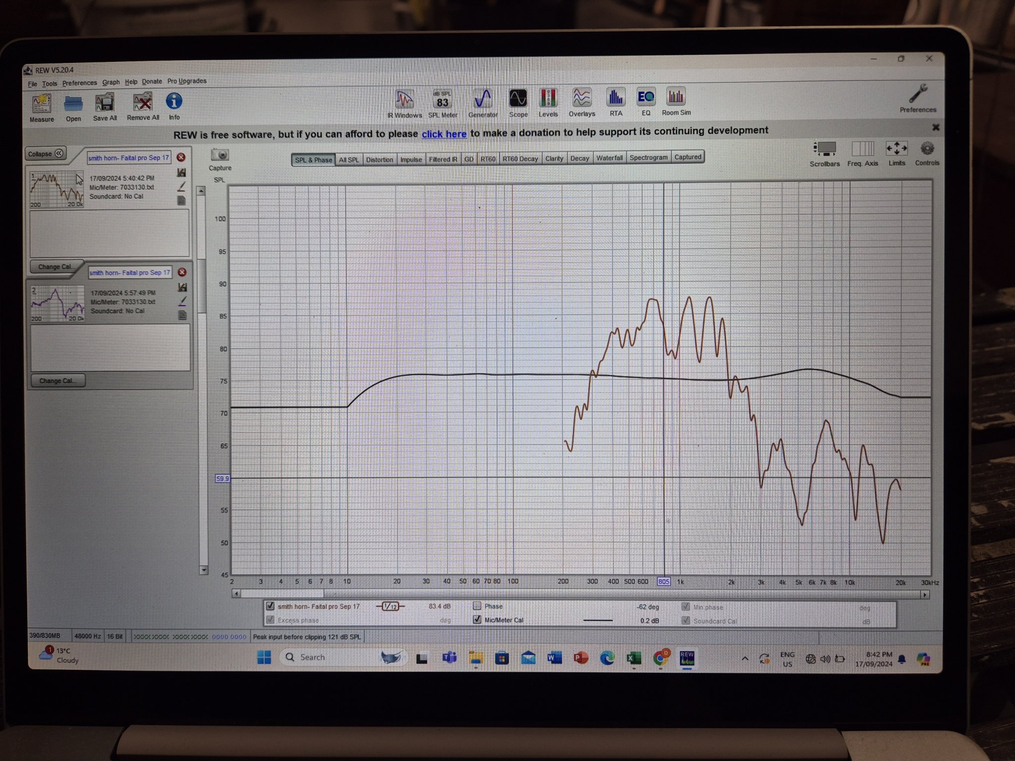

Also done some work on the throat mouth and phase plug and got some progress from the faital as well.
This is raw with same measuring as above. The purple line is REWs predicted response after a few cuts to even out.
Again not what I would normally accept however I'm interested to plug it in and see how it sounds with a 800ish xo just for giggles
