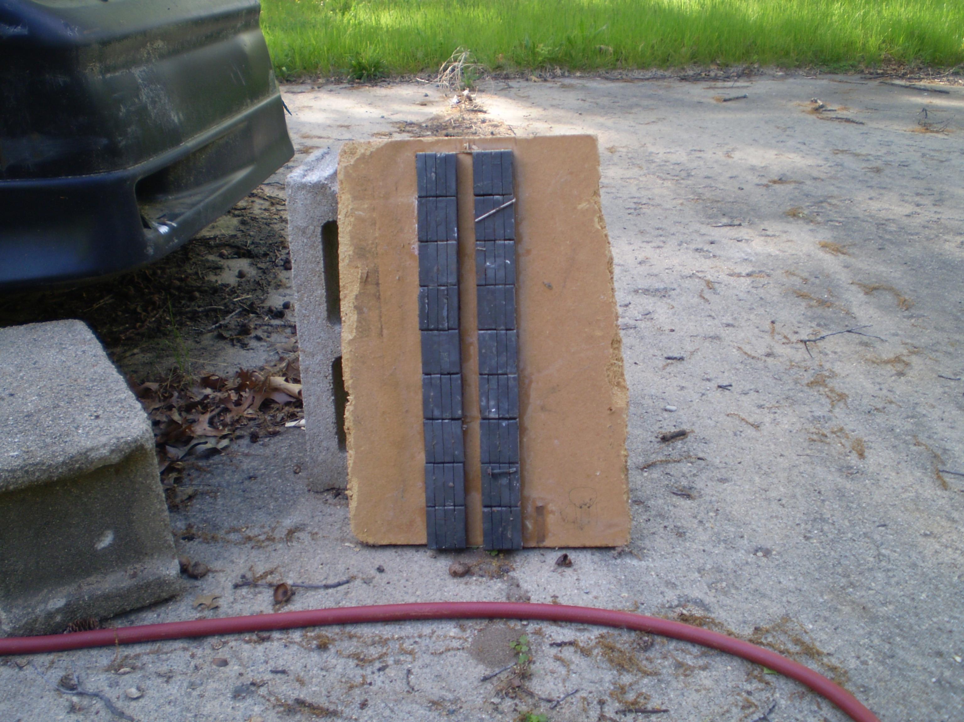

I too have some Metalized Mylar and I have found that an etching process will work but I haven't made diaphragm for a speaker using it yet.
My only concern with the material is that the aluminium coating is very very thin and doesn't handle very large amounts of current at all by some of the simple test I have done.
A headphone build may be a better choice using the stuff.
I still have the stuff and have been wanting to give it a real try but I don't have enough magnets too build even a small structure.
As all of the ones I have are already super glued together from my experiments in the 90's of the above description. 🙁
