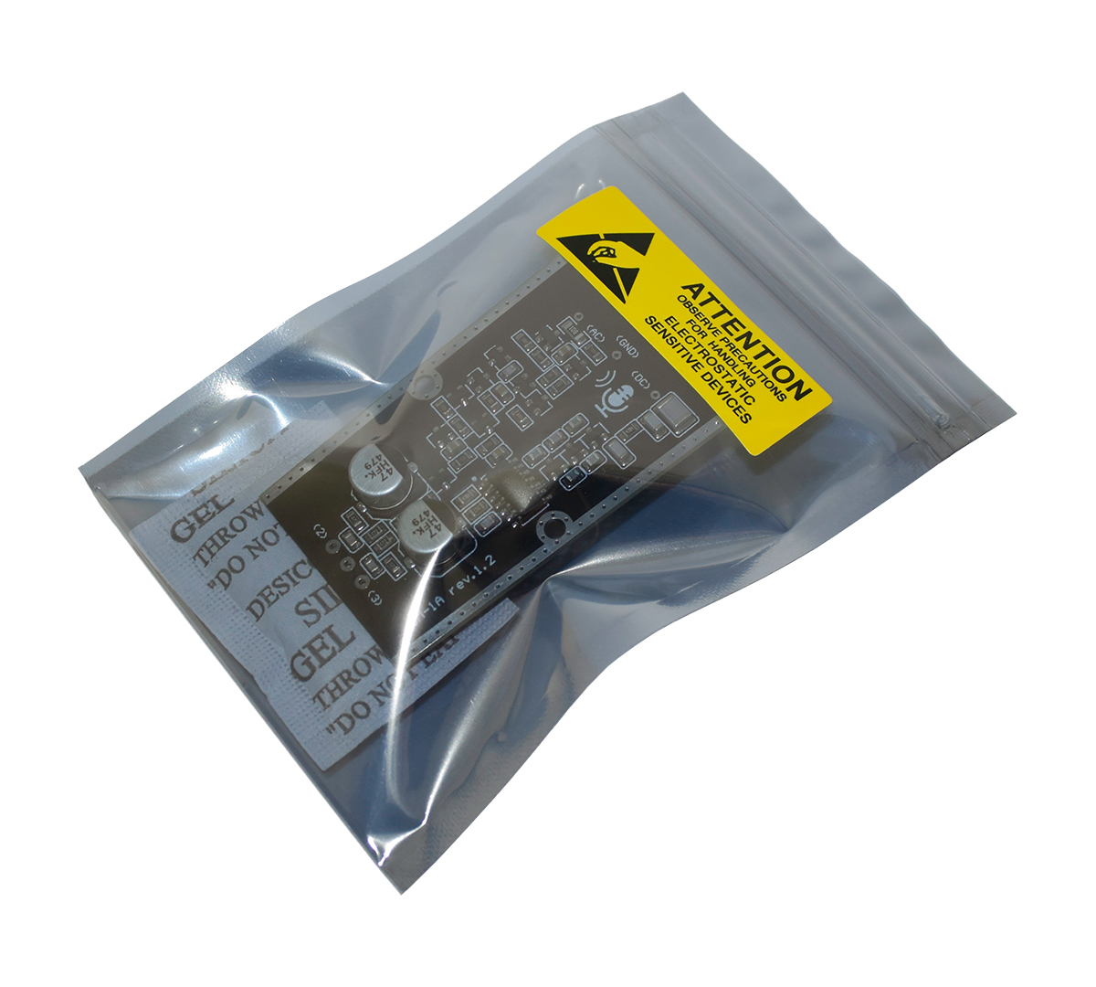

Condenser Microphone Amplifier Modules

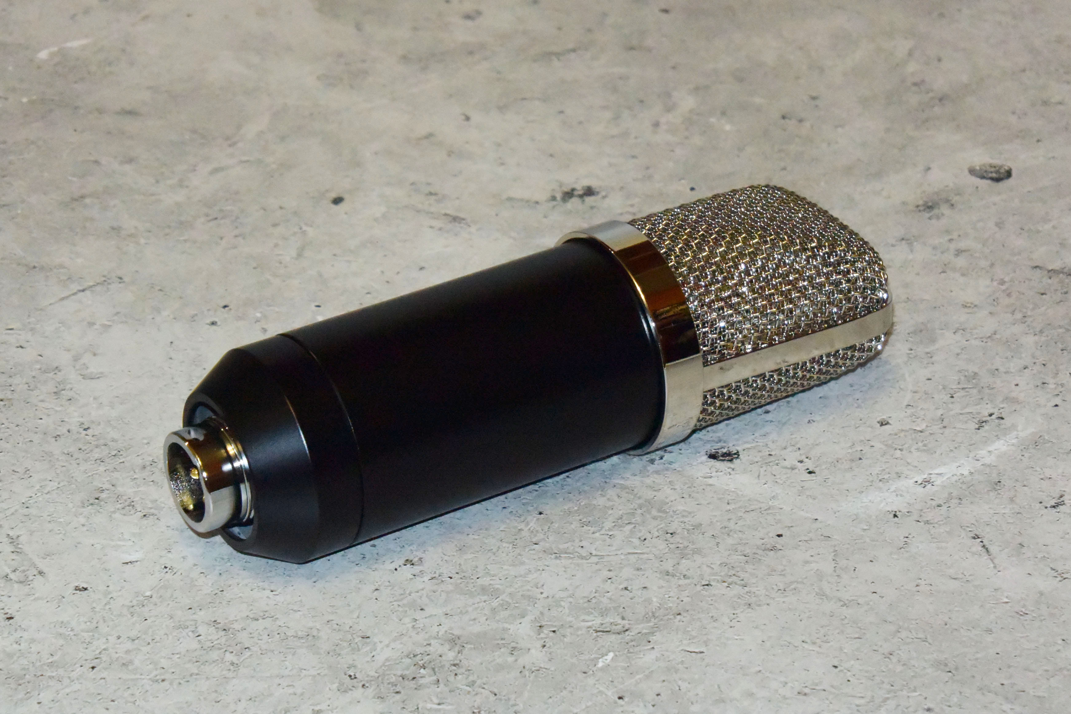

Assembled microphone with High lvl module (for example):
When I see surface mount electrolytics my skin starts to crawl. I've replaced more of those than most can
imagine. They are probably the most failure prone parts I have seen. Change those to organic polymer and
then you'll have something.
I have only replaced the occasional FET in condenser mics. But when I see failure prone caps used when they
don't have to be, I speak up. You don't like it as is your right. I did suggest a solution which you probably don't
like polymer caps as is also your right.
I've been repairing electronics over 50 years and have seen many things, some brilliant and some dumb.
stratus46, the ripple current of these capacitors is less than 3 mA. At this current, they will last for decades, just like polymer capacitors. But beyond that, electrolytic capacitors have the correct ESR for audio depending on the frequency.
This is not a question of what I like, this is the only correct solution.
