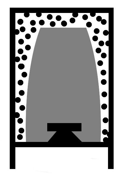

I think a very easy build would be something like this.

It wouldn't cost much to scale it up (subs need to be bigger or work harder for outdoor use). e.g. you should be able to get thick-walled 200 litre plastic drums for $15 each from recycling yards or food wholesalers (they are used for importing olives etc).
You could make a very solid structure by embedding the barrel in concrete, as pictured - and then put a tabletop on it.
