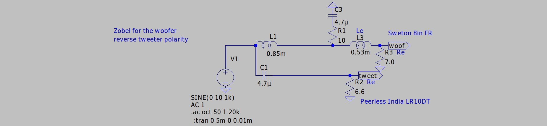

As an experiment for a 2 way, I tried fixing a tweeter in front of a full range, so both speakers are concentric. The speakers are:
  • Peerless India LR10DT, 1 inch dome tweeter
  • Philips 9710 clone 8 inch full range
  • Cabinet 21 L
Tweeter fixed concentric to the FR, with a 2 inch gap.
It sounds pretty good to my ears, as a point source with good frequency response. This speaker handles 100 Hz and above, with a 6dB crossover at 2200 Hz .
I use it as a nearfield, augmented by a subwoofer.
Thoughts?

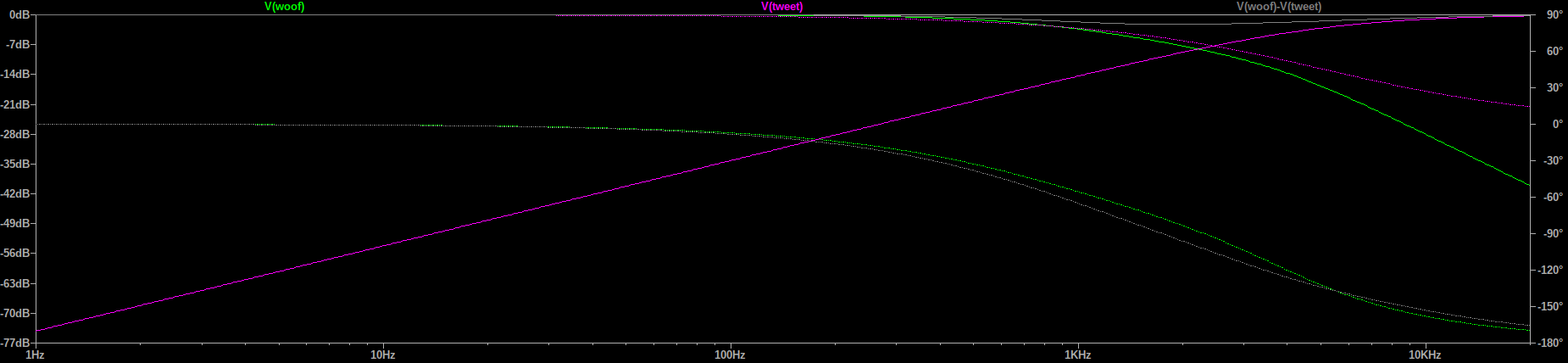

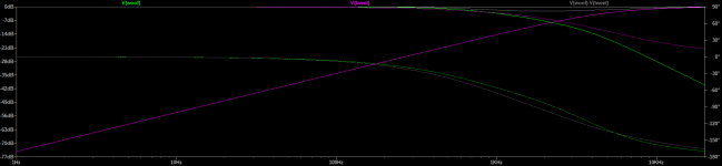

By the way, I'd watch that 1st-order crossover - remember that the tweeter excursion will still be doubling each octave below the crossover frequency (until its fundamental resonance - which hopefully is well damped).
I did not include any passive delay compensation,not sure if that's a thing even. I can only adjust the gap between the FR and the tweeter.
If there is excessive diffraction, or comb effects, won't I be able to discern by ear? I don't have any measuring instruments.
The tweeter Fs is listed as 1200 Hz, so I opted for a crossover of 2200 Hz. I don't play loud, so I think I should be OK?
Considering the tweeter geometry, is there an optimal gap between the FR and the tweeter?

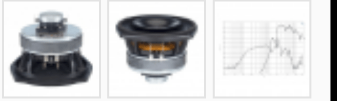

Long time ago i had vintage lafayette speakers, pseudo coax, like thread starter did, where tweeter was even on small baffle. I thought it would be detrimental, but they measured and sounded ok.

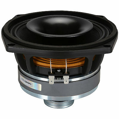

Btw, there was real coax recently, perhaps b&c?, where front of the cone was completely covered by the horn.

This kind of solutions, tweeter on front of a woofer, inevitably suffer some from the fact that the two need to play at same frequencies around some crossover frequency. The other will affect the others output being there as "non ideal" construction / obstruction. The tweeter will cause diffraction and reflections to the woofer output at frequencies where it is acoustically big. And the tweeter, even if low diffraction structure for itself, will radiate backwards to the woofer cone and reflect from there making interference. Either of these will happen or both, unless the tweeter structure was bigger than the woofer, or woofer smaller than the tweeter if you will. This sounds silly but can be made with big waveguide for the tweeter, like the B&C linked above but bigger, bigger than the woofer. Add some holes to the waveguide profile for the woofer to breath through, good roundovers for the waveguide to reduce diffraction. This kind of construct would also have an effect for response of both but perhaps less so or at some high frequency where it is not so audible perhaps. See Danley Sound Labs studio monitors for example.
Whether any of this matters too much is up to the particular construct and what the listener expects for the sound. Perhaps little diffraction doesn't matter too much when it is at very short distance mostly affecting past some kHz.
The interference for each others output could be minimized also by using small dome tweeter (without flange) as close to the woofer as possible, now we have the traditional HIFI coaxial construct like KEF's. Here the moving woofer cone acts as waveguide and will affect some to the tweeter response with increasing SPL as excursion increases.
