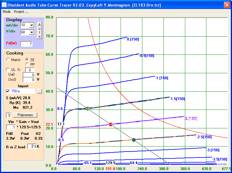

Look at:
Tube Curves Tracer
(Click on the blank frame to read more !)
I've improved the idea more than a lot since I've wrote that, added G2 control and more ...
And I can share Visual Basic more recent (dirty) source code ... at your own risks !
At present time, I'm able to do that:
Yves.
Consider using USB sound board as DAC and ADC, they work fine, precise and fast !
Look at:
Tube Curves Tracer
Yves.
Hi Yves,
Looks rather interesting. This might be a good solution for some of us as it stands. Any caveats you care to mention? In the grid supply can you provide details on the transformer?
Kevin

I started with an integated Sound Board because it costs nothing, all PC having one inside.Yves:
"Consider using USB sound board as DAC and ADC, they work fine, precise and fast !"
I agree, as long as you can get DC coupling from the sound card hardware. Many (most, if not all, actually) sound cards have AC coupling. But if the Op. Amp circuitry is accessible, one can modify it to handle DC. (have to be carefull when using that for audio purposes later though). Easy to find analog programmable power supplies around (or just build a DC coupled amp.) that could be controlled this way then.
Later I went to an external USB one because of so many different impementations of Windows Mixer along with unpredictable Output level and/or sensitivity among various manufacturer caused programming nightmare.
Your right about AC coupling, but it's an easy to solve this problem using "good old clamping methods" (as routinely used in pre-sand era for DC restoring video amplifier) here implemented by software ... and this kills -may be- DC drift issues.
This is made possible because the plate voltage is "pulsed" (in fact simply full wave rectified but not smoothed) and we know that the most negative value IS zero.
Of course, the program does not control the plate voltage, it just measures it simultaneously -using Left and Right stereo Inputs- with plate current.
It'is still a "work in progress", another hardware implementation -with embarqued TI's PCM2904 USB chip- being planned for next weeks ... stay tuned !
Software "add ons" are just limited by the imagination (and the lazyness) of the programmer (me) 🙂
